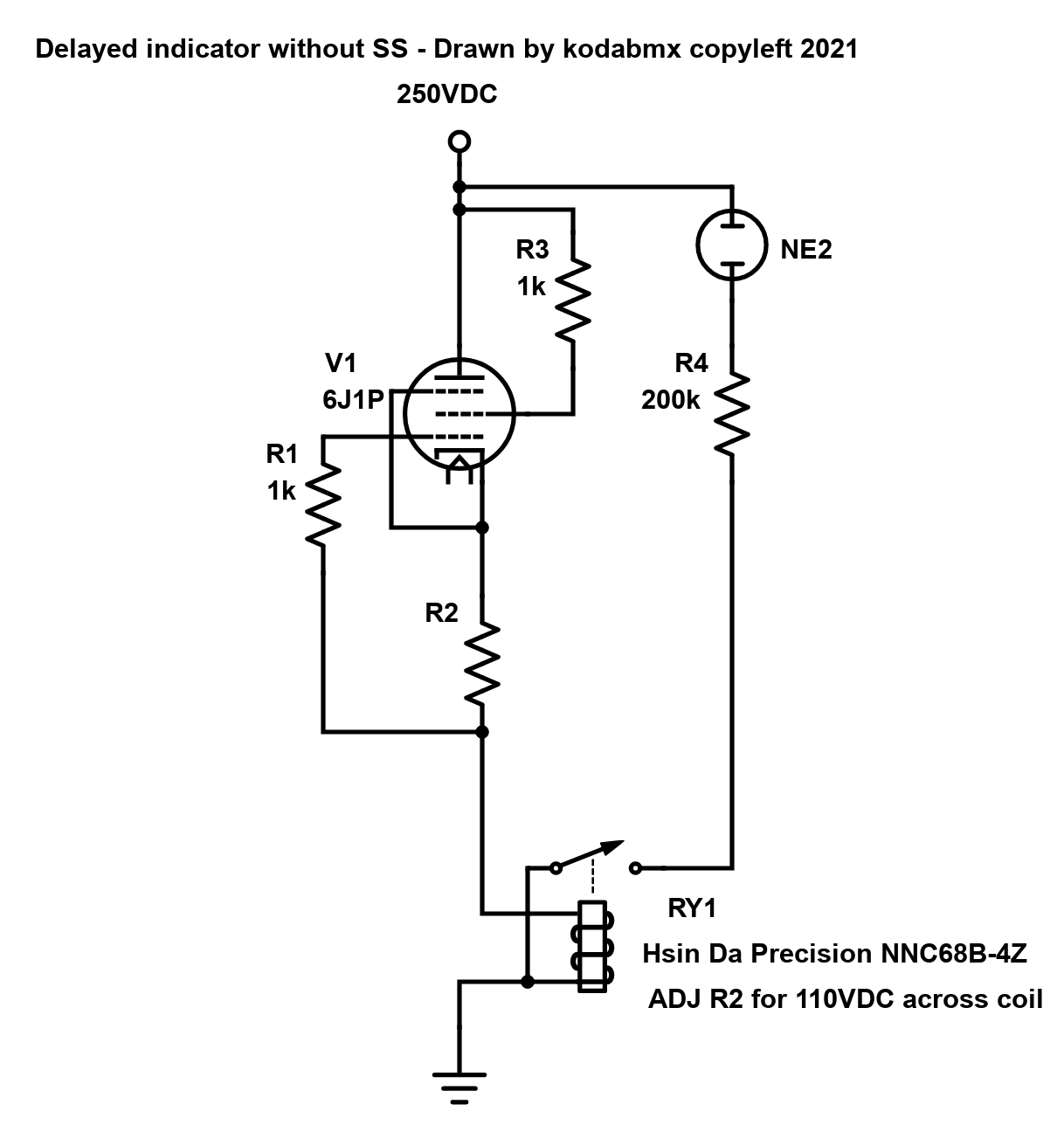

Realistically, this will work for you but the relay is out of stock right now @ LCSC. For a longer delay, use a tube that warms up slower, or starve the heater.

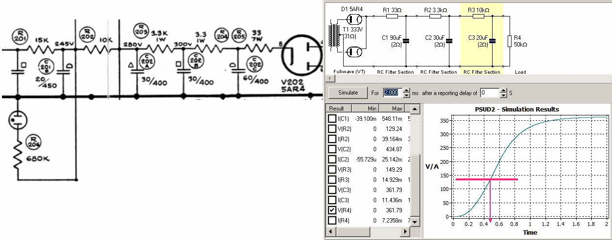

....neon bulb and resistor connected at the third resistor/capacitor filter. The idea being that there is some time before the final RC section charges up, and when it does, it conducts enough voltage to start the neon. Thus, when the neon bulb indicator lights up, the amp is also ready to start playing music.....
How much delay does the RC network add?
Counting on thumbs, I got "not a lot". So I asked the mechanical idiot to plot it. Seems to be around a half a second?
That's on top of the rectifier warm-up. The 5AR4 is heater-cathode and will take some time. But warm-up time is not specified, and there are other tube type which will fit in the same socket.
But you have one. Is it really playing at the moment that neon lights?
Yes, I in the amp I am in the process of designing now, a simple single-ended mono phonograph amplifier intended to be paired with an old Garrard record changer that came out of an old Harman Kardon solid-state tabletop FM receiver that I junked, I intend to use a 6CA4 rectifier tube (indirectly heated, separate filament and cathode pins on the socket). I think I have an idea of what it would potentially look like, adapted from the earlier Scott 200 schematic.
You will note that I am still using a relay to control the neon indicator, so that the bulb has sudden illumination action rather than a gradual increase in brightness.
Interesting, your use of the relay. As a practical matter, it may not be necessary. The "snap-on" of the neon bulb on my Scott happens in about 1.5 second at the most. In any event, I would put a small film capacitor .01 uf 600V) in line with a 100K resistor across the contacts, to quench any "arc" across the contacts, and to "speed up" the snap-on of the relay.

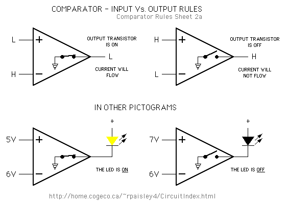

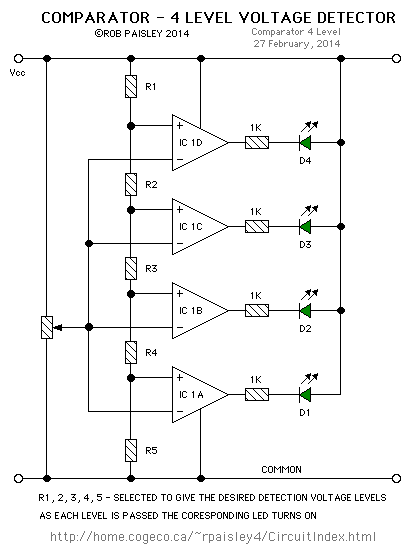

Ah! Then you could even do a 4 channel comparator that would "count down" as the voltage rose until all 4 lamps are off.

Seems not that difficult to make voltage divider to hit 1V when the B+ is ready. Use a NE555 for the blink. Even possible with optoisolating allowing the power button push and the state for the LEDs to be isolated.

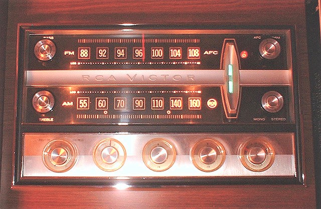

Ya know, my old 1963 RCA Victor console doesn't have anything being discussed here.
Ya pull the loudness knob out to turn it on.....
in a few seconds the tuning indicator glows, the neon stereo indicator lights up, and a few more seconds........ ya hear music!
It never needed any "delays" or dumb unneeded lights.
