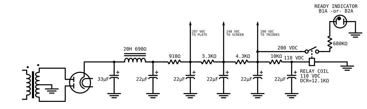

I found the schematic for the Scott 200 and I attach a screen shot of the power supply. The neon bulb and 680K current limiting resistor (R204) is across Section A of C201.
Very interesting. However, this circuit would suggest that the neon indicator is operating off of DC voltage, and the only neon indicators I can find on the Mouser website are AC rated. Will the circuit still work?
In any case, my initial thought with the relay circuit was for the light to suddenly turn off (or on), rather than gradually "ramp up" in brightness, which is what this circuit also suggests.

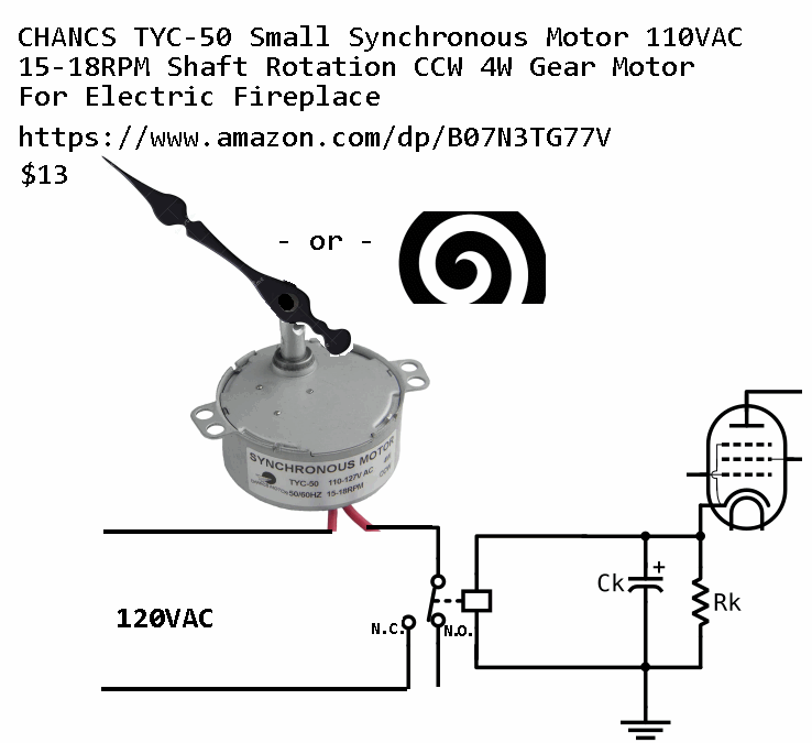

How about a simple timer? Use an RC time constant to have a tube conduct and light a neon lamp. They run fine from dc but only one electrode will light.

Neon bulb
Yes, in this implementation the neon bulb is working off of DC. But neon bulbs work off either AC or DC, so long as you meet the applicable turn-on voltage and "sustain" voltage (which is much lower than the turn-on voltage). Your typical NE-2 will work on either AC or DC. Here is an manufacturerʻs explanation of neon bulbs: Neon Lamps, Neon Indicator Lamps | ILT.

Always the polite guy, finding diplomatic ways to say things.Hence my design only works with cathode-biased output stages. Unless you can recommend an incandescent or neon indicator than I could use instead of an LED, your idea is useless to me.
.....most people these days are ordinarily accustomed to the instant start-up associated with solid state electronics.....
That's 20th century thinking. For at least the last 5 years NOTHING boots-up instantly. My PC takes 75 seconds to begin to take orders. My cellphone takes even longer. (True, I don't turn either off as often as I would a tube.) Even my battery electric saw and lawnmower do NOT start when I pull the trigger, there is a perceptable self-test delay.
The truly "period" boot indicator IS an electric clock unit. Of course I can't find one when I need one, but this type motion:
tells the kiddies "wait!"

As I have suggested indirectly, any "problem" was solved decades ago by the approach of using the neon indicator at the last stage of PS filtering. Why is it that a neon lamp and current limiting resistor is not acceptable; it certainly is the most inexpensive and least likely to fail solution. I thought that the purpose of engineering was to find the simplest and most elegant solution?
I didn't have anything against the neon bulb method. My initial thought that tying it to the rise in cathode voltage while a tube was warming up would be an accurate indication of the tubes being ready to play audio. At first I was skeptical to the neon-bulb method as it implies the need to "synchronize the RC" filter with the warm up cycle, but I am willing to try the neon bulb method...if I can find an appropriate SPICE model for one...
The amplifier is not going to operate until the last RC power supply section is charged up (assuming one is using an indirectly heated tube rectifier). So there is no real need for calculating the time it takes for the RC section to charge up to the striker voltage of the neon bulb. However if one is using a solid state B+ rectification system, then I would agree that the neon bulb approach is not going to work effectively unless one calculates the charge-up time for a special RC section that feeds only the neon bulb. Iʻm pretty sure that, in that case, the time constant is figured out using the standard RC equation.
Yes, I in the amp I am in the process of designing now, a simple single-ended mono phonograph amplifier intended to be paired with an old Garrard record changer that came out of an old Harman Kardon solid-state tabletop FM receiver that I junked, I intend to use a 6CA4 rectifier tube (indirectly heated, separate filament and cathode pins on the socket). I think I have an idea of what it would potentially look like, adapted from the earlier Scott 200 schematic.
You will note that I am still using a relay to control the neon indicator, so that the bulb has sudden illumination action rather than a gradual increase in brightness.
