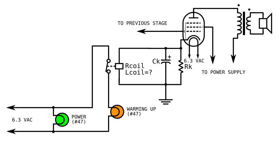

Realistically, this will work for you but the relay is out of stock right now @ LCSC. For a longer delay, use a tube that warms up slower, or starve the heater.
Yes, I in the amp I am in the process of designing now, a simple single-ended mono phonograph amplifier intended to be paired with an old Garrard record changer that came out of an old Harman Kardon solid-state tabletop FM receiver that I junked

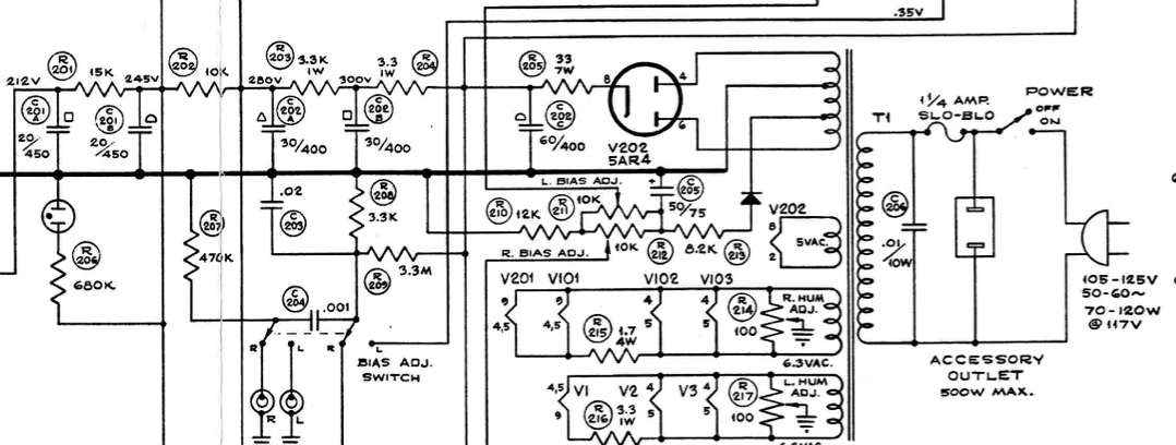

....neon bulb and resistor connected at the third resistor/capacitor filter. The idea being that there is some time before the final RC section charges up, and when it does, it conducts enough voltage to start the neon. Thus, when the neon bulb indicator lights up, the amp is also ready to start playing music.....
How much delay does the RC network add?
Counting on thumbs, I got "not a lot". So I asked the mechanical idiot to plot it. Seems to be around a half a second?
That's on top of the rectifier warm-up. The 5AR4 is heater-cathode and will take some time. But warm-up time is not specified, and there are other tube type which will fit in the same socket.
But you have one. Is it really playing at the moment that neon lights?

Yes, I in the amp I am in the process of designing now, a simple single-ended mono phonograph amplifier intended to be paired with an old Garrard record changer that came out of an old Harman Kardon solid-state tabletop FM receiver that I junked, I intend to use a 6CA4 rectifier tube (indirectly heated, separate filament and cathode pins on the socket). I think I have an idea of what it would potentially look like, adapted from the earlier Scott 200 schematic.
You will note that I am still using a relay to control the neon indicator, so that the bulb has sudden illumination action rather than a gradual increase in brightness.
Interesting, your use of the relay. As a practical matter, it may not be necessary. The "snap-on" of the neon bulb on my Scott happens in about 1.5 second at the most. In any event, I would put a small film capacitor .01 uf 600V) in line with a 100K resistor across the contacts, to quench any "arc" across the contacts, and to "speed up" the snap-on of the relay.

This is way overkill. My Scott 200 integrated tube amp has an indicator that uses a neon bulb and resistor connected at the third resistor/capacitor filter.
For an amp today, I would use two indicators: an AC power on indicator, and the neon indicator to show B+ at the final RC stage.
Heathkit did the same thing as the pilot light. A neon bulb and a 470K resister hooked to the B+ When it's on the B+ is up and ready
Yes, my Scott 200 only has the neon bulb as the pilot light. While it is acceptable, I do think from a safety standpoint it would have been good to have the AC pilot light.
NOTE: many tube equipment designs use a #47 6.3V incandescent bulb on the filament secondary winding as the pilot light. I do not like that design for two reasons: (i) it does not provide an absolute indication as to whether AC has been applied to the power supply; and (ii) the 6.3 v lamp is an additional load on the transformer, and many transformers are operating at or near their design limit (with greater heat generation on the windings.
For a new DIY build, I recommend using both an AC pilot light (wired in the AC switch circuit) so there is an absolute indication of AC being applied to the power supply(ies), and a B+ indicator using the neon bulb and resistor to show that B+ supply is active and the equipment is in a ready-to-operate state.
Some may also want a third indicator, if they also use an output delay relay to isolate the output so that no turn-on/turn-off thumps are passed on to the amplifier. The mute circuit PCB provided by Pete Millet has an option for such an indicator light. My old PS Audio IVH solid state preamp also had a circuit that blinked an LED during the time period while the preamp output was muted, and then went solid red on when the mute was defeated.
As a general matter, adding more indicators (annunciators) provides more information, but is one more thing to go wrong. It also adds cost. IMO, only the builder/user can determine what is best for the personal application.
