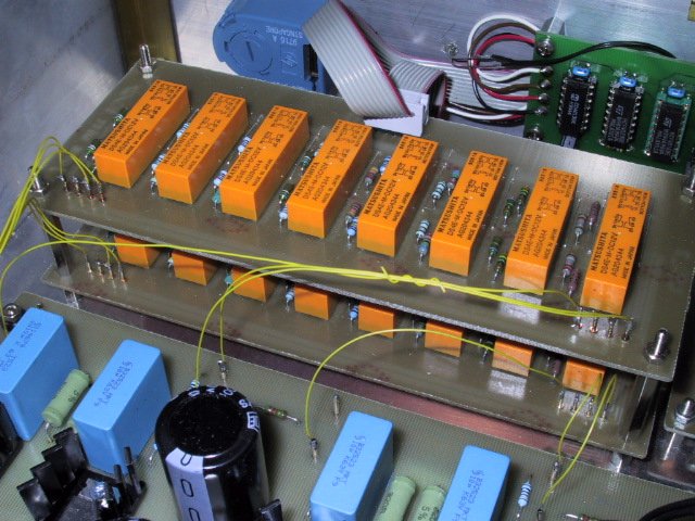

Jens said:Just a short inspiration about the attenuation in my “Balanced Zen Line Stage”![]()
Nice boards ! Are they already posted 😉
If not, could you ?
Grtz,
Nick

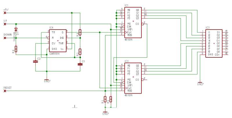

Hi, This is a rough sketch of what I had in mind. Being a novice when it comes to ic stuff, I would be happy to get some input one this one. The idea is that the 555 timer provides a counting pulse whenever a voltage is connected at either up or down. The count input is normally held low with a pull down resistor, and counts up only when a voltage is present.
So will this work?
I still have to figure out a way to display level, since volume will be set by buttons or a rotary giver and not a pot. I would like to use 7-segment displays but then I would have to figure out a simple way to do binary->bcd conversion.
So will this work?
Bernhard - I use in my Balanced Zen Line Stage (see above) voltage divider of 40db(MSB), 20db, 10db, 5db, 2.5db, 1.25db, 0.62db and 0.31db(LSB), which means we get nearly -80db control out of the 8-bit converter. BTW: 6-bit still delivers -76db with single steps of 1.25dB - Jens 😎
