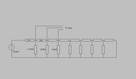

Pfff... i made some calculations.
The Pass P1.7 uses : Output_Line -> R1 - Out - R2 - Gnd.
8 relays swith 8 resistors parallel to R1 or R2 to create 254 different attenuator values from -48dB to -0.03dB.
Two steps are not allowed : 00000000 and 11111111.
Can someone confirm these findings and tell me if the -48dB step is enough for a close to mute setting ?
In Jens' volume control : does it switch different resistor combinations in every step ? Or does he also switch resistors parallel to another ???
until i'm sure that i understand these digital volume controllers i'll stay with two potties

Nick,
Just to clarify, my 8-bit counter starts at 00000000 (mute) and stops at 11111111, which are 256 steps. If you use the Aleph P1.7 ladder configuration, you will have a level control of about 48dB. My Aleph P1.7 clone has NP’s ladder configuration, and it works fine. In my BZLS I use the same 8-bit counter, but instead of a ladder configuration voltage divider of -40dB, -20dB, -10dB..., which allows for a volume control of about 80dB.

Nick,
Regarding the ladder configuration, have a look to the Aleph P1.7 schematic. In case of the voltage divider configuration in my BZLS, see appended file. As you can see, voltage dividers are completely out of the volume control (via relays) so long as they are not needed.
