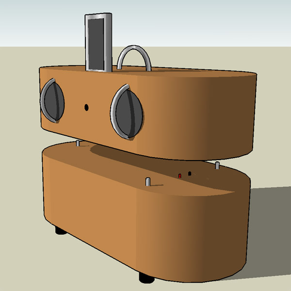

I thought I would just throw this out for all you IPod junkies, who want that ultimate boom-box to go along with it. Try Thodio: Exquisite Wooden iPod Docks
Is this what you had in mind? 😀 😉
GuyPanico said:
Here's a basic and quick model of what i'm planning. I'm going to use cabinet door handles like these to give some protection to the speakers. And use the 128mm version of it for the carrying handle.
I thought about building exactly this sort of thing, but how are you going to handle the crossover?

I doing something along these lines, but for a different purpose. My full rangers are in the top portion of the enclosure, and the subwoofer is in an independant (although passive) enclosure below. My hopes are that I can simply place the boombox on top of the subwoofer, fasten the two latches be on my way. I'm using bananna plugs for power and a few dowels to get perfect alignment when the two mate together. This gives me the option of having a much smaller and easily transported device.
These will be disassembled and flush mounted on the bottom of the boombox. http://www.partsexpress.com/pe/showdetl.cfm?&Partnumber=260-301
This will be mounted on the top of the subwoofer enclosure. http://www.partsexpress.com/pe/showdetl.cfm?&Partnumber=090-460
Then a pair of these draw latches to hold the two together. http://www.partsexpress.com/pe/showdetl.cfm?&Partnumber=262-210 I think two should be plenty.
I like your idea of being able to seperate the speakers. That gets it another step closer to home hifi quality sound!

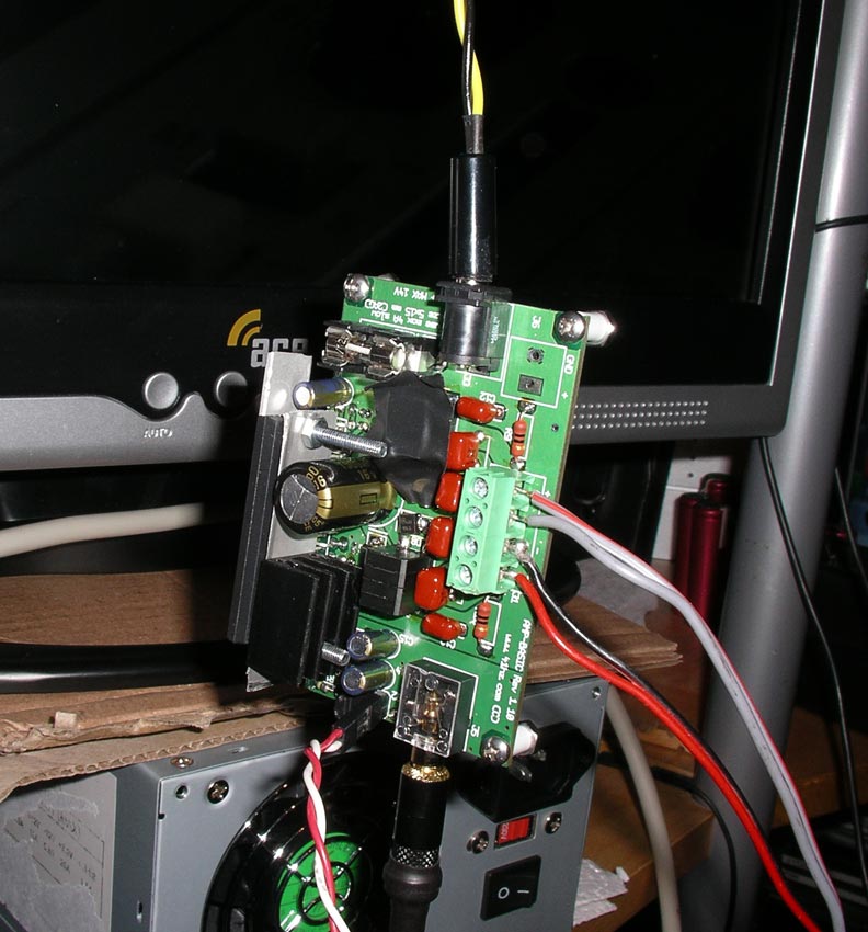

My shure electronics amp arrived and I think it's going to work perfectly. I tried a single B3N speaker on one channel and it played quite loud. Since the drivers i'll actually be using are 6dB more efficient, and i'm using 4 of them in a 4ohm configuration, it should be very loud.
I'll start construction pretty soon!
Slight change of plan... I'm rebuilding my battery packs to 11.1v and going for the amp6 basic. 🙂 AMP9 is now in the car.
This is much easier, as the amp6 shuts off below 9v, so it won't kill my unprotected cells if I leave it on (in theory).
For XO's, look into using op-amps for an active crossover. Cheap, and should give good sound as well.
I'm gonna get back to it now, I'll have something worth photographing at some point! 🙂
EDIT: AMP6 is burning in 😀
