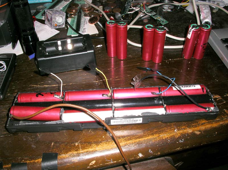

Anyway, back on topic, I managed to get you a pic of some 18650 Li-ion cells and a laptop battery pack that has just been ripped open :devilr: The flash screwed up the exposure a bit tho... 🙁
EDIT: The black thing of the left is a DSD charger - it will charge cells at about 800ma when combines with a Nokia ACP-12x mobile phone charger. 🙂
I plan to use 3 x DSD chargers... I charge cells 1,3,5, then when they are fully charged, I charge cells 2,4,6.
I keep meaning to make a multi-core cable to make this quicker to do, or get some sort of pack charger. 🙂
