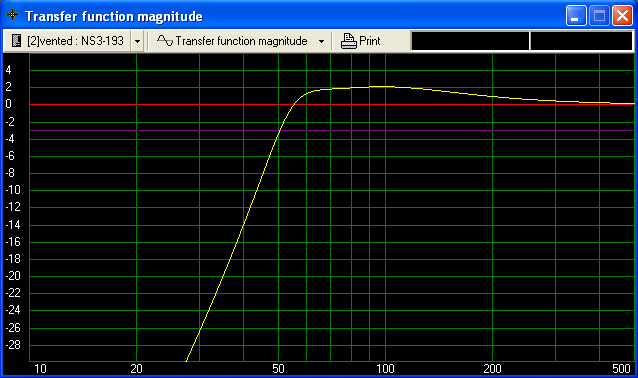

I forgot to include this plot in my original post...

I designed a bass reflex enclosure, the two drivers would be braced with a threaded rod, port in the front...
16.8 liters for each pair, tuned to 62 hz, F3 is 72hz.
That plot is for one driver. As you can see it would be good with about 8-10 watts for each pair, won't be very loud, but loud enough I think, with little power requirements (could be powered my an AMP3 for example). Its not perfectly flat, but I wanted as much extension as possible 🙂 Ignore the second half of the graph, bass box pro is not a good estimator of the higher octaves...
It would need a high pass filter to avoid over excursion down low unfortunately..
Make the box tuning to Q=1. Trust me on this. It'll protect the speakers better against over excursion at low frequencies and work better outdoors as well as indoors. F3 will be slightly higher though.
