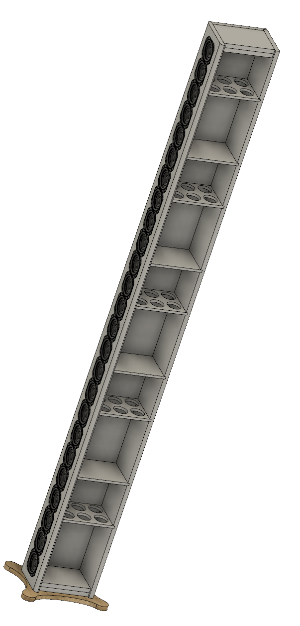

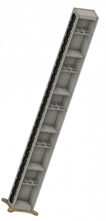

I would build the cabinet out of 3/4" ply to fit in the corner where your drywall layer is shown as you can still fix the front baffle in the same way to the actual cabinet.
Use enough bracing across the baffle and the cabinet to make it stiff enough. I designed in 9, 9mm braces across whole cross section dadoed into the sides and back. You could use 1/2" ply and screw through the cabinet sides to fix it. Just thin it out near the front or make cutouts to let the drivers fit through.
I would mount the cabinet to the wall by sinking tee nuts or other means into the plywood behind the drywall so that you can use bolts to secure it to the wall. Use as many as you need for it to be secure. Put a neoprene strip in between to provide some isolation and help to seal the cabinet from leaks.
By doing this way it will only be roughly 1.5" wider that if you screw the baffle direct to the wall.

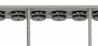

Independent of separate enclosure or part of the wall, I took the rigidity of the cabinet to heart. Here's an idea for bracing (dimensions approximate).
I could do one between every driver at the expense of either less volume or a larger cabinet. Maybe one every two would be a good compromise but I'm leaning towards one per driver. Also, if I build to the wall, I can use pocket screws to secure directly to the wall vs the foam tape to seal and relying on the screws from the baffles to keep everything tight. I might need to go to 3/4" thick in that case to have enough material for the pocket screws to work well. Alternatively, I could try to biscuit and glue them in but that's an assembly nightmare. If I build a standalone cabinet, I would likely just dado and glue (and the dowels wouldn't necessary at all then.)
Question... do you think it makes more sense to space them between drivers or directly behind the center of the drivers? I'm leaning towards between the drivers as that could reduce the size of the circular cutout for a stronger brace. Also, would it make sense to offset the drivers to one side? Not sure if baffle step compensation concepts apply for this situation directly, but thought it was worth asking.

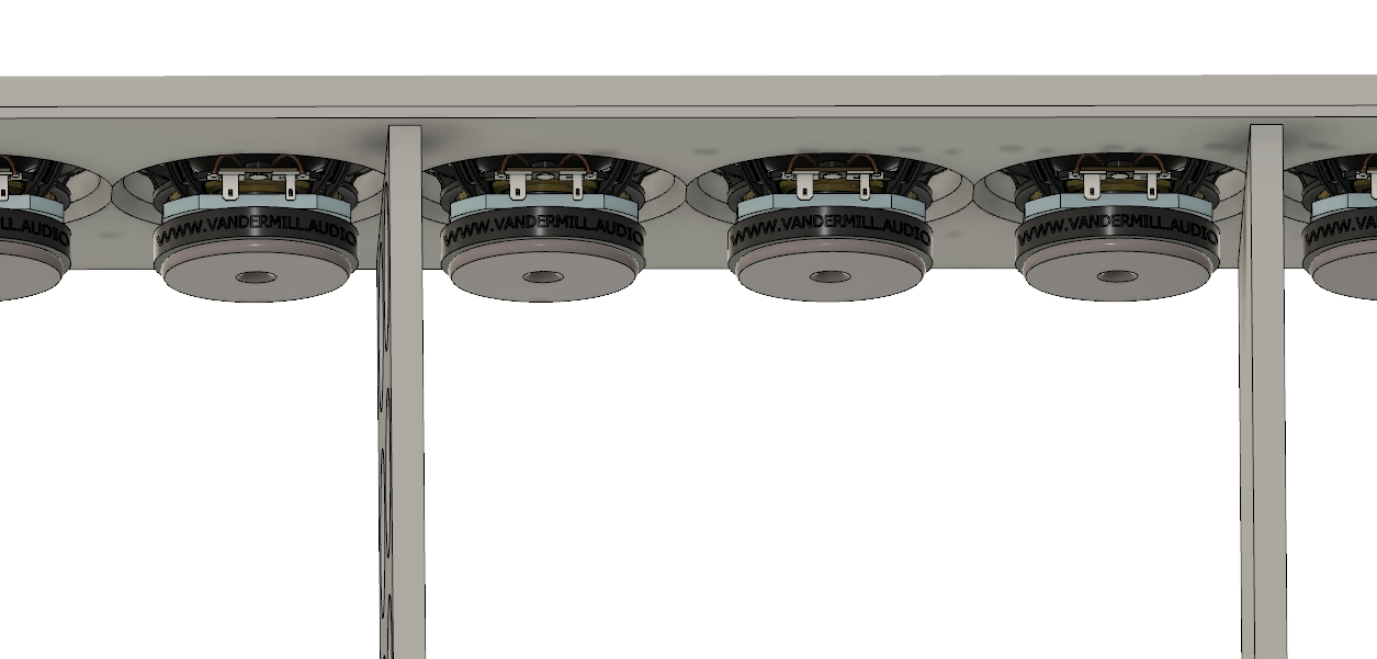

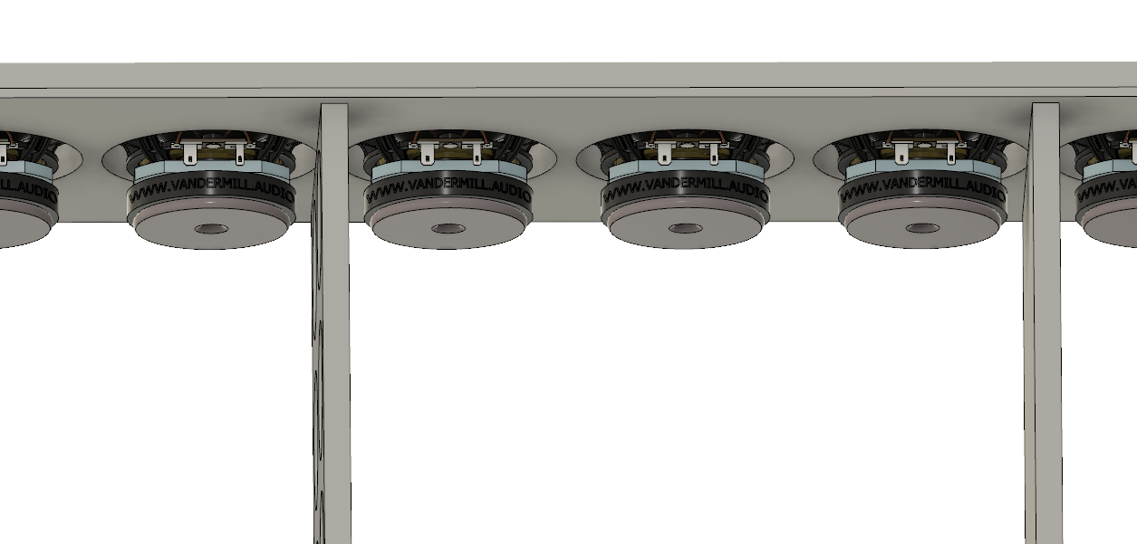

If you are going to brace the void that much then I really can't understand why you wouldn't build an enclosure isolated from the wall. You could build it in situ it doesn't actually have to be separate. Cut the pieces as if they were going to be a separate cabinet and then assemble them on the wall. That way you can use some neoprene between the panels and the wall. That's my last attempt to persuade you, you decide now ;)
The triangular cabinet will have a reduced volume and you need to know how much you will have, a brace every driver will reduce that down even further. A linkwitz transform can help to restore that but it also burns power. The bigger the cabinet the more it does the work instead of the amp. I settled at a Q of 0.8 when the damping is taken into consideration.
If you give me your exact internal dimensions I can put it into Bassboxx Pro and it will give me the volume numbers for you. It subtracts the volume the driver occupies and accounts for the damping to get a more realistic number.
I separated my cabinet into 5 sections and used solid braces to seal them. Each section of 5 drivers then has a cut out brace placed between the 3rd and 4th driver. This makes every section exactly the same in terms of volume an layout so it should minimize any discontinuity from the drivers not occupying a common volume.
If you mount the drivers with the terminals to the side there is enough room to fit a 9mm ~3/8" brace in between with the drivers mounted frame to frame. If you mount them terminals towards the brace there isn't enough room. 1/2" would fit but it would be very close to the magnet and restrict the backwave quite a bit.
I want my cake and eat it too! Perhaps I'm putting too much value in the concept of having the drivers as close to the wall as possible, in the simplicity of just building out the baffle with the rest of the cabinet in the walls, and the lesser visual footprint of a somewhat narrower baffle. And there's also the curiosity of seeing if I can make it work this way. In addition to the minimal downside risk as I can always adapt this work to the stand alone if need be.
I'd like each driver to have 2.0L of space. The resulting dimensions if I did my math correctly was a right isoceles triangle with interior dimensions of about 125mmx125mm. This was not accounting for braces and driver volume but did include extra space because the vertical length was able to accommodate 28 drivers vs the 25 I planned on (93" floor to ceiling). I would also assume mounting the drivers on a 3/4" baffle from the outside.
Understood. Perhaps 1/2" solid bracing for every five drivers and then cut out braces everywhere else.
Thanks for checking my math with Bassbox!
