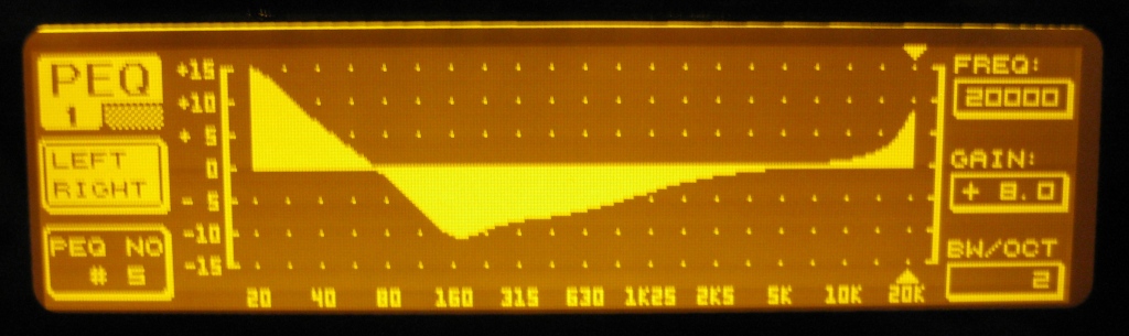

This is how easy it is to think you can eq your way out of trouble unless you work out just what other compromises you make to get there.

This image from OPC probably gives you the best idea of the kind of EQ that is needed to get back to roughly flat. RA 7 also had some raw responses in his thread which would help to predict what the benefit of the wall placement does.

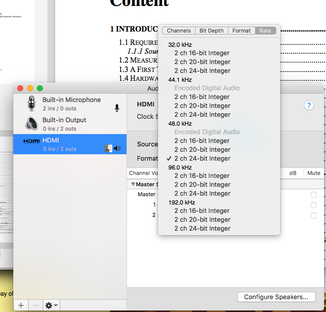

This is really basic question, but what do you do if you're using a computer that doesn't have pre-outs? Sounds like your workstation has 7.1 analog outputs?
HDMI is a good option if your AVR has it, as you should be able to EQ the channels in Jriver separately before they are sent to the AVR.
This what I get get when I plug my TV into my Macbook Pro. Only two channels because that is all the TV has, plug your Mac into your receiver to see if you have all 8 channels (assuming 7.1 AVR). If you do click on configure speakers to determine what goes where.
