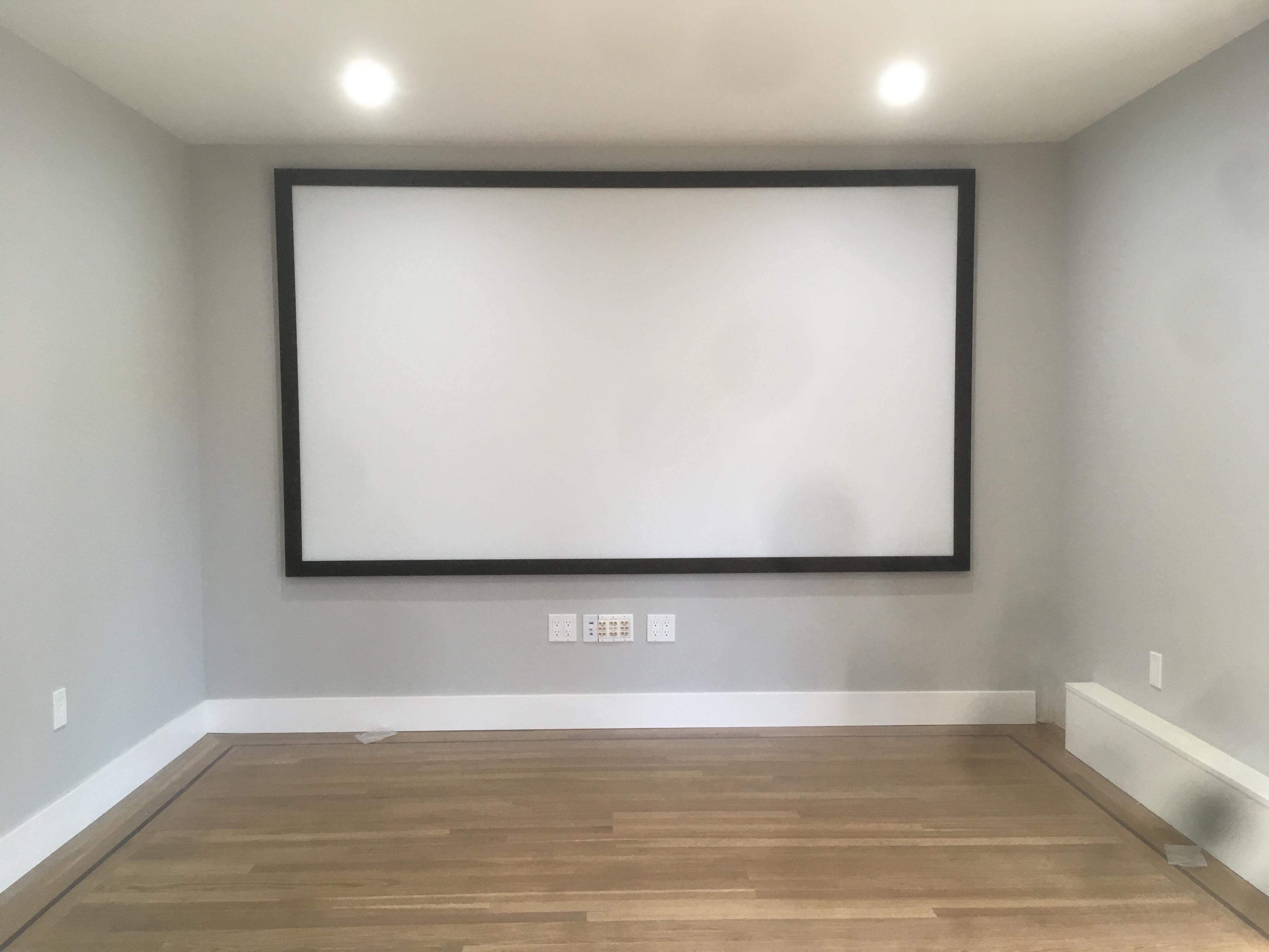

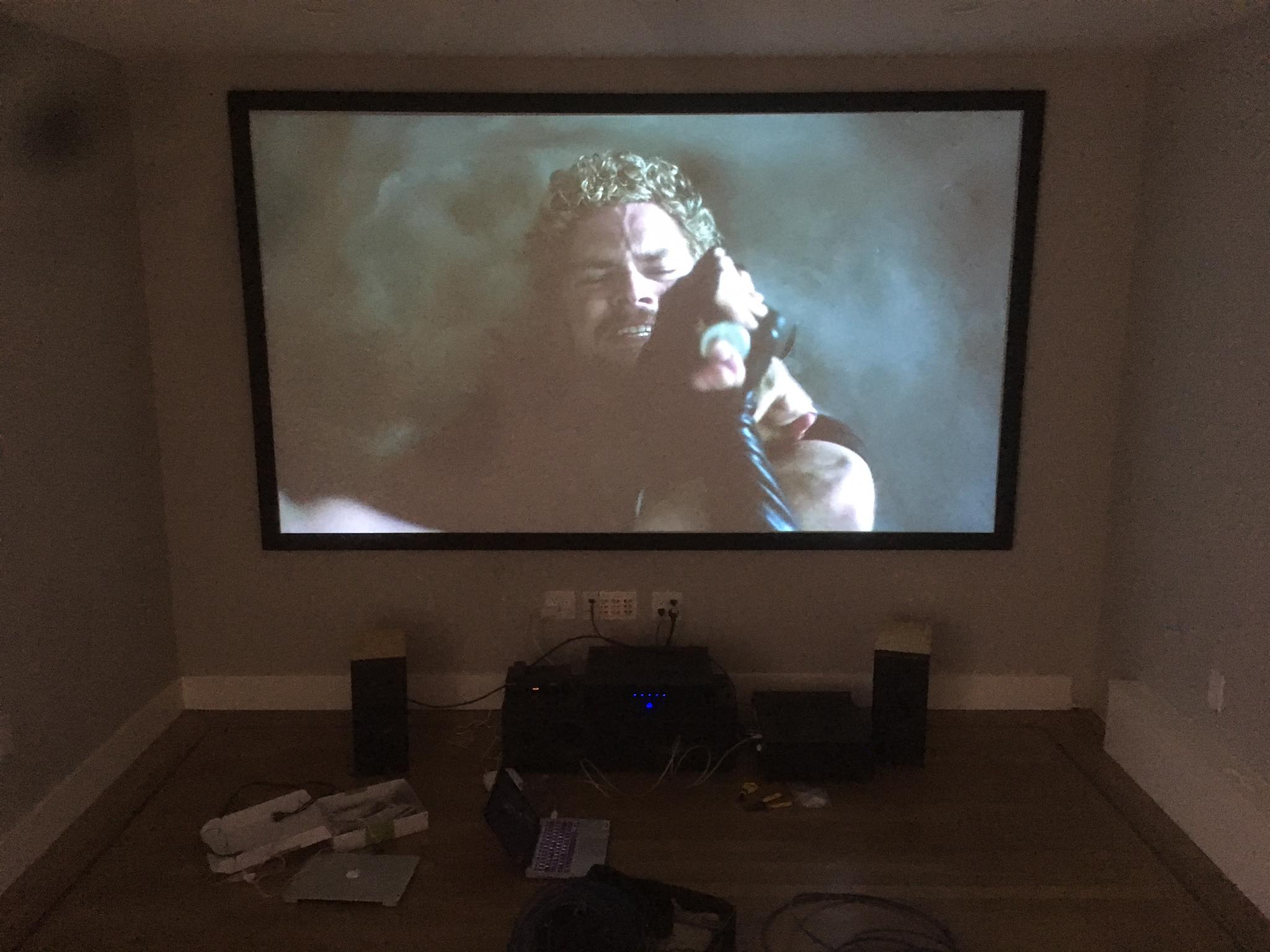

I love projectors... I wouldn't go back to TVs anymore.
I hope you have some sound absorbing panels planned for those parallel walls.
Indeed. The room is super lively right now. Planning on three ~2'x4' canvas photo covered panels on the left wall. And a big set of drapes covering the French doors on the right.
