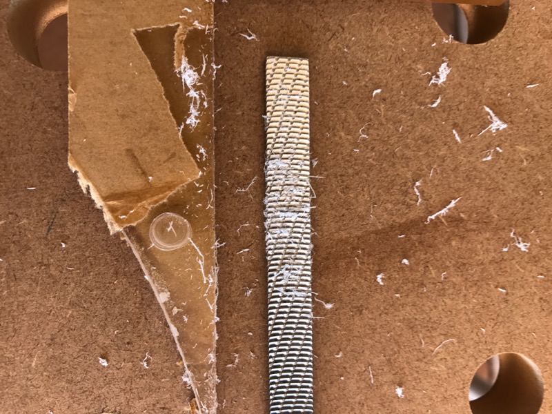

I was thinking about how to trim the drivers down a tad so I can squeeze 28 into the the baffle. I only need to trim about 0.5mm on top and bottom. Initially I was going to use a router but now I'm thinking it might be easier to just do a little hand sanding. Less risk of damaging them and probably less chance of contamination getting into the voice coil. Another idea was to just take a chisel or knife to the edge and do a little trimming. Any other ideas? Maybe I'll try the chisel/knife first, then sand paper, then router if the former methods don't seem to be working well.

This is what I would use.
Japanese Milled-Tooth Files - Lee Valley Tools
or sometimes called carving files
I use these for plastic and wood, they actually work like little planes, the finish they leave is unbelievable. Takes a little practice to get the right motion but they are something I wouldn't want to be without.
If you want to use a router I would screw the driver down to a block of wood that is flat and true on one edge and then use the edging attachment on your router to gradually sneak up on it till you get the right amount.
If you had a router table or made a router table you could do a similar thing. Screw the driver down to the wood to make a sled and run it past the fence at the right distance.
Do they create dust or shavings? I'd like to create shavings to minimize risk of contamination and also hopefully to make the process both accurate and quick. Wondering if maybe a draw knife would work. Or if a file is better with that in mind.
Shavings with plastic or solid wood if you get the technique right, angle it slightly across the workpiece
That's what I was trying to say here, planes take shavings. They also remove a lot of material quickly so it won't take long.
You could use a standard metal file but that will make dust and be much more effort, the shavings are much easier to clean up and keep out of the driver's innards. For your purpose you would only need a small flat one so not very expensive to try.

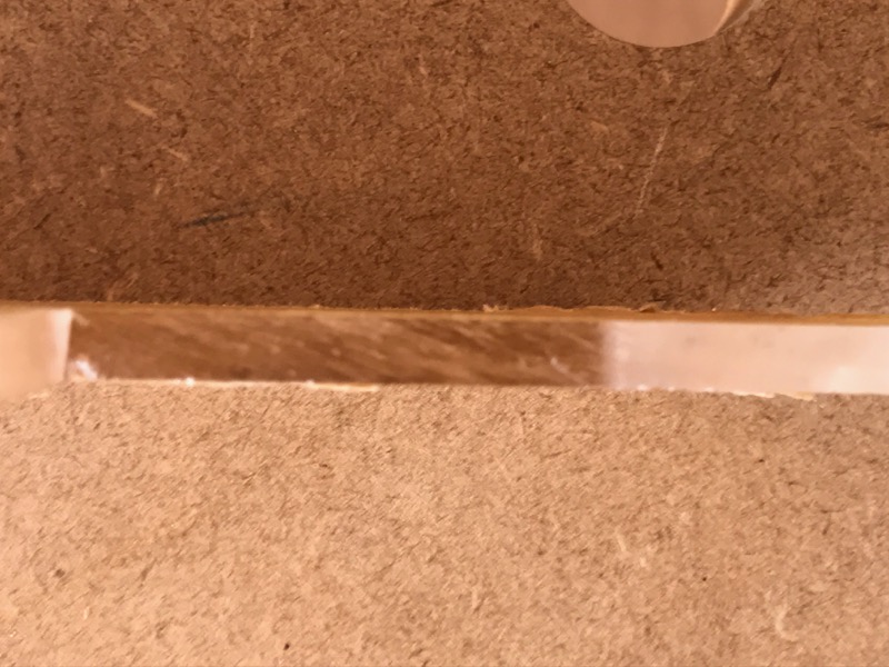

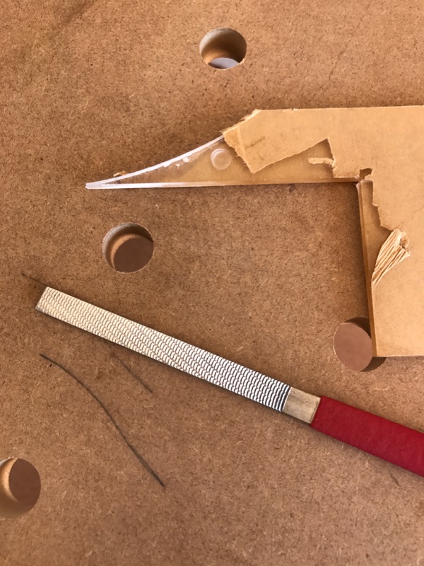

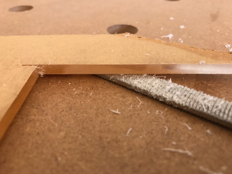

If I get a chance later I will take some pictures with scrap acrylic to show what they do.
Acrylic and milled tooth file
Acrylic before, fairly smooth from a Japanese saw
Afterwards showing the shavings
This is the finish after about 5 strokes

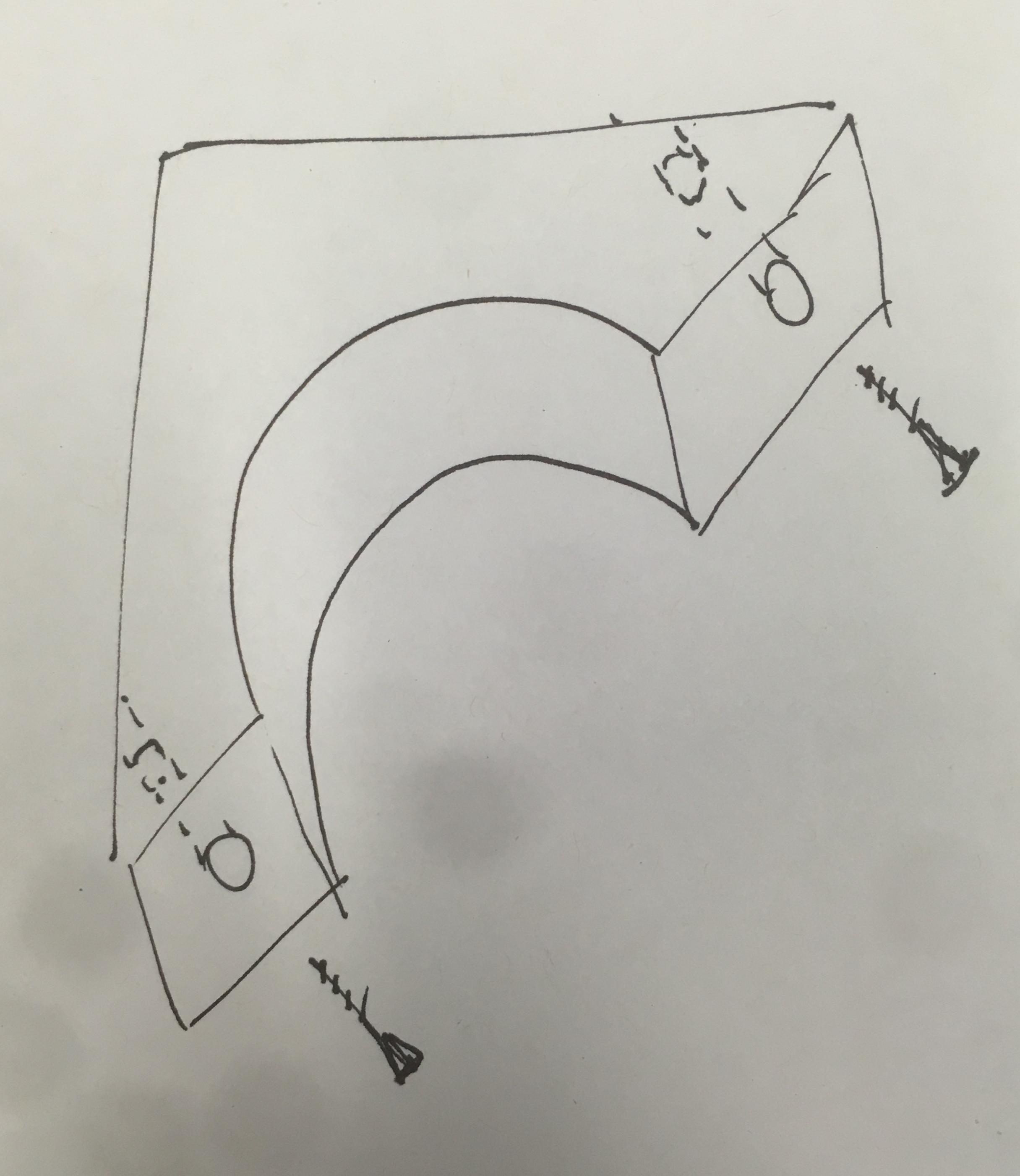

I wonder if I might do well to consider putting the 54 screws that will go through the baffle into the wall through a small piece of PVC tube. Then the baffle is supported at it's 4 edges and then also through these 54 "studs."
Alternatively, it may be better (and easier) to just add some triangle "ribs" every four or five drivers. I can screw them to the baffle and compress neoprene between the ribs and the walls. I could do one between every driver as well at the expense of interior volume. Instead of attaching them to the baffle, I can pre-drill through holes through the ribs and have the screws that go through the baffle to the wall go through the ribs. That would actually help with guiding the screws into the walls.
Be sure to divide the baffle into uneven pieces with these braces. That way it can't form a wave shape along it's length as easy (it will). If you break it up in even pieces you'd be clamping it on node points. So even bracing between 3, then 4 then 3 again might help there.
