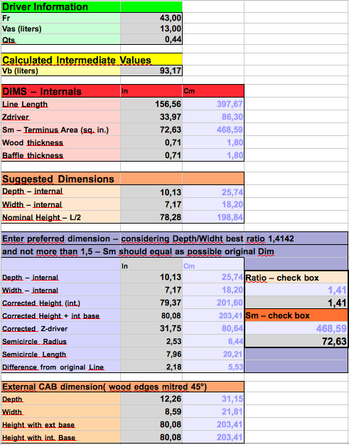

By recommendation from this forum, I think it was Godzilla. I dropped the Fs by a factor of 0.707 and then fudged off a few centimeters so the cab resonance is around 44 Hz. Oddly enough they fall off dramatically below 30 Hz. No idea if theyre supposed to do that. Maybe its a room resonance thing
Theyre big but the footprint is small and being tall plain boxes they dont scream for attention like a more elaborately shaped speaker maybe would
Regards /Bo

I looked up your dimensions but couldn't see if they were external or internal. Have you updated them as in last post? Could you maybe give us the current internal and external measurements and location of speaker unit on the baffle?
You have got some of us interested here!
andy
andy

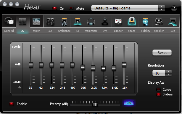

I think they were external. I did the math in Godzillas BIB spreadsheet. Pic is posted. My internal baffle is made of 30 mm styrofaom, hence the added depth. I forgot to mention the baffle step EQ it requires. I correceted in the Mac thats my music/film centre. Screen dump included
U can get the spreadsheet here: Bigger Is Better 'BIB' Cabinet Dimensions - ZillaSpeak
Regards /Bo

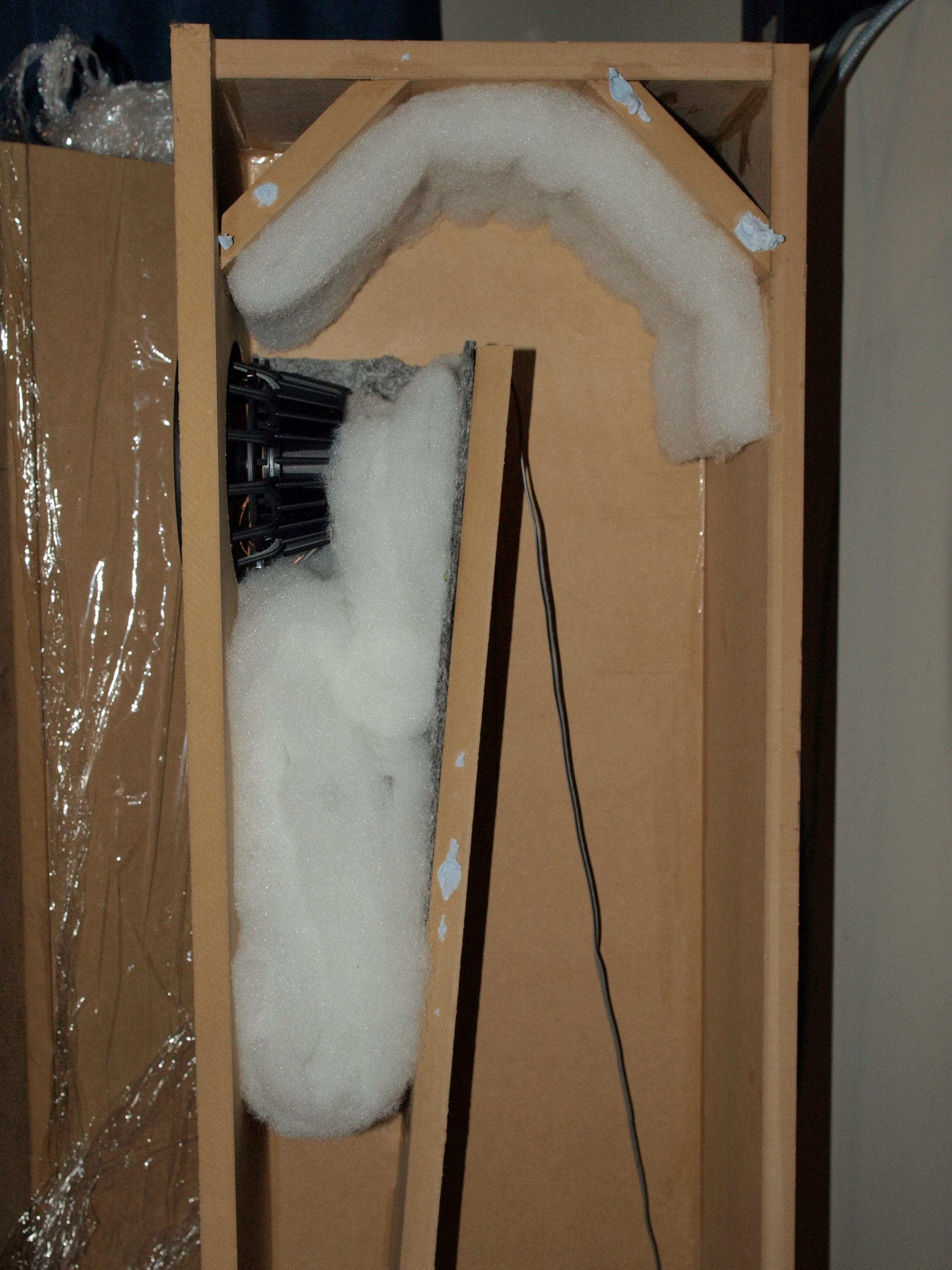

Almost finish ,only side panels left.
But not sure about the inside arrangement.
Should i change anything ?
maybe a bit less behind the driver... but that can easily be adjusted later
