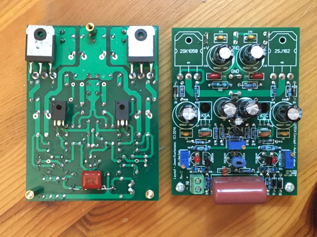

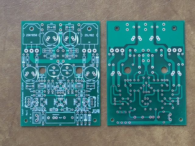

My boards just arrived. PCBWay makes nice quality stuff. Extremely fast delivery.

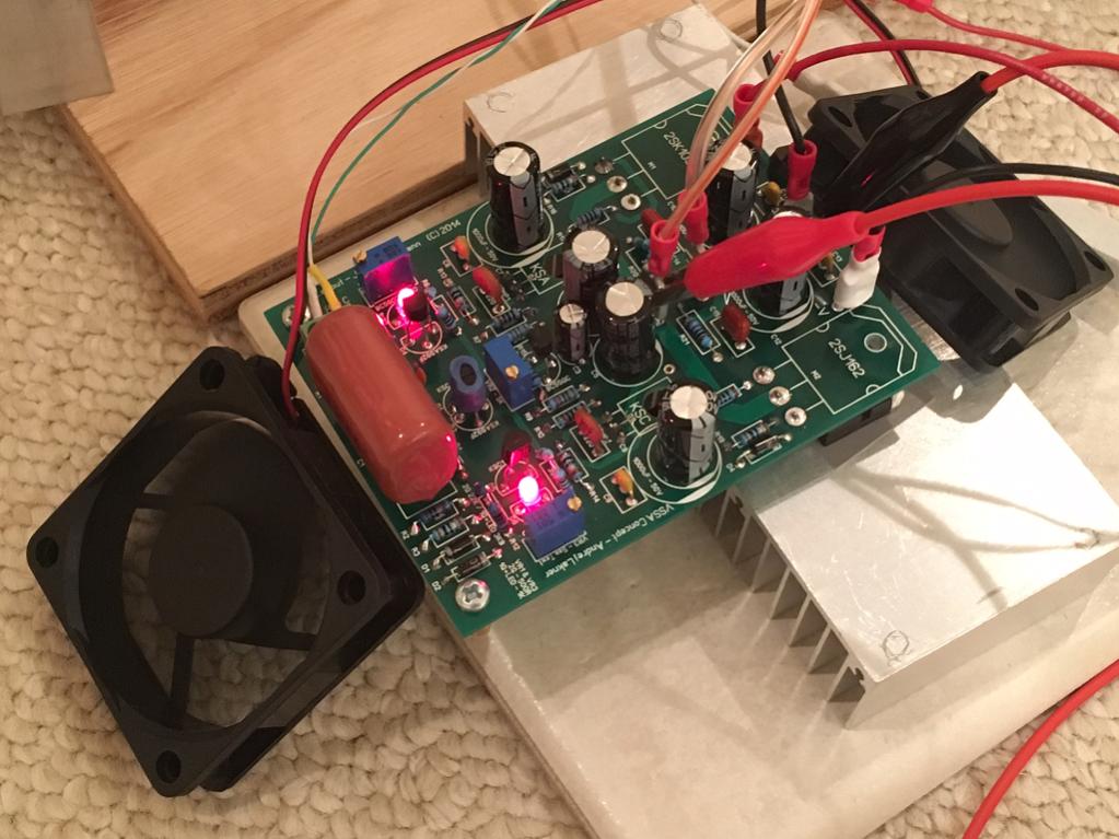

Test setup to adjust VAS current - cant get any lower than 280mV (140mV desired). I think it may be because I ran out of room since I am using 500R pots which were called for in the non-LED version. Nonetheless, it is singing now, albeit at a hot bias, 10R safety resistors still in place. Sounds quite nice. Circuit probably is good with exception of my incorrect VR1 and VR3. Is there a resistor I can change that will allow me to use the 500R's as I am all out of 1k pots?
These Aliexpress lateral FETs (labeled Hitachi) appear to be working.

If the unit works at all then the pin-out will be correct, otherwise the body diodes would be shorting the supplies.
It isn't the VBE multiplier he is referencing, he used the wrong value trimmer in the CCSs and therefore does not have appropriate range of adjustment. If the CCSs are running 'hot' so will the VAS current. The output current is controlled by the VBE multiplier and is mostly independent in adjustment.
Unfortunately, you will have to use 1k potentiometers to have appropriate adjustment range. There were no additional series resistors in this layout to make possible the use of the 500R unit you installed.
I could pop out the LEDs and put in transistors until the new pots come in. That would also require changing a resistor value. It's so much more cool with lights though.
