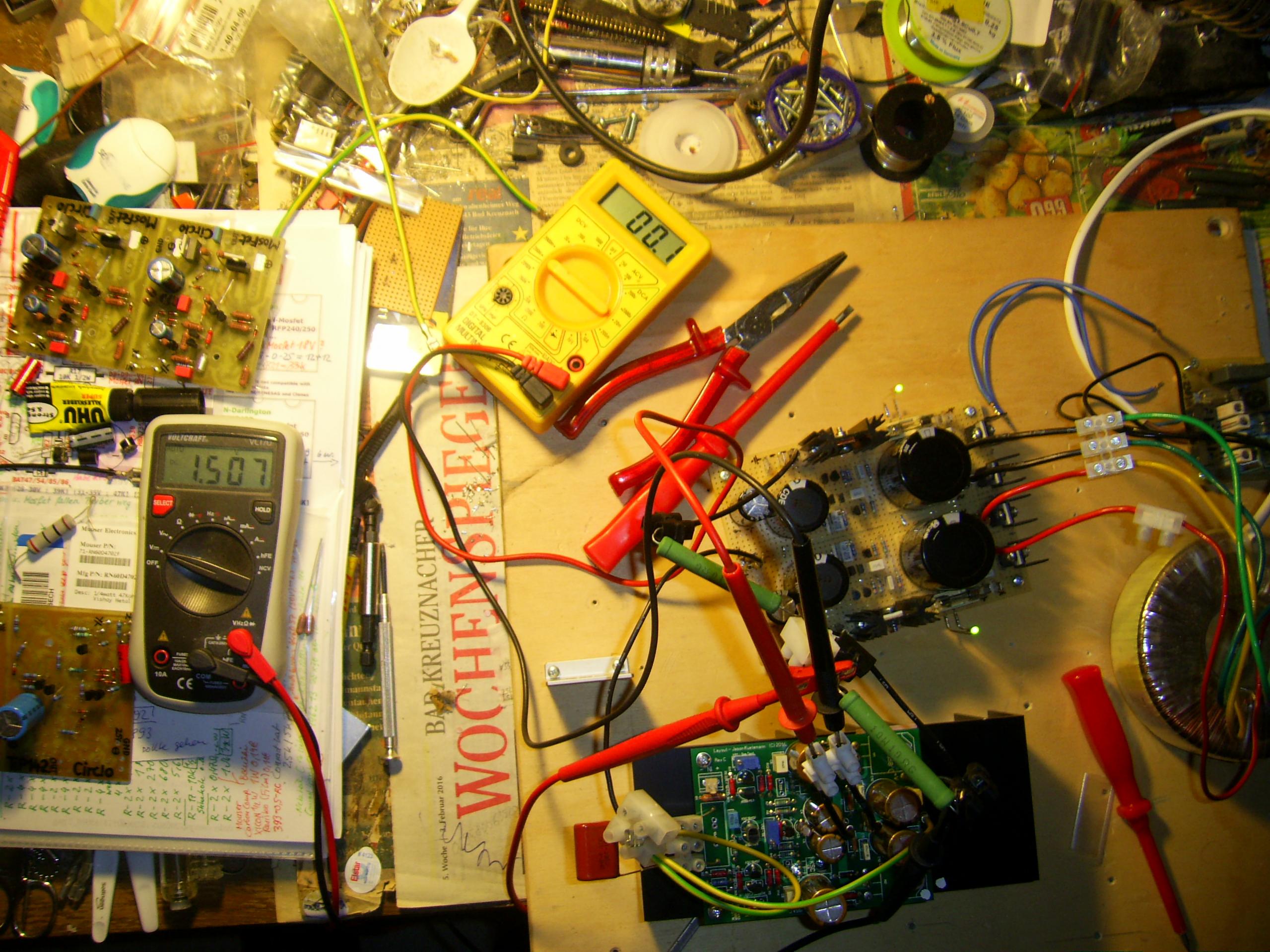

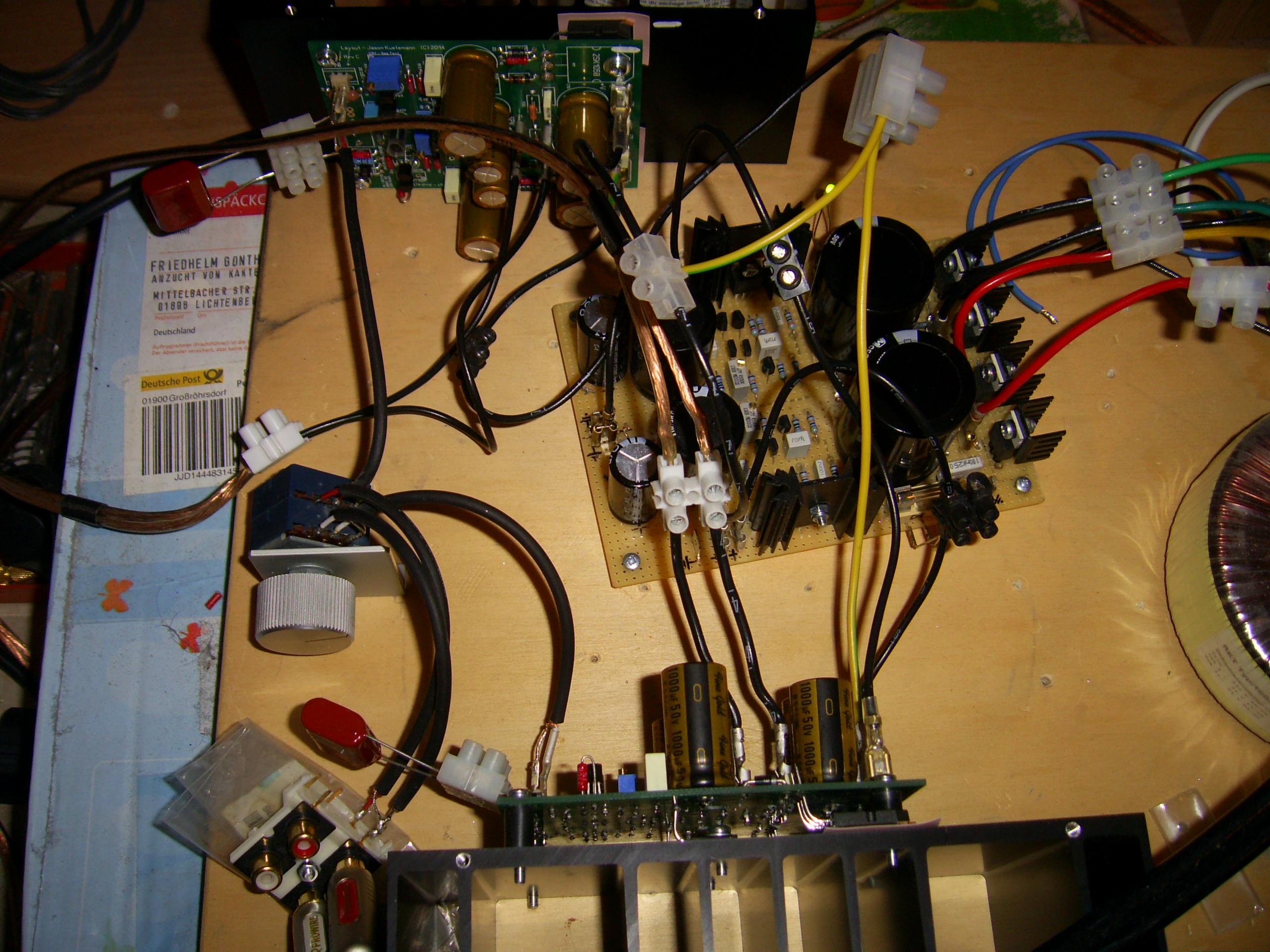

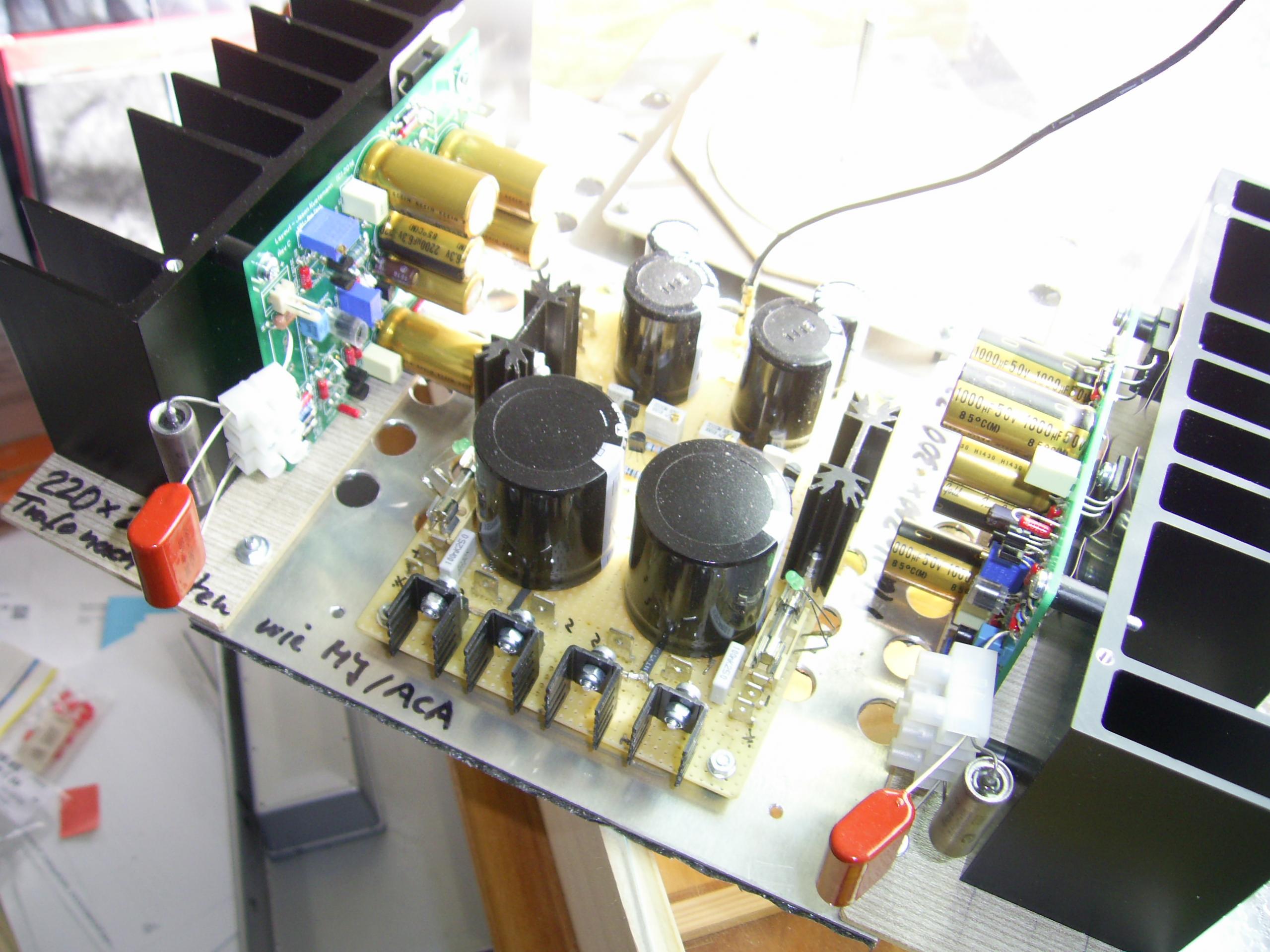

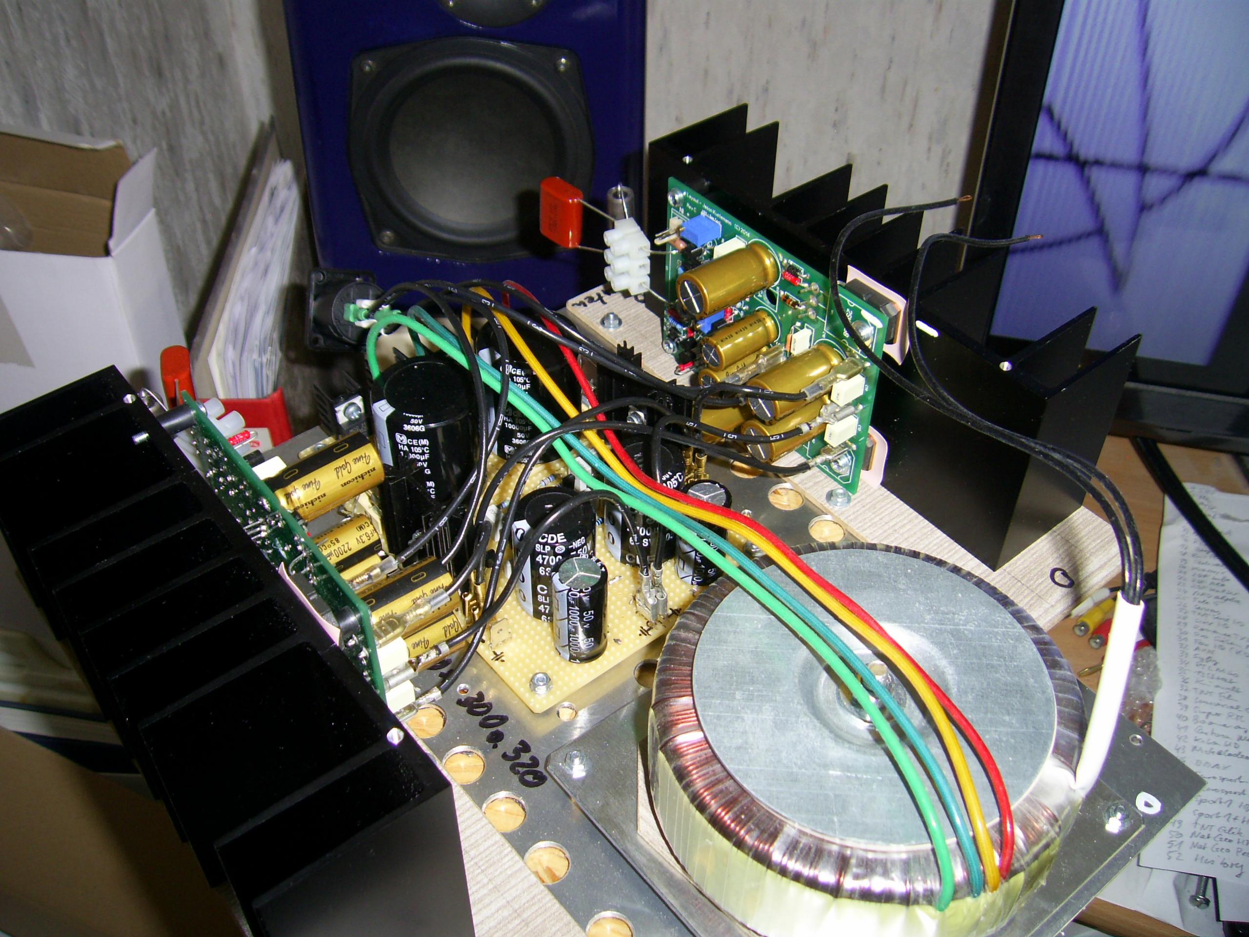

Now some testcase, only pics.
I would also count in if Jason finished next time new boards.
The Amp is to good to only have ONE!
Best Regards, enjoy listening Music.
