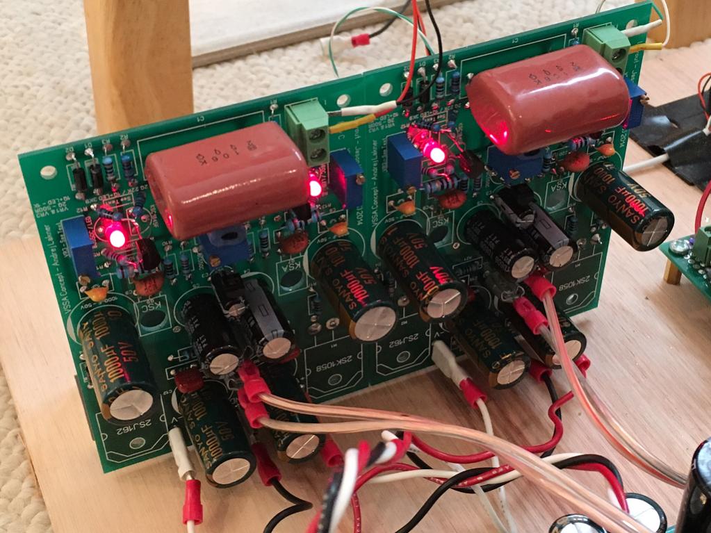

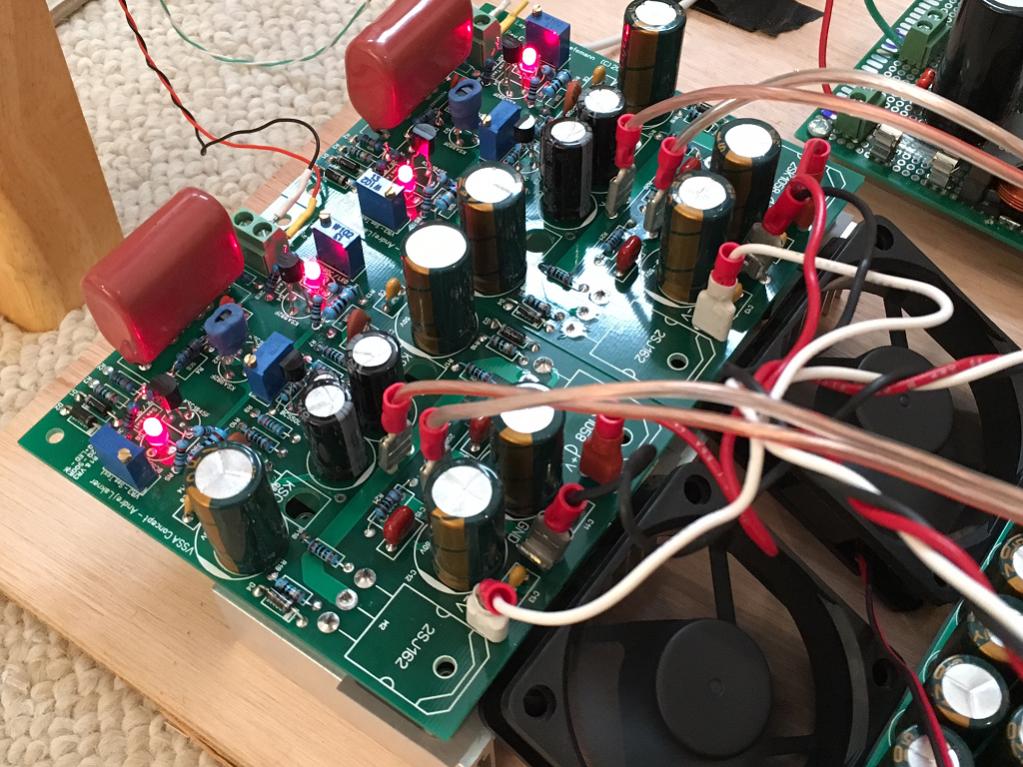

Despite incorrect VAS current - as I await the 1k pots to come in, I have been listening to this amp in mono. Sounds very nice - probably best word to say is it is very neutral. Doesn't add or take anything to the music. Running about 175mA bias - perhaps more would sound even better? Jazz trios are very very nice.
One other alternative is to cut the trace to the pot and solder a small 500R SMT resistor in series to get the adjustment range I need?
Edit: I think the current feedback topology makes the latFETs sound better for bass. I do not sense lack of it with the test tracks so far. But an AB test with a vertical hexFET is the best way to tell - so will do that when I am up in stereo. So far very pleased though.
One more thing, the Aliexpress latFETs are holding their own - I do believe these are genuine Hitachi's pulled from an old amp somewhere. They sound nice and are taking the heat well. Lucked out again as I paid $5.50/pair...

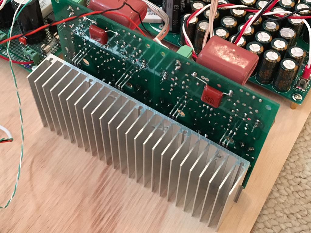

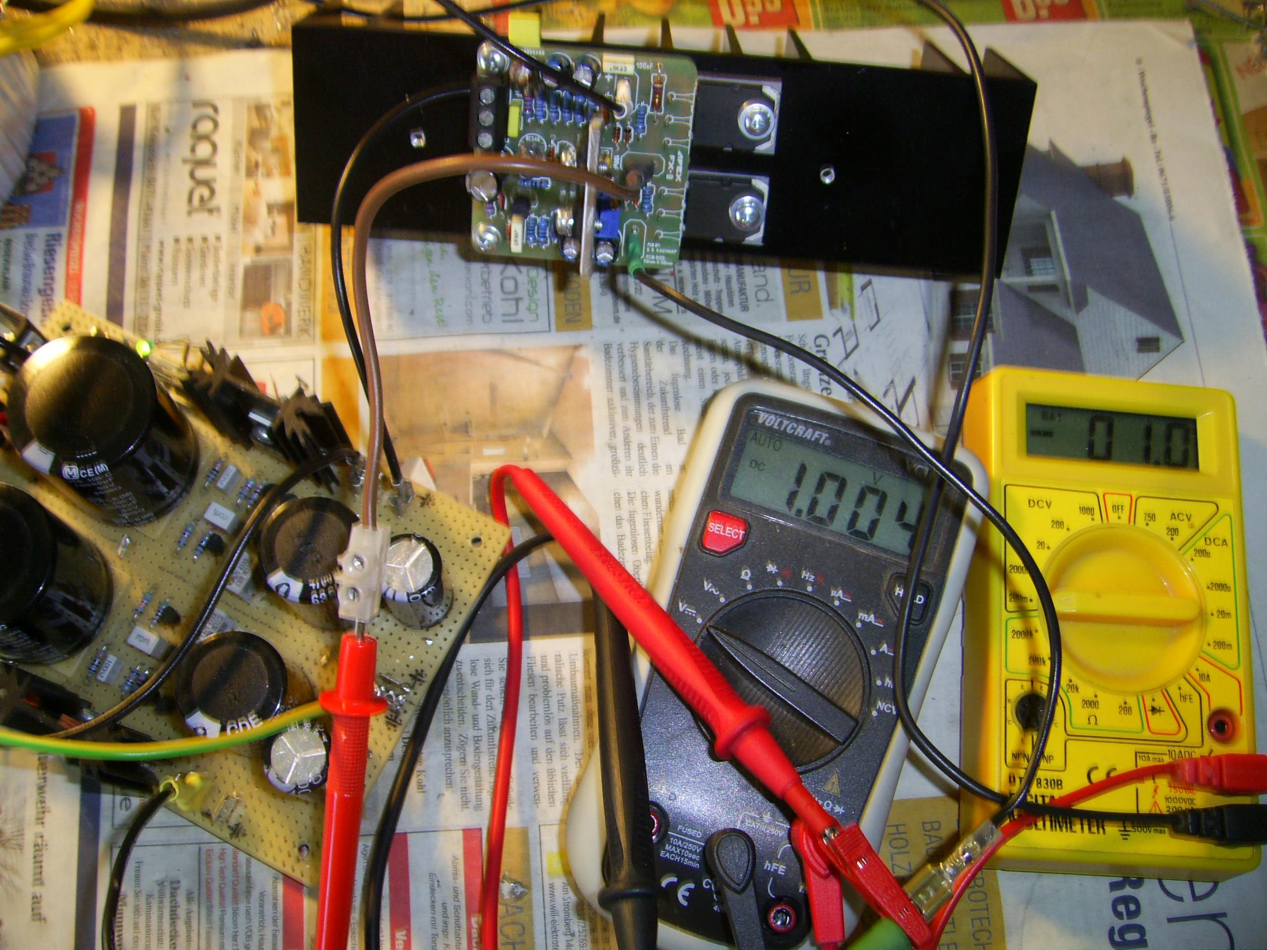

My bag of 50 1k trimpots came in today so I replaced all the CCS pots. VAS current is now properly set at 160mV across the 10R resistor. Overall quiescent current is 160mA. Zero offset is about 1mV.
The amp sounds very nice, distortion is low - perhaps lower than FX8. Measurements of the speaker show speaker distortion only. Bass is not lacking, very articulate and well controlled.
Something is not right though because this amp seems to be too cool for a 160mA bias current. The heatsink is barely warm. I know my FX8 at the same bias is quite warm with same heatsink. So I am not sure what is different given that I am measuring 1.60v drop across the 10R x 10w safety resistor on the power rail.
Mine all idle 'cool' with the correct bias on them. Doesn't sound like an actual problem to me.
Well that's reassuring to hear. It's almost cool enough to mount two amps on one heatsink without a fan.

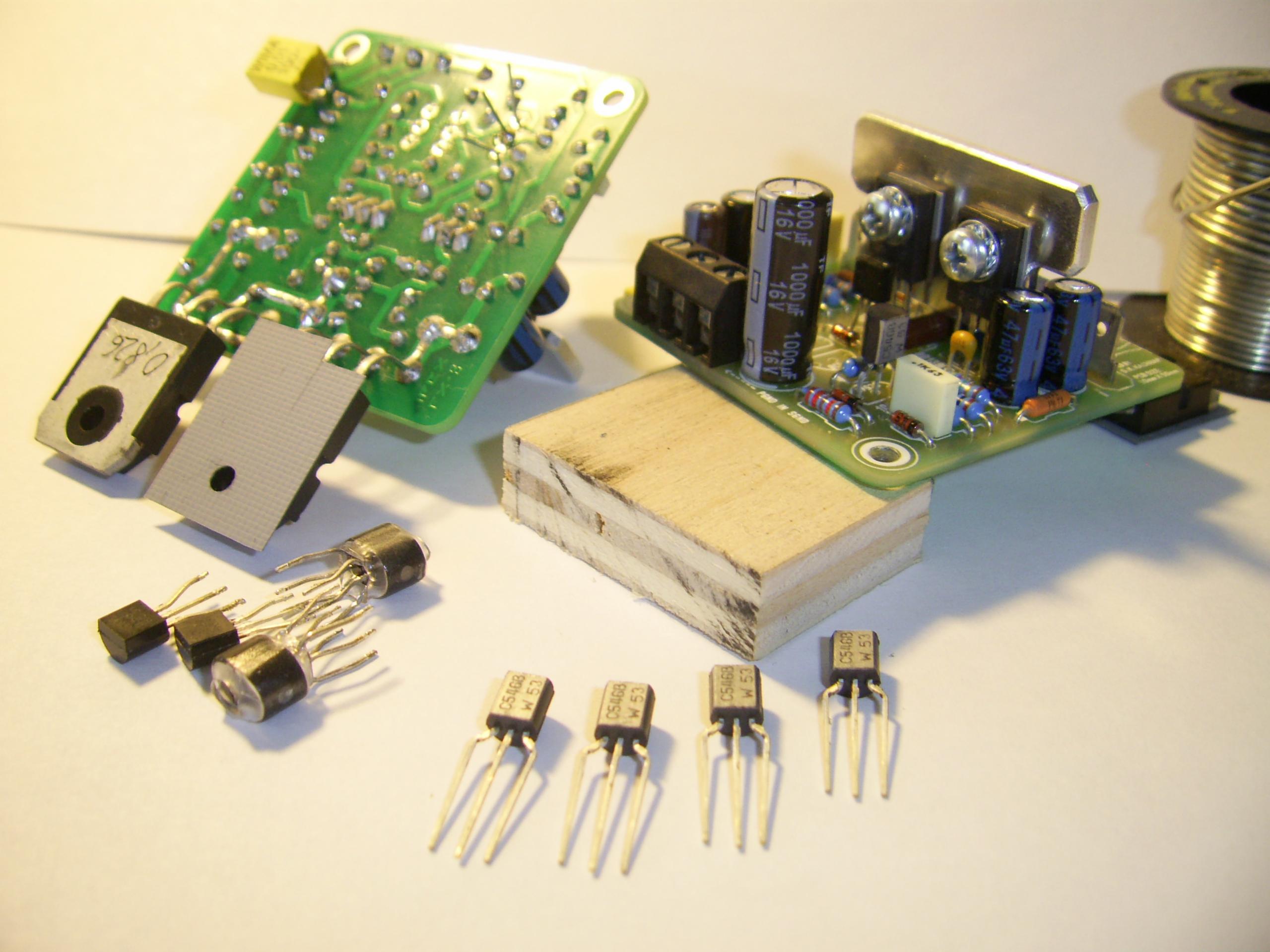

After fixing my bad idea to use different Input LTP without 180° rotation pinout the Amp is well biased and fine working.
After 2 Weeks in use i registered a bit better sorted image and opens a bit more in wide.
The Rest is a very clear detailed, not fatiguing presentation you can light follow.

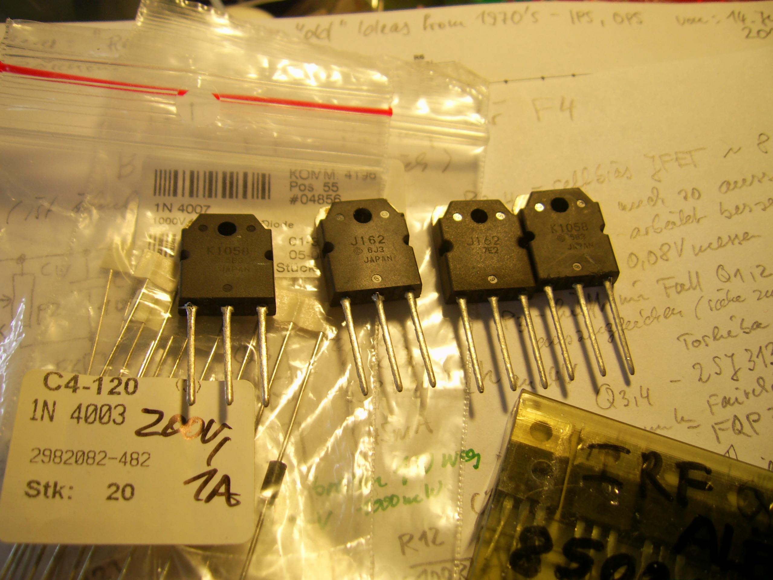

One of the J160's looks like it has been sanded. All have been desoldered. Suspicious parts make better amps ?
My first set from Aliexpress were clean and pristine like new Renesas. The second set look like used Hitachi's pulled from somewhere. Both work and sound good though.

Hmmmm, Chinese that are etched Japan.

In stereo

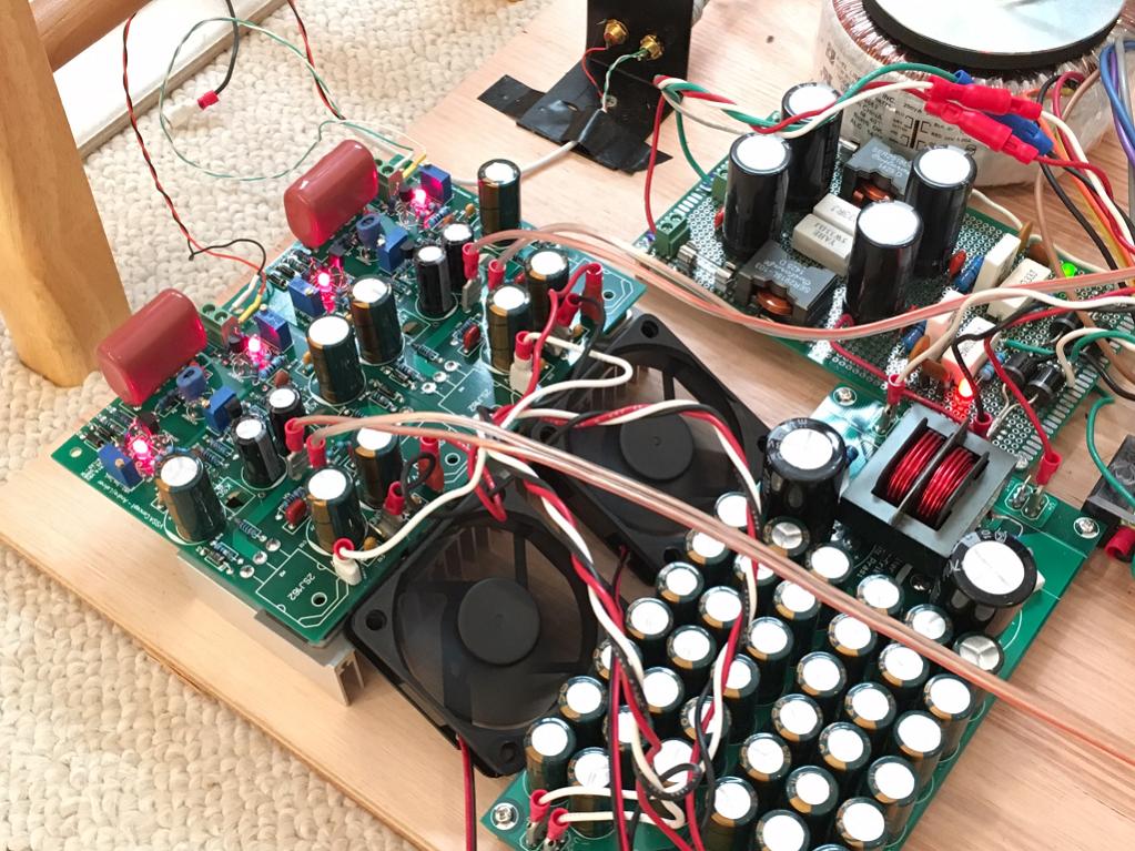

I replaced the 470uF caps (all I had on hand earlier) with some Sanyo 1000uF 50v caps, and mounted both boards on one heatsink (fan assisted). Now playing in stereo. Very nice
Closeup:
Testing natural convention (no fan) in vertical orientation:
At moderate volumes, the vertical fan-free mode is not too hot. This is a pretty cool running amp.
