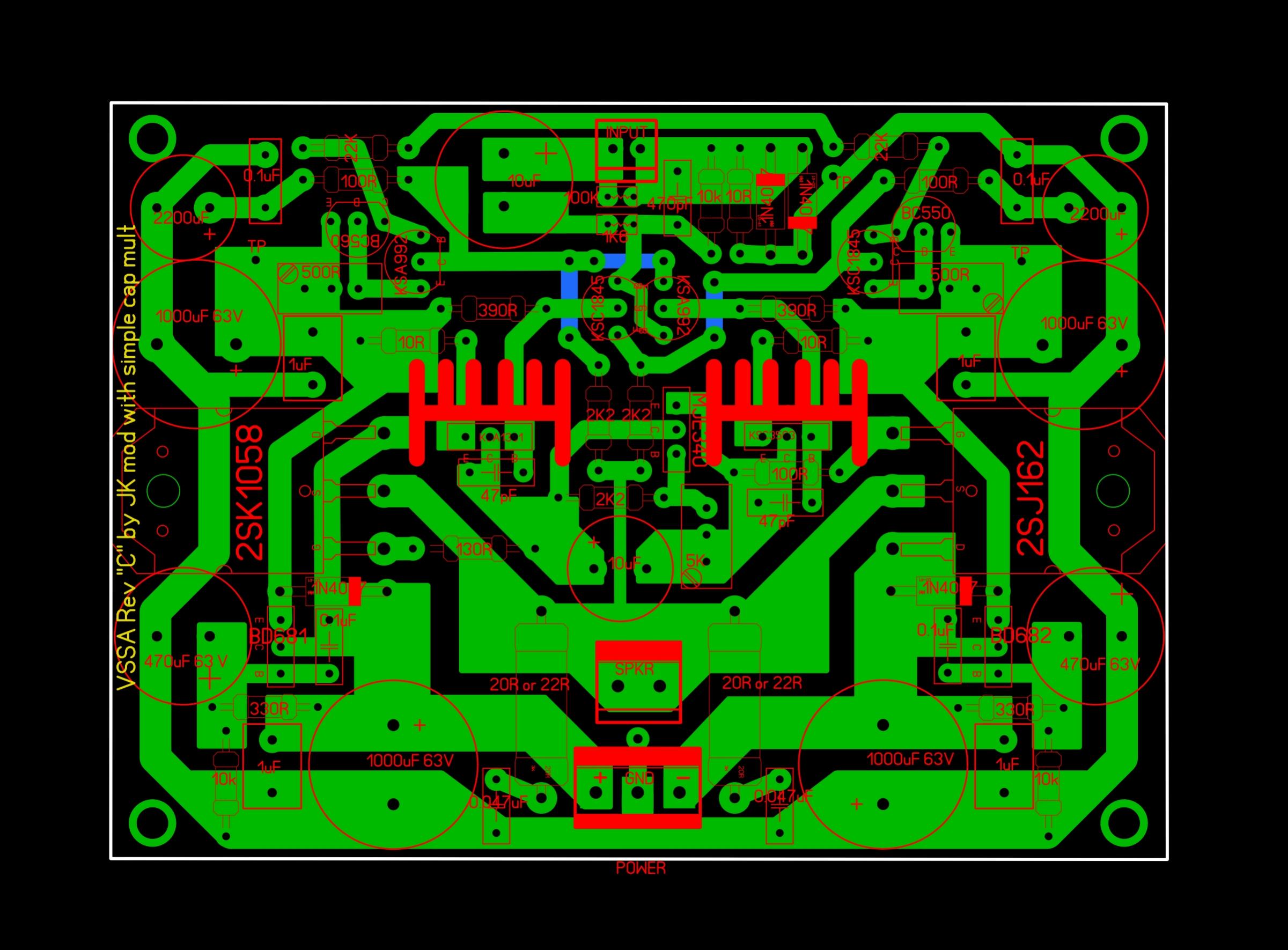

No PCB sales. I made mine using Sprint Layout 6 and Kinsten pre-sensitized board. If you refer to earlier posts by Jason and others in this thread, I am sure there will be suitable board designs that you can use.
I am happy to share my SL6 design file but I don't want to hijack this thread so perhaps the above is the best option. The moderator can decide.
I don't say for pcb sales but for pcb design that would be share.🙂
Re: Sprint Layout file
Please find attached the uploaded SL6 file. Note that the orientation of the 1000 uF cap located closest to the negative power connector has been rotated 180 degrees to correct its polarity.

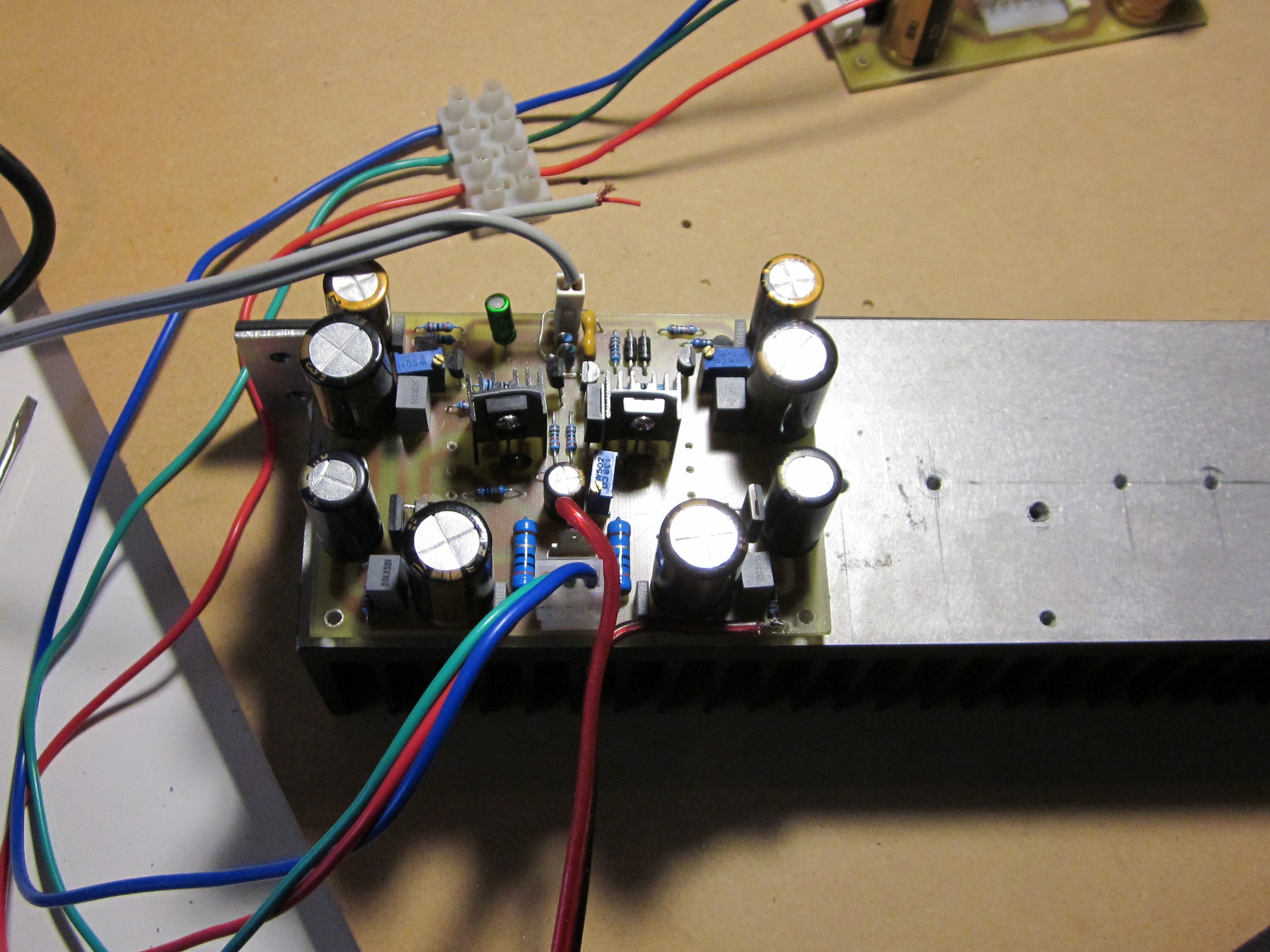

I have built this board, populated it and expect to run through its set-up and tests over the next few days.

Thimios,
I have set up and run the modified VSSA amp with the cap multiplier. It has to be the easiest amp to set up ever! Offset voltage was 2mV cold and around 6 mV warm with no additional adjustment. I will adjust to reduce the warmed up offset voltage later. Also I used 145mV across the two 10R VAS resistors and that voltage remained stable when warmed up.
Audio quality seems good but I will have to hook up decent speakers and a better source to truly compare with my other amps.
I found a minor error in my PCB input circuit layout which I have corrected in the attached SL6 file.
I will now build the second channel and hopefully it will be just as easy.
