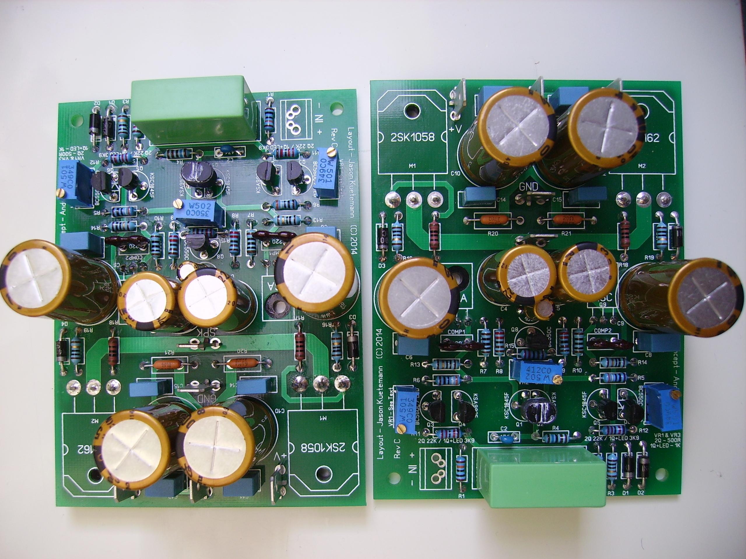

Attaching a High Res PCB photo. [pesky Forum reduced the Res.. a lot. I can Email the real version?]
Perhaps helpful to the boards' father
in identifying parts in wrong places/wrong values?

When you say you have continuity between power pins and ground in various combinations are you leaving the meter on long enough to ensure you aren't just charging up the on-board capacitance? That could give a false indication of continuity if your test is very quick.
It is entirely possible that due to the use of an SMPS that the resistors couldn't take the large current pulse that comes with how fast the PSU can apply the full rail voltage. If you have them, try something close to 10R in a higher wattage, say 3W or greater. There is the possibility that there is nothing wrong and the small resistors you used just couldn't hack it. I don't see anything obviously amiss.

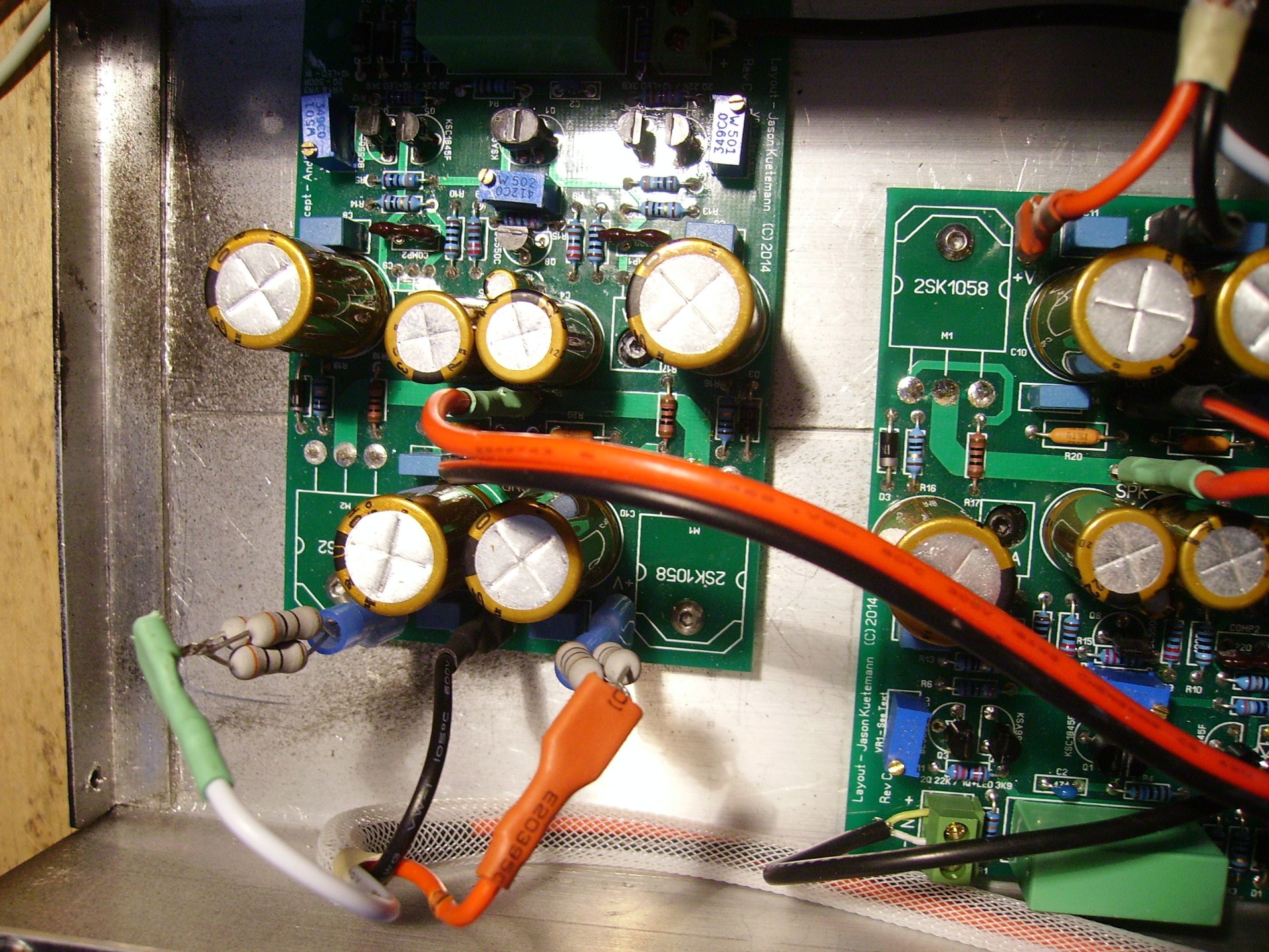

Oooh No.. did You mean like this?

The resistors are more of a safeguard for the first power-up than anything else. In the absence of an ammeter you could read the voltage drop over one of those temporary resistors to indirectly measure total current.
One you have a module working with the resistors as you show, you remove the temporary 10R resistors. Replace one resistor with your ammeter and connect the other power connector directly to the module. That way you can read total current draw and set the output stage idling current using VR2. The module total current draw should be between 120mA and 160mA. Your ammeter should have ideally a 200mA range or alternatively a 2A range for this adjustment.
PSU +V --> AMMETER --> AMP +V
PSU GND -----------------> AMP GND
PSU -V -------------------> AMP -V
The measurement across R13 can be anywhere from 120mV to 160mV and tells you what the current through the VAS (the smaller transistors touching the heat sink) is. It takes a bit for thermal equilibrium to occur, so things can wander about just a little but that is nothing to worry about.
