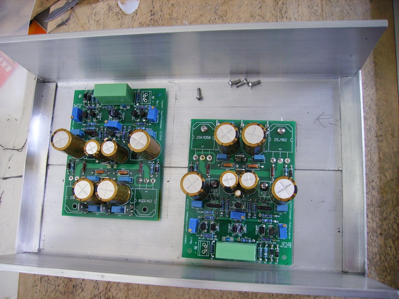

Finally 😱 Getting 'round to assembling My attempt
Started to assemble My DIY case.
Blind tapped the Heat sink holes.. bit of a Pain.
Then realised that JB Weld Might be easier for basic Case assembly..
It is 🙂
Using Kapton tape as Insulation of the Big devices. Hope it works .
Case photo.. It's upside down, 10" x 3" angle Ali for each board.
Should be enuff?
Too utlitarian in 'look', likely spray it in Wrinkle paint.
Now needs off to the local reseller of Cheap/ebay Chinese Electro parts for connectors rca's and binding posts.
Ohh possible? to connect a wee LED Somewhere to the board, Or it's supplies As a front panel on /off telltale.
No switch is planned as My 2 smps's will be individually outboard in their own boxes. Sigh More boxes.
At least Now I know I can glue them together 🙂
Seemingly Box building is More of an Issue than Board stuffing.
Unless I made an Error there?
If you are using a toroid transformer, just take some fine wire and make a few turns around the transformer and measure - enough for say 5V. Assuming 2V for the LED, that leaves 3V. Put a resistor in series (3/R) to limit the current to 5-20mA, depending on how bright you want.
Sheldon
Thanks.. using SMPs.. For Now.
May use a pair of the Pass DIY Linear Supplies (24V) eventually.. IF necessary
