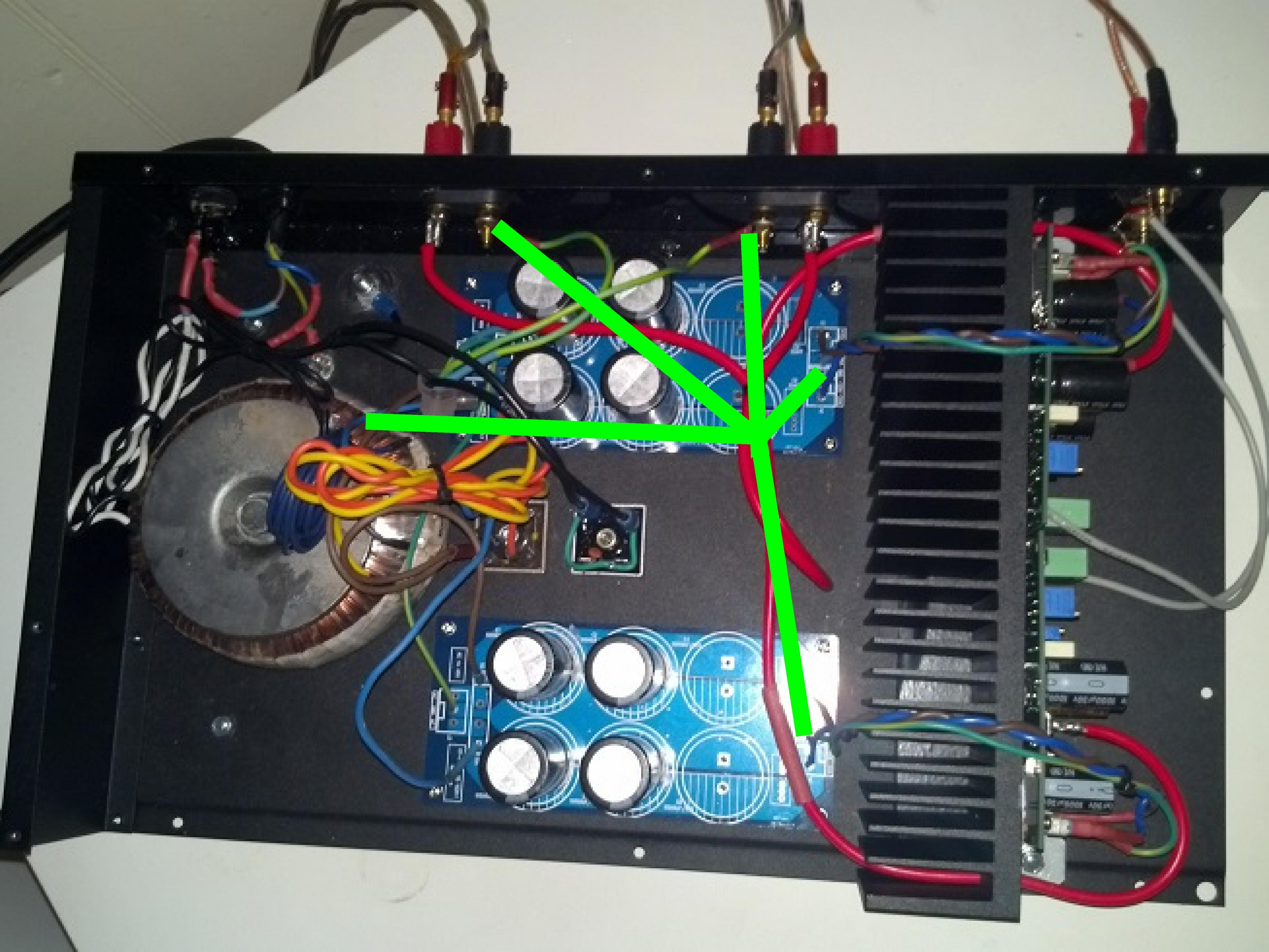

Roger, you don't have star ground. You must connect all your green wires at a single point after smoothing caps.
Each board has its grounds arranged to basically be a star of its own. It should only need its main ground tab connected back to the main physical star on the PSU. This will produce a star-on-star arrangement.

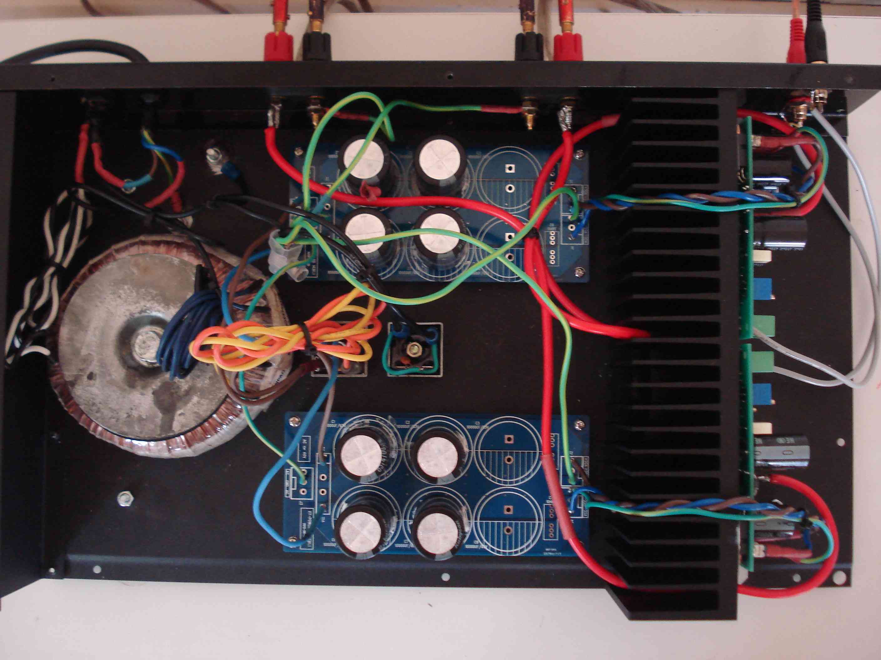

Thanks Dobrivoje, think I'm getting closer... Now only the left channel is buzzing (but less).

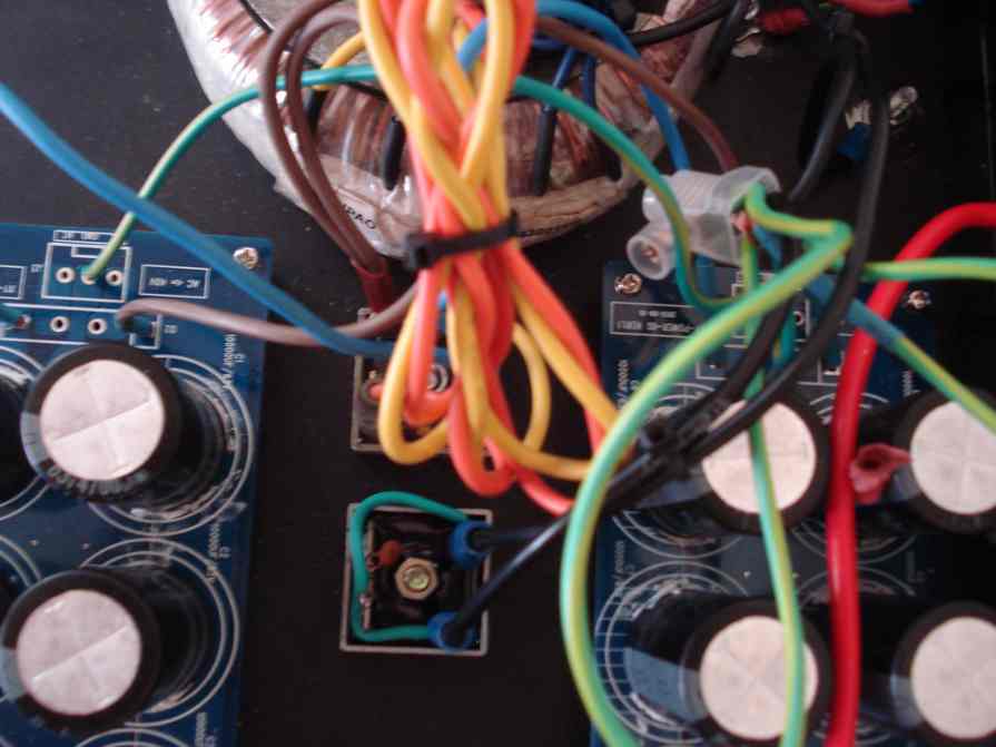

Took ground from after smoothing caps and connected to all other green wires + centre tap and return. See latest photos.
(Also tested using the GND speaker return on board to output or back to star point, but that didn't make any difference).
What's the best way of measuring for points on the left channel PCB that are not grounded or returns that are not properly connected?
Checked PSU ground solder joints. Left channel amp GND lug also looks solid.
Star connection is soldered and screwed together

Roger, you still have ground loops. To avoid them you should have only five wires, like I drew them: one from center tap of transformer secondary, two from supply pcbs and two from speaker terminals. Nothing else. You should remove wires from input side of supply boards.

Ok Dobrivoje, Think I understand now. Nothing wrong with your English and illustration 🙂
Have since cut both wires from the AC side of the PSU boards. There is now only four green wires going in to the star, plus the centre tap. Another wire goes out to the case via two diodes (half of the second rectifier is used) with a resistor and small ceramic between.
Results in buzz from both speakers again, however still quite soft and barely audible from about 1 meter.
If I temporarily reinsert the left PSU GDN the revolutions of the buzz increases slightly (but not the pitch).
