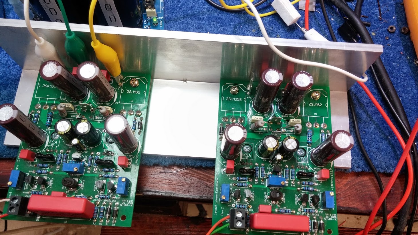

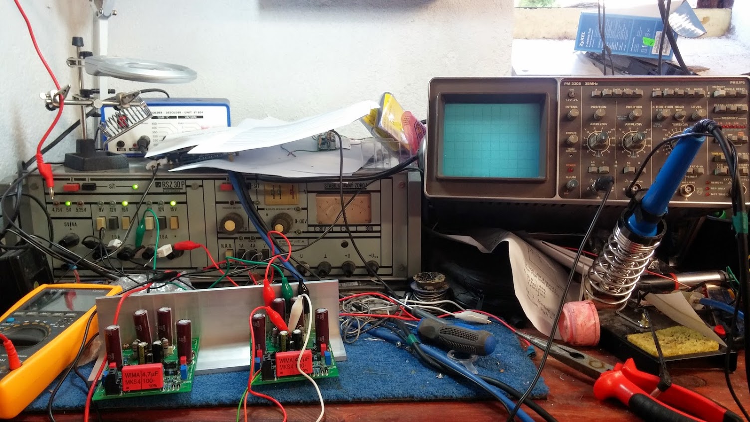

When I already finished SKA, It's time to try next one...Today I checked both channels, and It´s working ! 🙂 Great work Jason... now I have to build proper PSU...

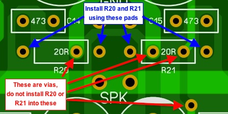

Just have a look at where you installed the 20Ω zobel resistors. Make sure you didn't use the pads inside the rectangles representing the device body. They are just vias connecting traces between top and bottom. Use the pads located outside the rectangle on either end.
I didn't make it real clear on the silk or documentation and some have been confused by those 'extra' pads.

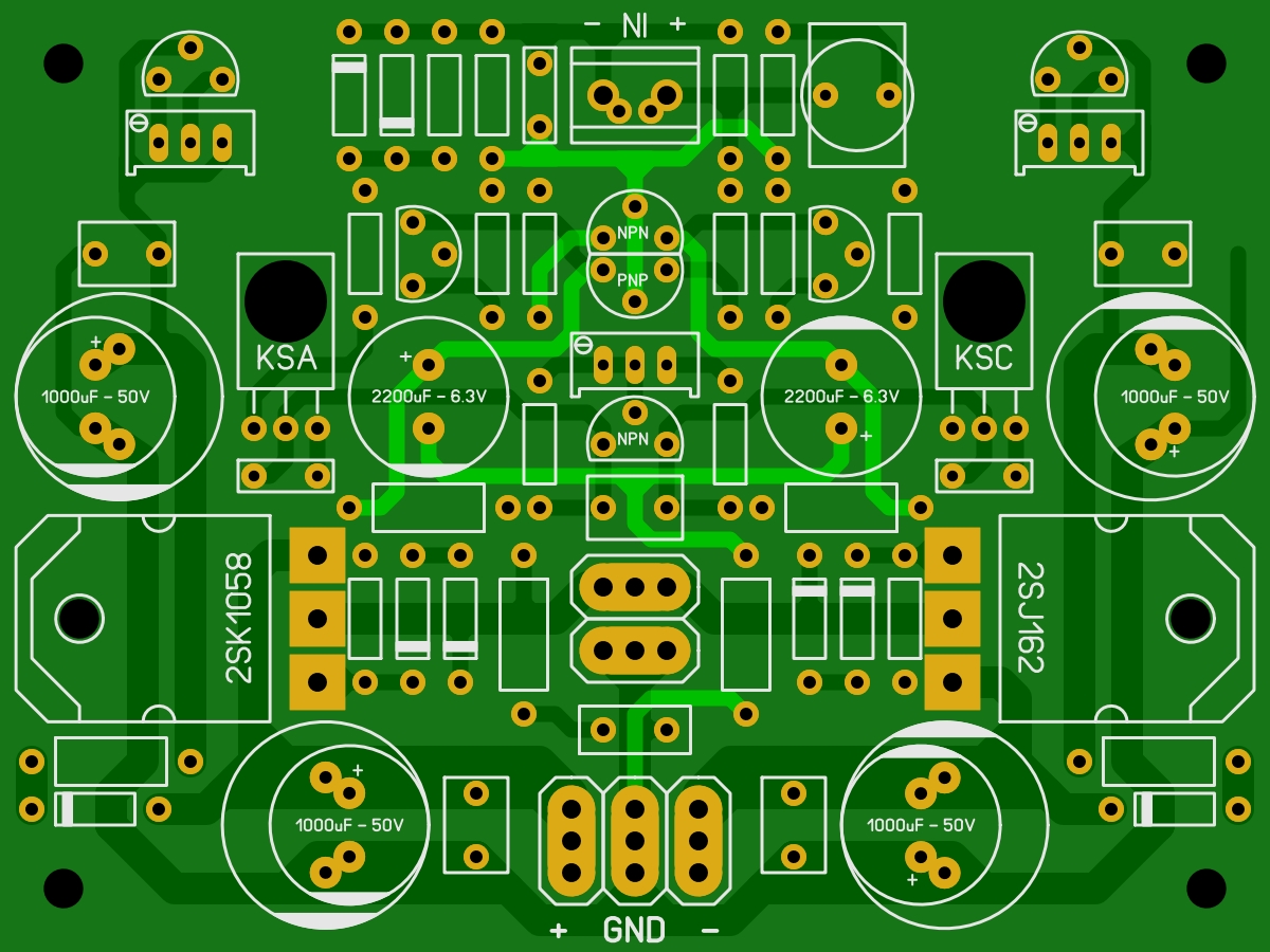

Potential Revision 'D' Board?
I started re-arranging the VSSA board and am getting something in a PMI-like form factor. It is however not a copy of the PMI board. Some have mentioned with prior layouts that output device placement could have been more idealized and that accommodating lower profile heat sinks might be of benefit. This will be 3" high and 4" wide, so the same size board as before, just horizontal in orientation. This layout is not yet complete.
I don't know if the little VSSA has played out or not, but if there's still interest I'll continue to develop it. I'm looking to improve the CCSs with precision shunt references and if there's room maybe a cascode device to help keep the CCS output impedance high. There is also some influence from the discussions in the SlewMaster thread pertaining to the CFA-XH IPS and improvements in its design as well.
Thoughts, suggestions or constructive criticism welcomed.

I chose 0.200" spacing should someone want to use a screw terminal block or Molex type pin headers. More variety in connection options.

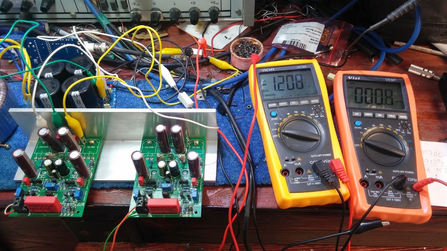

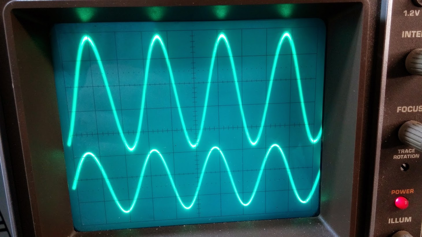

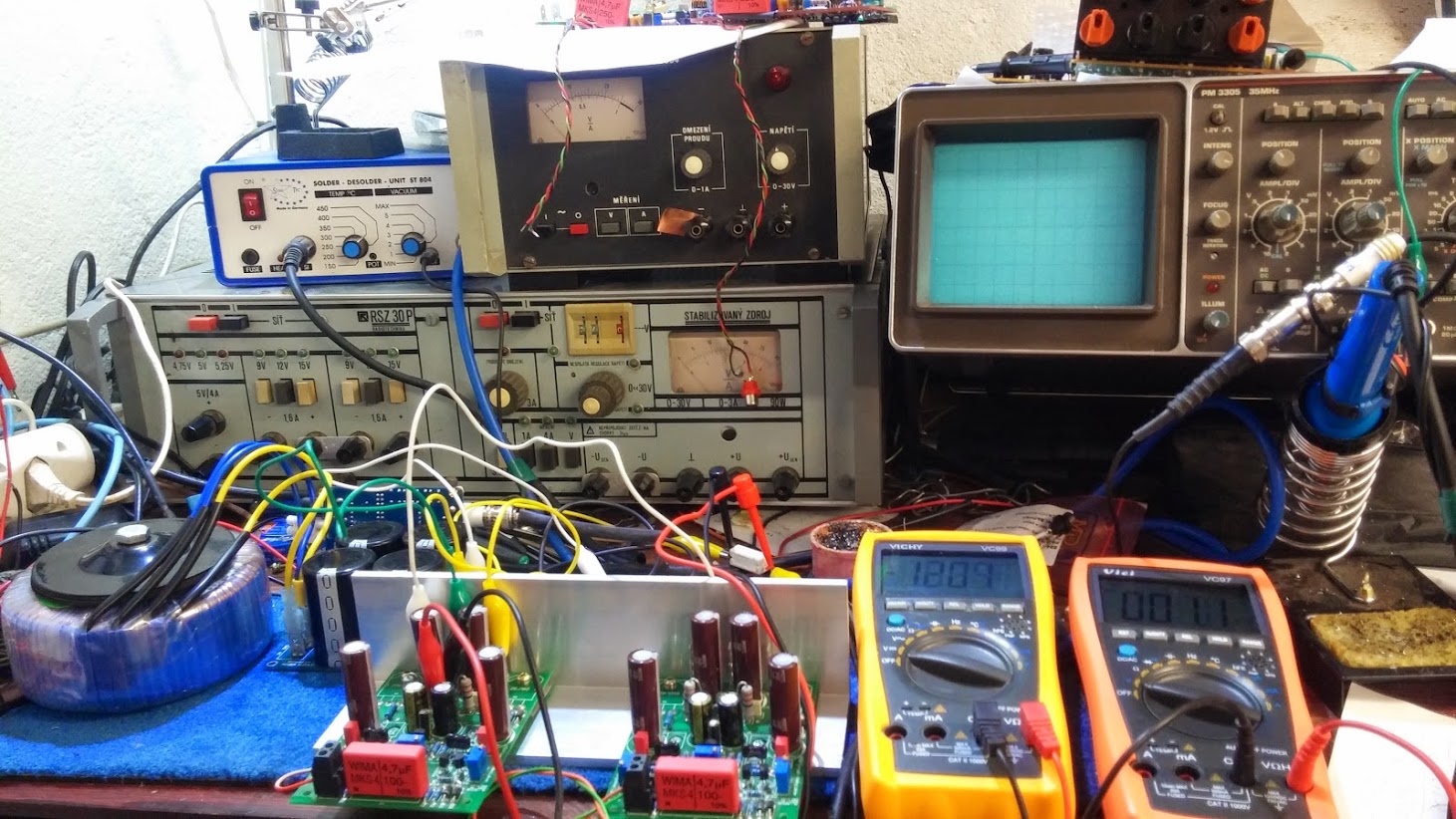

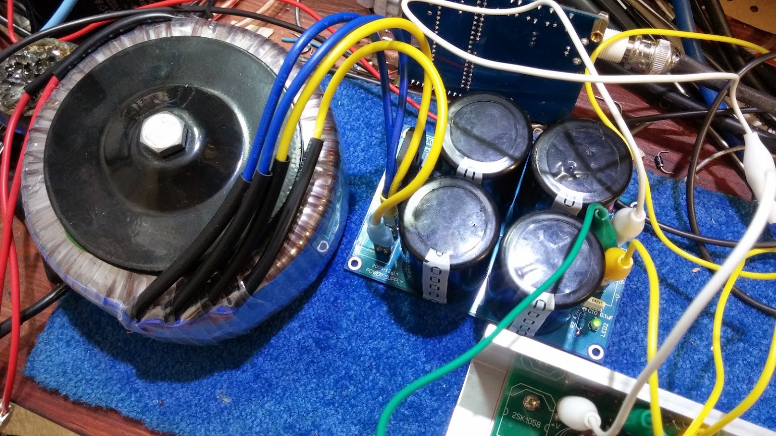

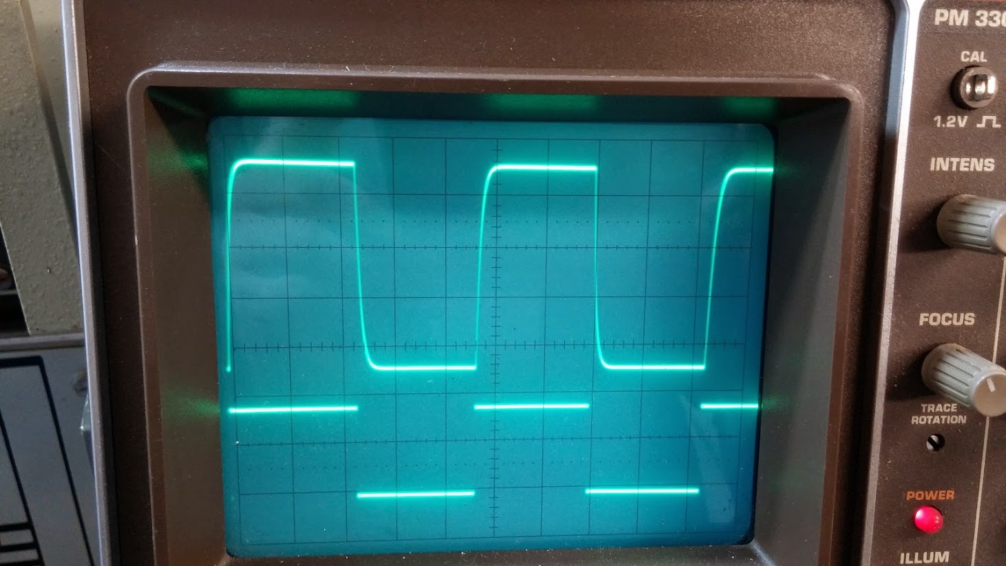

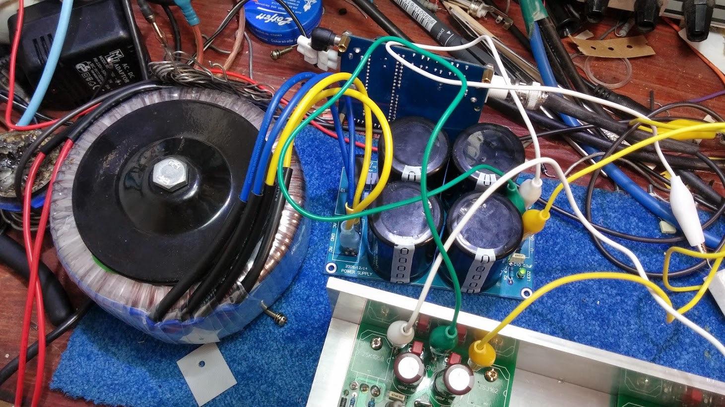

So, I did some measurements, after that I connect amp to proper PSU. Sine at 200 kHz is fine, square at 20 kHz also.. I did some listening, so nice sounding amp, I think with comparison with SKA more bass, more fun 🙂
