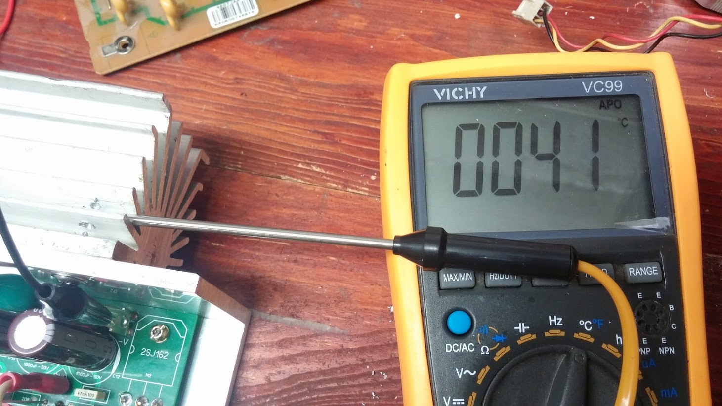

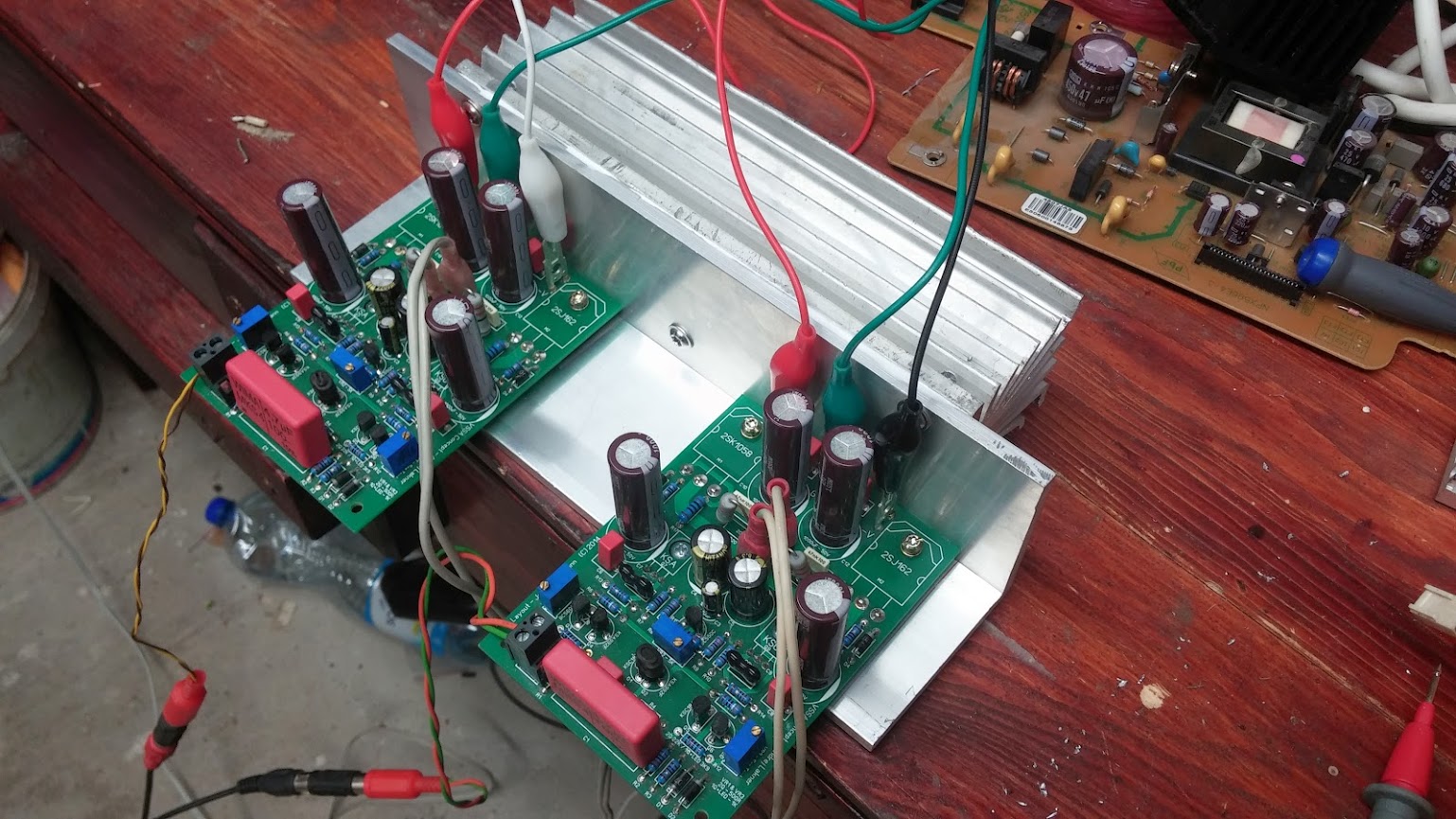

Just for clarify...I just testing my amp with no proper heat sink, using my old TESLA speakers, and CD player with variable output... also is impossible to record how amp sounding.... It´s just youtube info movie.... This is no final product yet..
Just testing both channel.. I also mount bigger heatsink.. Really great sounding amp... I am worried to say loudly, but for me little bit better than SKA 🙂 I like output with only one pair ..... I also tested heatsink temperature, this is after 1 hour very loud listening..

Cool. Of course one can't pass any real judgement via a YouTube video, but those little speakers sounded like they delivered decent bass for their size.
Have you got any plans regarding an enclosure? Do you think this little amp might make it as one of your regularly used pieces of equipment? Just curious. I find I use mine often.

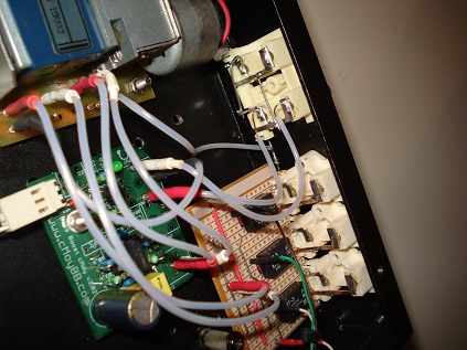

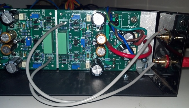

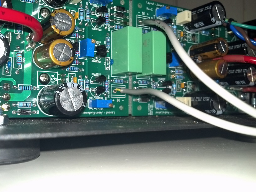

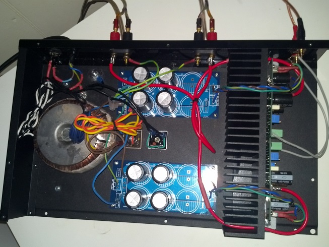

Ground loop buzz
Has anybody else had ground loop problems with the VSSA or similar amp builds?
I'm getting a low tone buzzing sound that is just audible from 3 meters away.
Would really appreciate suggestions on further analysis or a fix.
Now have a star ground lift, RCAs checked so outer casing doesn't contact backplate and soldered a bypass on R3 but buzzing persists albeit not quite as loud.
Thought I had narrowed problem with an initial wire test bypass of R3 as I could get alternate channels quiet. But may have shortened the bypass wire with R2 / D1 or touched some other part...
These are the symptoms:
1. Most buzz with both RCAs plugged in
2. Very minor buzz with only right channel RCA plugged in (can hear from 50 cm)
3. Slight buzz with right channel RCA plugged into left channel
4. Bit louder buzz with left channel RCA plugged into left or right channel (can hear from 1 meter)
5. Also buzzing out of the speaker of channel not plugged in
6. Using a B1 preamp it generated more buzzing as well as a high pitch noise
7. Plugged preamp in to TPA3116D2 chipamp - No audible buzzing
8. Plugged in mobile phone instead of CDP to preamp - buzz remains
9. Preamp RCAs not plugged in - no buzzing
10. Created deliberate ground loop without preamp plugged in (tied RCA L/R in negatives together) - Same buzzing
11. Took ground of preamp circuit to VSSA lifted star ground - more buzzing sound than usual
12. Ground of preamp circuit to chassis of preamp - Same buzzing
13. Preamp circuit ground direct to mains earth - more buzzing than usual
14. Used extension chord to different house wall socket (on different fuse) - same buzzing
15. Ran a wire directly from the RCA ground lug to the star ground - status quo
Cheers, Roger
