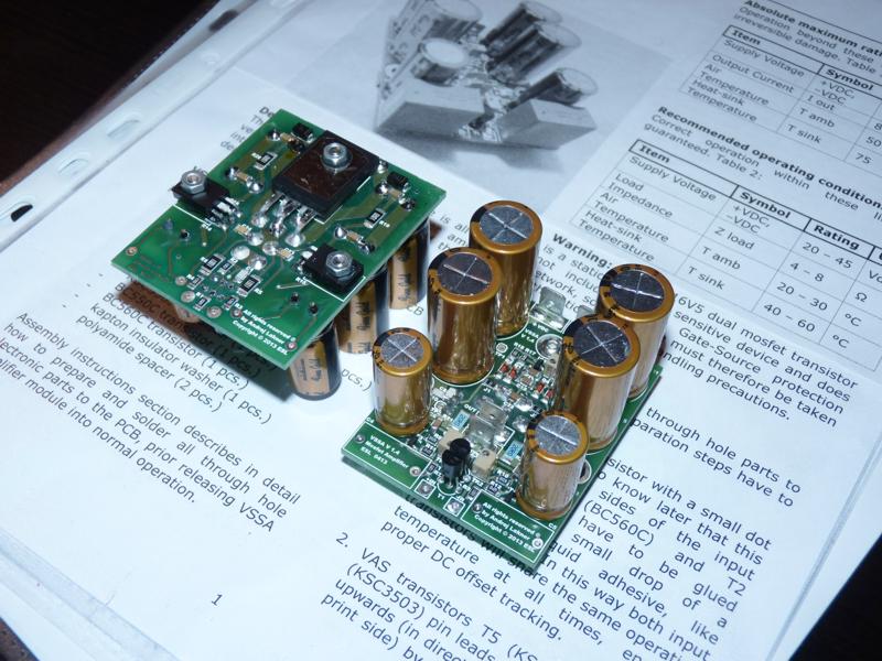

This evening i take little time to solder all transistors and electrolytics. It left 10µf MKT that are on way. For all builder ALF common source and KSC/KSA collector are little ticky to solder due to lane thicness or connecting spad. It's same for 1000µF FG.
Congratulations, Siberia! Any pics to share?
James 🙂

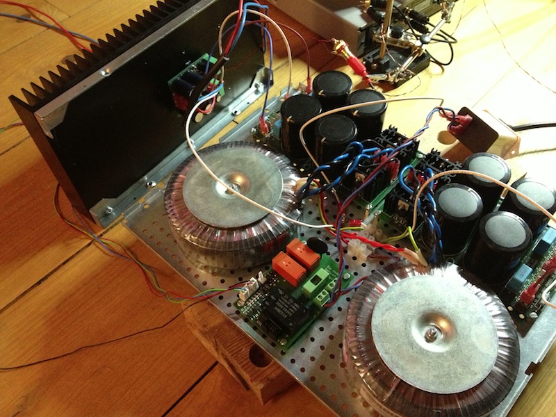

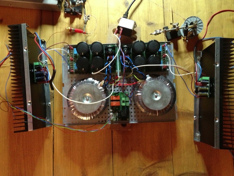

Thanks, James. It's "out of the box" yet, not very presentable. So I hesitated to expose... Picture 3 shows GND node that is not very elegantly solved.
Hi Siberia, it is beautiful and gorgeous.
For the 3 cables, my idea is to split them into 2 portions. All 1st halves clamp to faston terminal. The other halves at unclamp side. Put solder paste and solder them together. Then finish it with big enough heat shrink.
