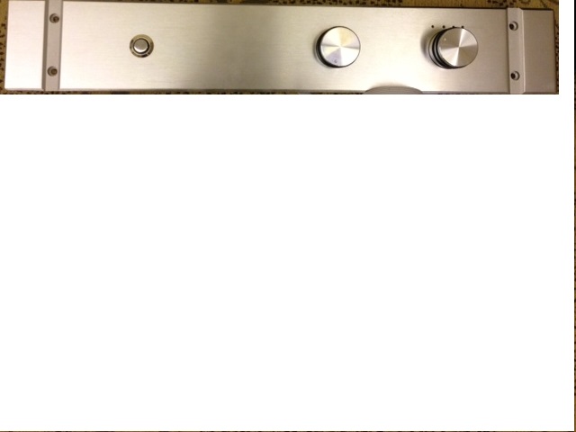

Yes I will power the two channels with one SMPS800RE as of now I powered the 2 channel with linear PS. As far as I know SMPS800RE is not a regulated PS. Am not also an engineer only a hobbyinst. But I would like it compact as I will integrate a B1 buffer inside the case.
Here is my front panel.

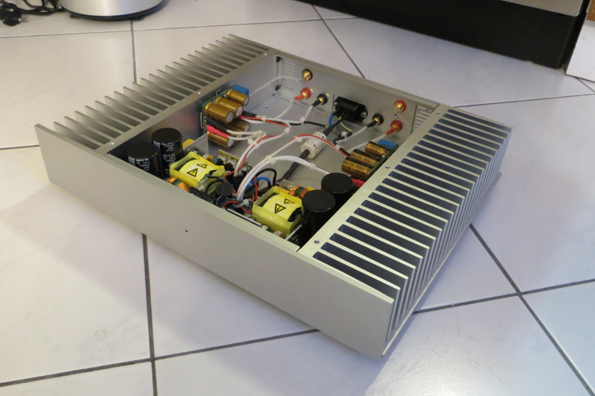

Another VSSA is becoming alive. First half of hour of listening and already very promising...dead quiet, no hum, no hiss, just small green LED 😀
Andrej,
WOW,very nice build.
I realy like your amp case very ordened layout

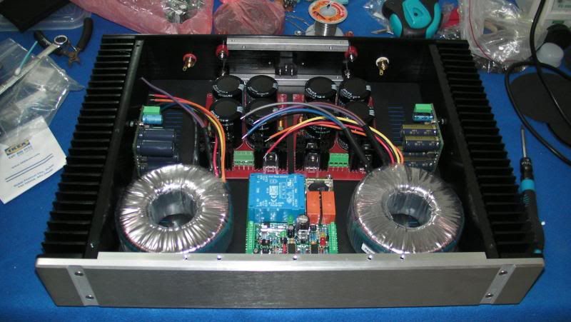

Nice build, Supernet & Presbel!
I am still waiting 10ohm resistors and SMPS. Hopefully everything will be in tomorrow then can do OT during weekend!😀

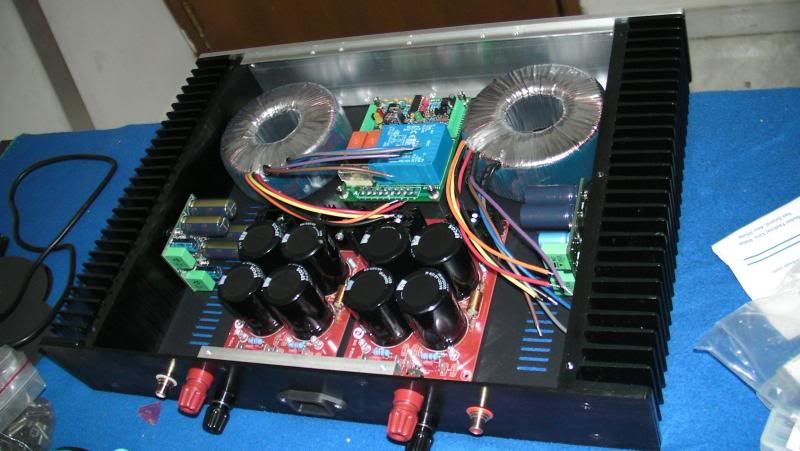

This is my VSSA unit
Wow,Maybe is the angle of picture, but those terminals look way too close to those caps. Do you have enough room to connect power to those terminals?

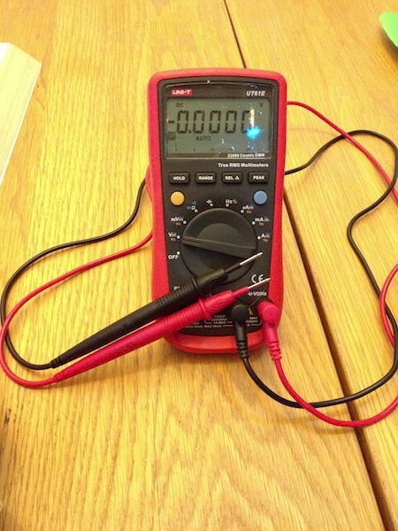

Now the power supply is done, the trafo is center tapped and PS is symmetrical + and -37V rails. 37V because still not under stress... VSSA is still not wanting to run. 60mV... drop across 22Ohm. What should I check then? Why should VSSA not run with voltage connected?
A little shout out to vgeorge, who has reccommened me a DMM here present on my table and in the attached pic. Thanks! I made a fresh measurement with it on both modules across T1 & T2. After they've been on for two hours. 138mV and 141mV. Is that appropriate?
Hi Renio, please very short answers to next Q:Now the power supply is done, the trafo is center tapped and PS is symmetrical + and -37V rails. 37V because still not under stress... VSSA is still not wanting to run. 60mV... drop across 22Ohm. What should I check then? Why should VSSA not run with voltage connected?
1. What is the voltage between TP1 and TP2?
2. What is the voltage between TP1 and GND?
3. Measure R19, R20 if they are 10 Ohm OK, if not replace them with Farnell - MCPWR10FTFQ0100 chip resistor 😉
Is this voltage between TP1 and TP2? If yes, than OK. 😉A little shout out to vgeorge, who has reccommened me a DMM here present on my table and in the attached pic. Thanks! I made a fresh measurement with it on both modules across T1 & T2. After they've been on for two hours. 138mV and 141mV. Is that appropriate?
Guys please be very exact for the answers, otherwise we get a lot of posts for clarifying one simple issue.

1. What is the voltage between TP1 and TP2? - 0mV
2. What is the voltage between TP1 and GND? - 35,7V (0,5V lower than DC)
3. Measure R19, R20 if they are 10 Ohm OK - they're OK

Your measurement showed that your VAS bias current is 0 mA.1. What is the voltage between TP1 and TP2? - 0mV
Now rotate TR1, TR2 to get 120 mV between TP1-TP2, TP3-TP4 (meaning 12 mA VAS bias) and 0 mV DC offset between OUT and GND. 😉
Please check if T1 is BC560C (PNP), T2 is BC550C (NPN), T5 is KSA1381 (PNP), T6 is KSC3503 (NPN). Try to measure also another VSSA channel if it respond to TR1, TR2 rotation.
Also measure voltage drop on these resistors:
- R3, R4 is 0,1 V
- R5, R6 is 0,65 V
- R7, R8 is 15,6 V
- R3, R4 is 0,1 V
- R5, R6 is 0,65 V
- R7, R8 is 15,6 V
