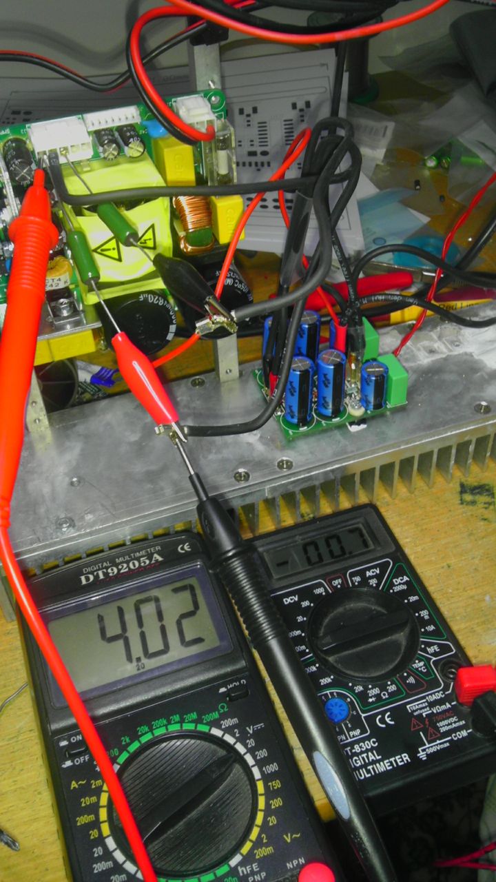

It's direct coupled. But there was not significant DC component on the output (2-3 mV) at the time. If you didn't notice there is already 10R smd between input ground lead and ground(speaker gnd and power gnd) on the pcb. What concerns me is that a few minutes after switching on, the resistors in a branch with diodes burn out. In left channel even 10R of the driver transistor(s) burn out.
Miksi, one channel at the time. First connection as per installation instructions via 22 Ohm, than zero offset, VAS bias, output bias (input short circued). Both channels calibration in this way. If OK, stable DC conditions, than we will discuss grounding issue.

There was nothing wrong during initial calibration, everything went smooth for both channels. Modules was already mounted on heatsinks. Problems came after connecting with the DAC. I've measured DC it was OK and few minutes after DC apeared (about 2-3 volts) on left channel. I suspected input pair but it was R20, replaced it, calibrate again DC below 1mV, on 22 ohm resistor 4,00 volts by trimer TR3. Between TP1 and TP2 122mV, checked one of the jfet current it was 2,67mA. After couple of minutes DC apeared again and this time it was R16 10 ohm. Replaced this one also. All the time right channel was OK.
Then during hum and buzz troubleshoot, on the right channel DC apeared and after that I saw little flash(heard it too). It was R19. I will replaced this one later. But beyond that 😕.

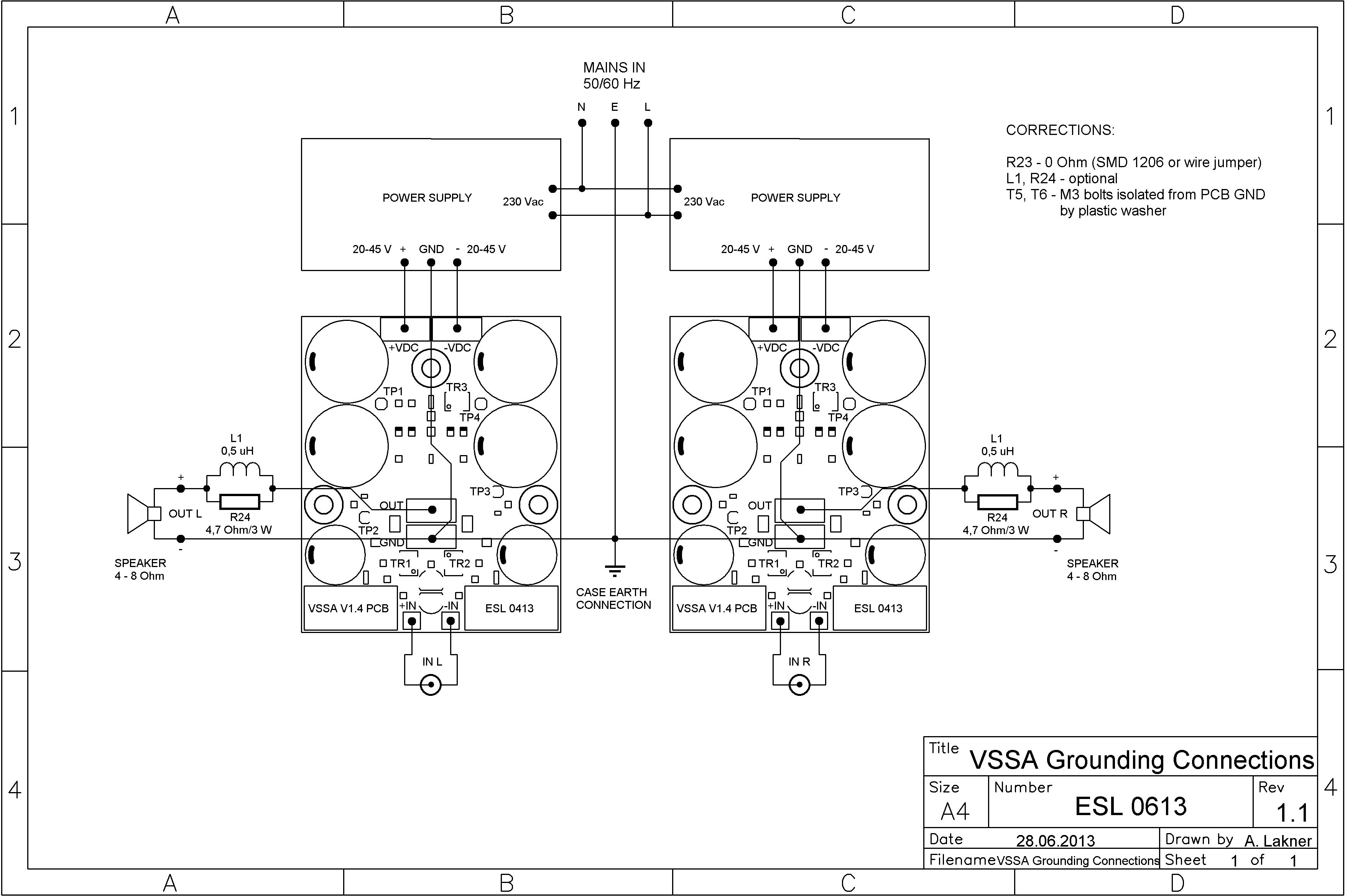

Miksi please step by step. First make both channels to work normally as guided by installation manual, meaning all DC and bias conditions are OK.
Than I will give you info abot grounding.
Please also check output conditions of your DAC/preamp that there is no DC present.
Burn out 10 Ohm VAS emiter resistor indicates too much DC at the input or that one of input BJT is broken (C-E shorted).

Ok, R19 replaced and (for now) both channels are stable with DC about 1mV and voltage across 22ohm of 4 V. Driver current about 12mA, jfet current about 2.7mA. Tested for couple of hours. Only alu box is connected to safety earth lead, the rest is floating. Hypex supplies are connected thru one of their montage holes to the box. Driver transistors holes are also isolated from alu box.
DAC output Lch -0.7mV, Rch 0.1mV.
What is left to do is proper grounding to eliminate hum and buzz.
