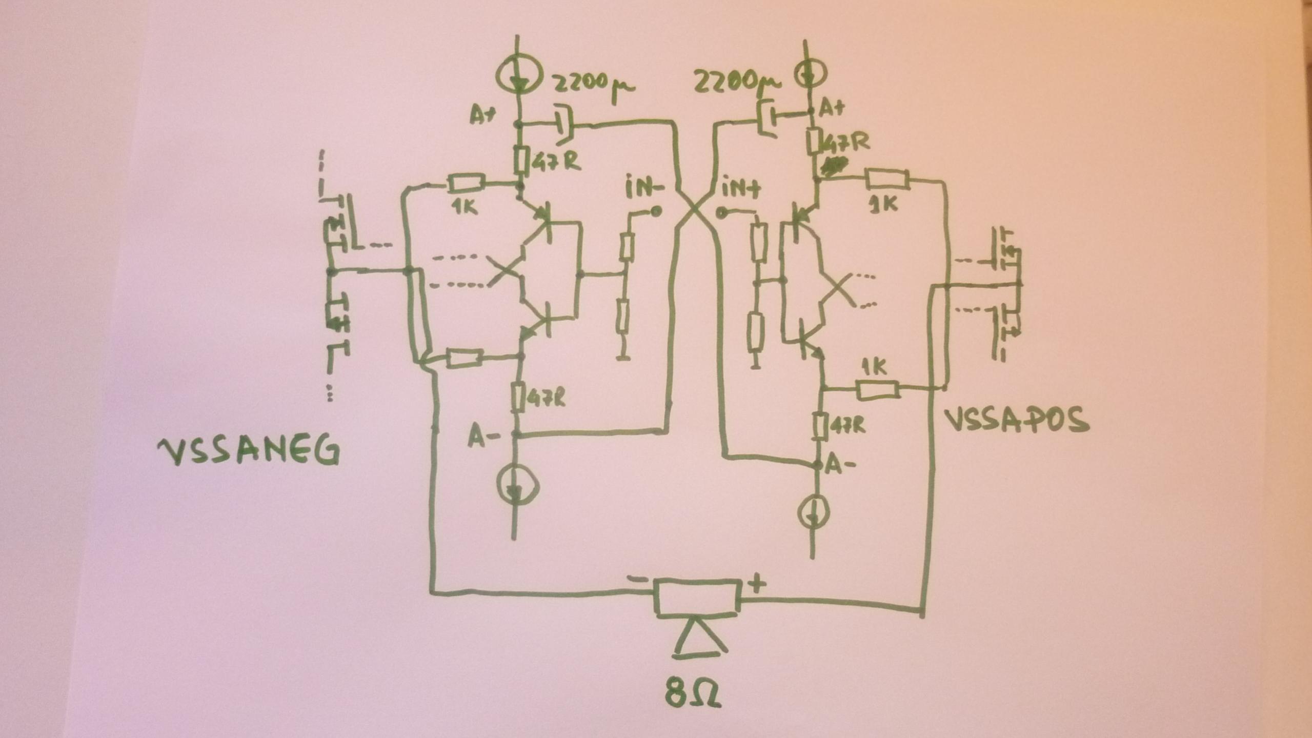

Hi Andrej and diyAudio fellows.
Well, I still have to finish my JC-80 preamp until diving into VSSA build (shame shame shame), but having a non-productive day (with less power to solder and more to enjoy a seldom sunny day) I had something on my mind.
I was always impressed by the symmetry in LC's projects; I will have a JC-80 line amp, that offers a ballanced output; I have 8 Ohms power hungry loudspeakers. I have good feelings about simulations, anyway, I have no simulation programs installed, and more shamefully, I have no Schematic capture/PCB software installed 🙂
I was thinking first to use 2 VSSA modules bridged, with a phase invertor that can deliver out of phase signal to one of the modules. This can be a solution, but it ruins the symmetry.
I am now thinking of a balanced (X)VSSA, that could use the simplicity of this design and the output of JC-80. Of course, this is just a rough idea, and I tried to cover it in the attached picture.
Basically, I think that instead of running the ElCaps to the ground in the feedback nodes, we can maybe "X" them between two VSSA modules, so they will become a true balanced unit.
I am interested to learn if this looks valid and realistic. I thought I will better share this idea, because LC or somebody else can validate/improve it either by building or by simulation before it will reach my soldering iron - or other way of saying, rusting for years in my brain 🙂
Cheers!
P.S.: I will build the VSSA anyway in the next month, as I am sure it will be a major step forward, but I need to have a future next project 🙂
