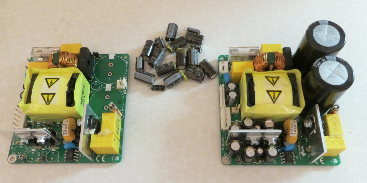

Good job supernet, all SMPS's elcos replaced, VSSA will rock.Hypex PSU transformation 😀
Panasonic EE and FM capacitors already in place...

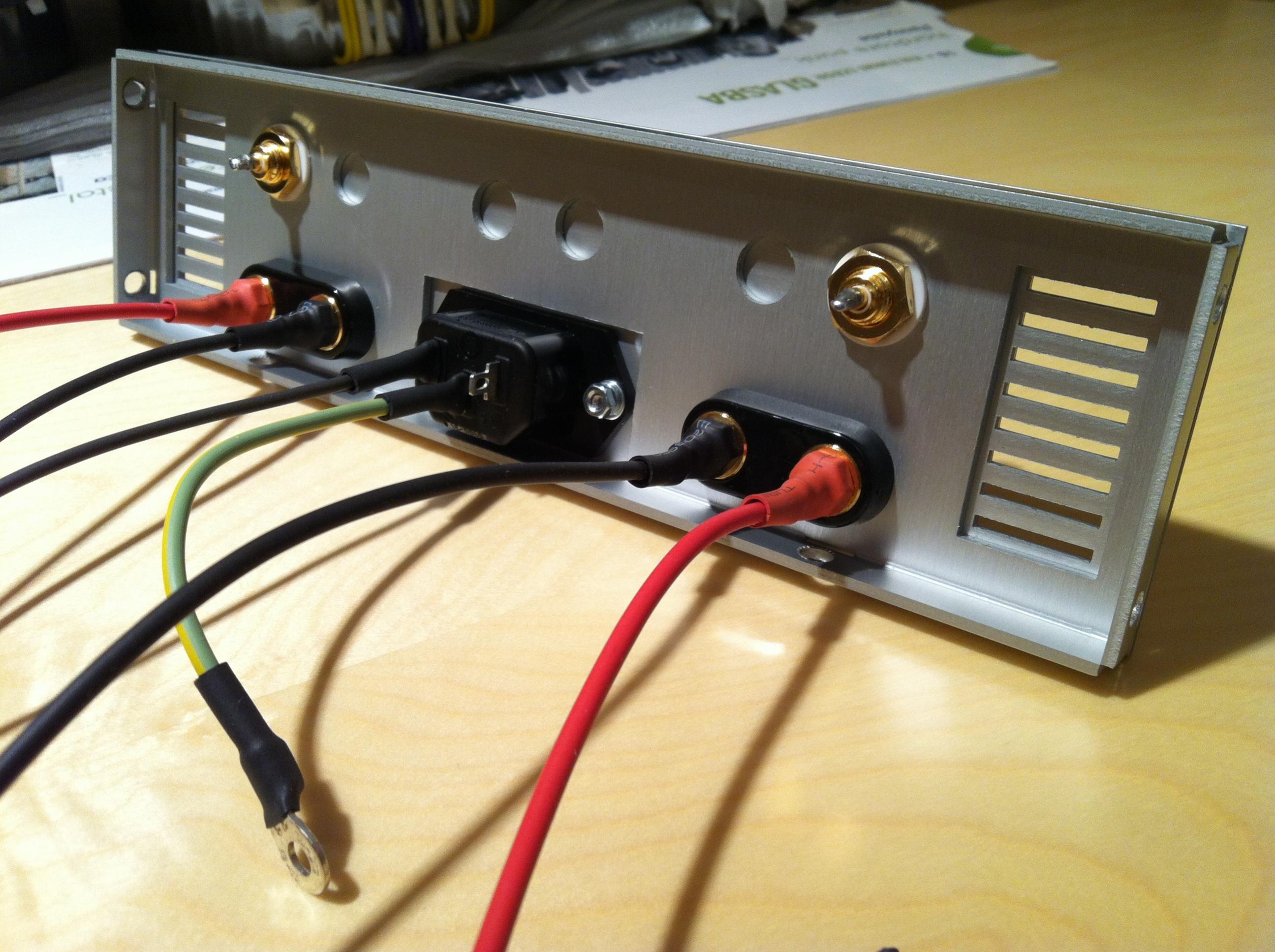

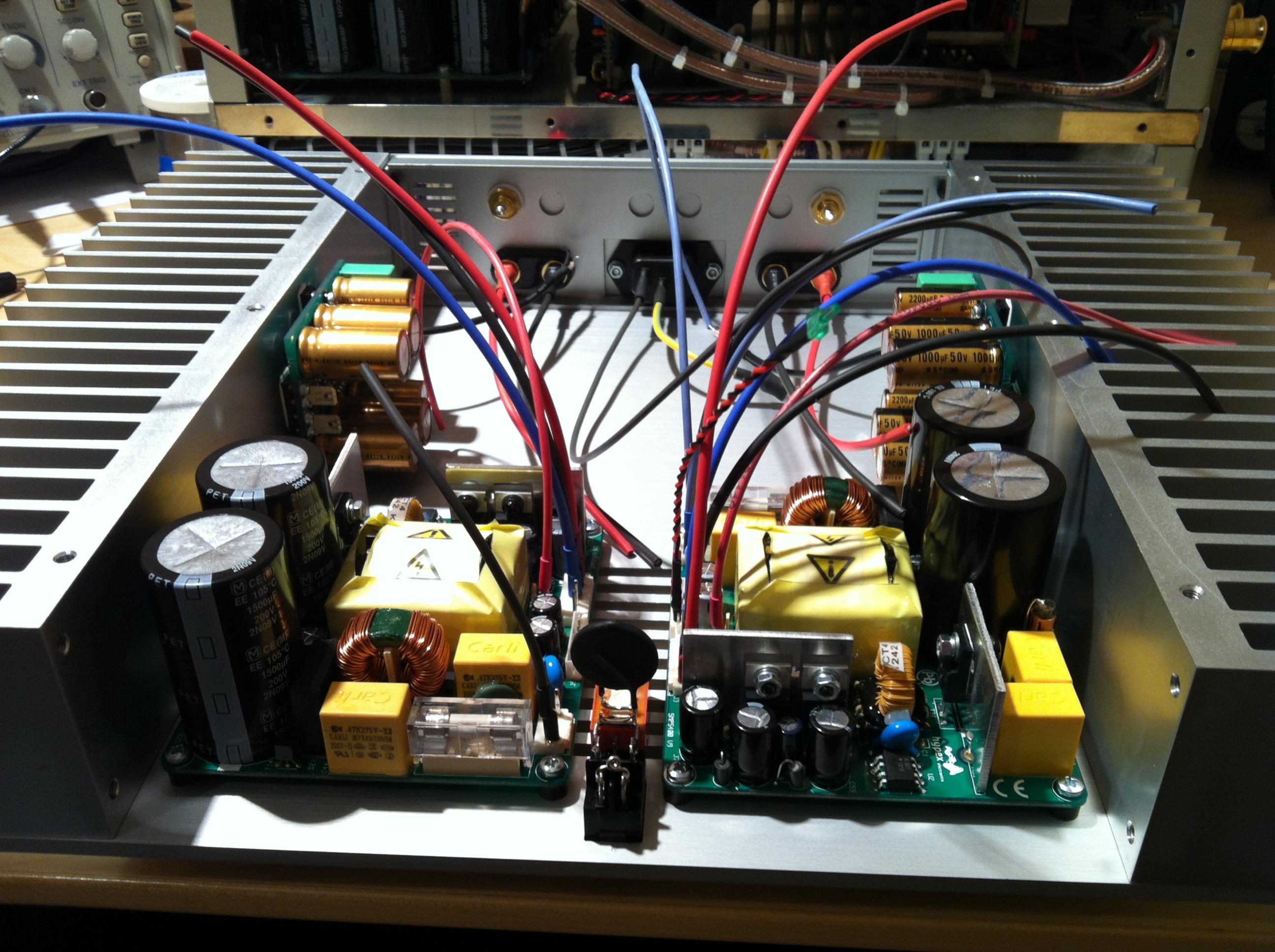

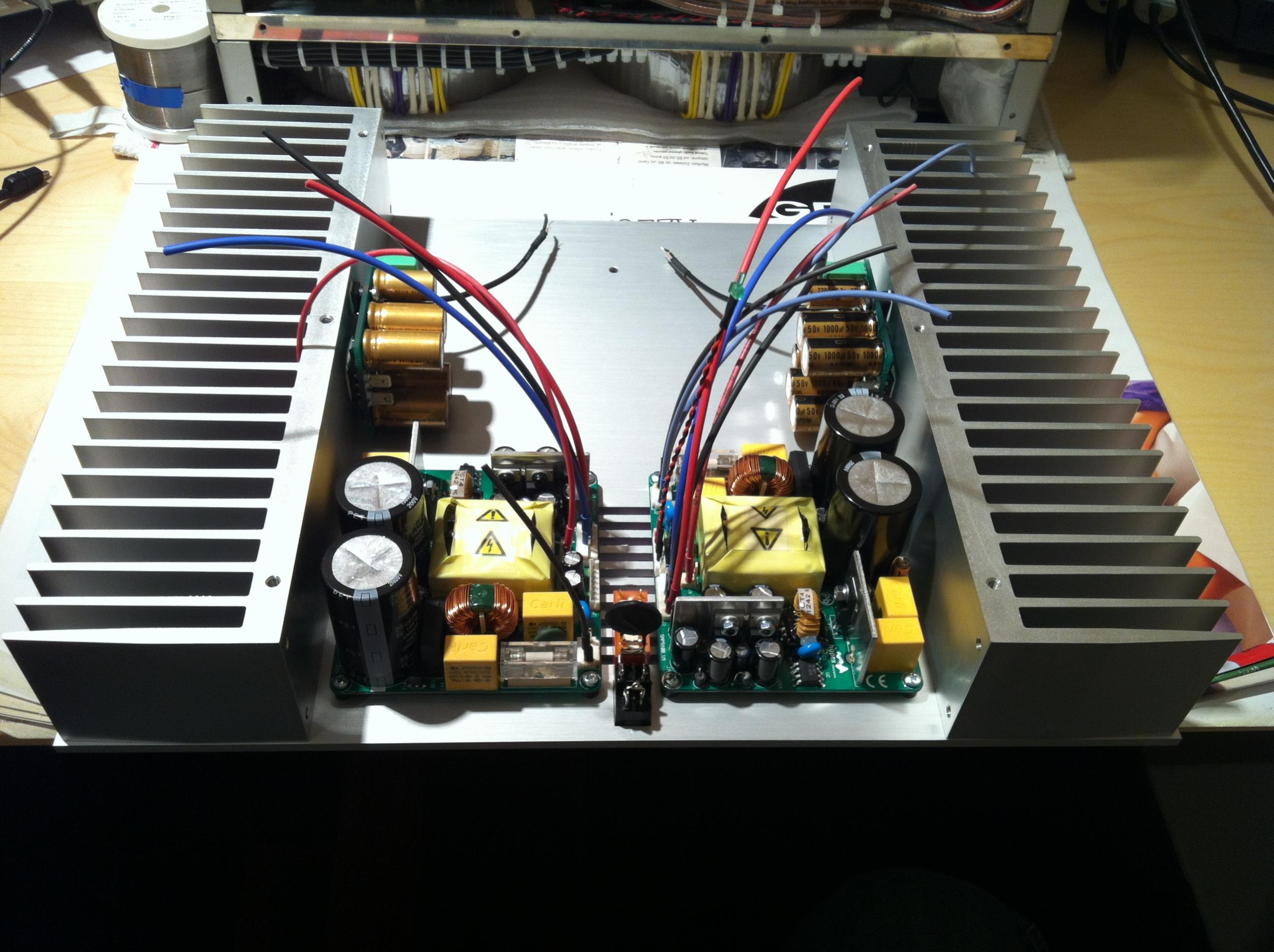

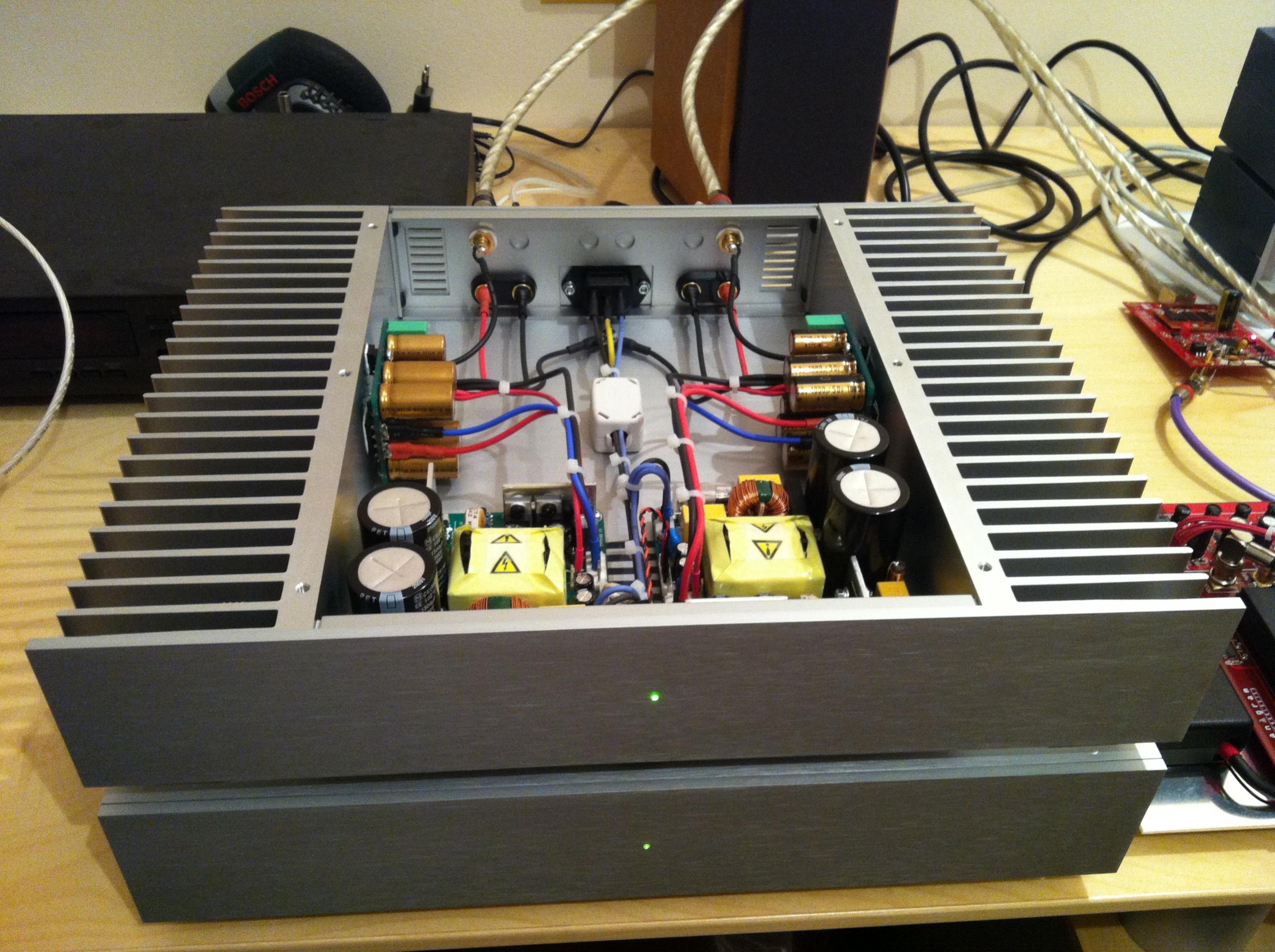

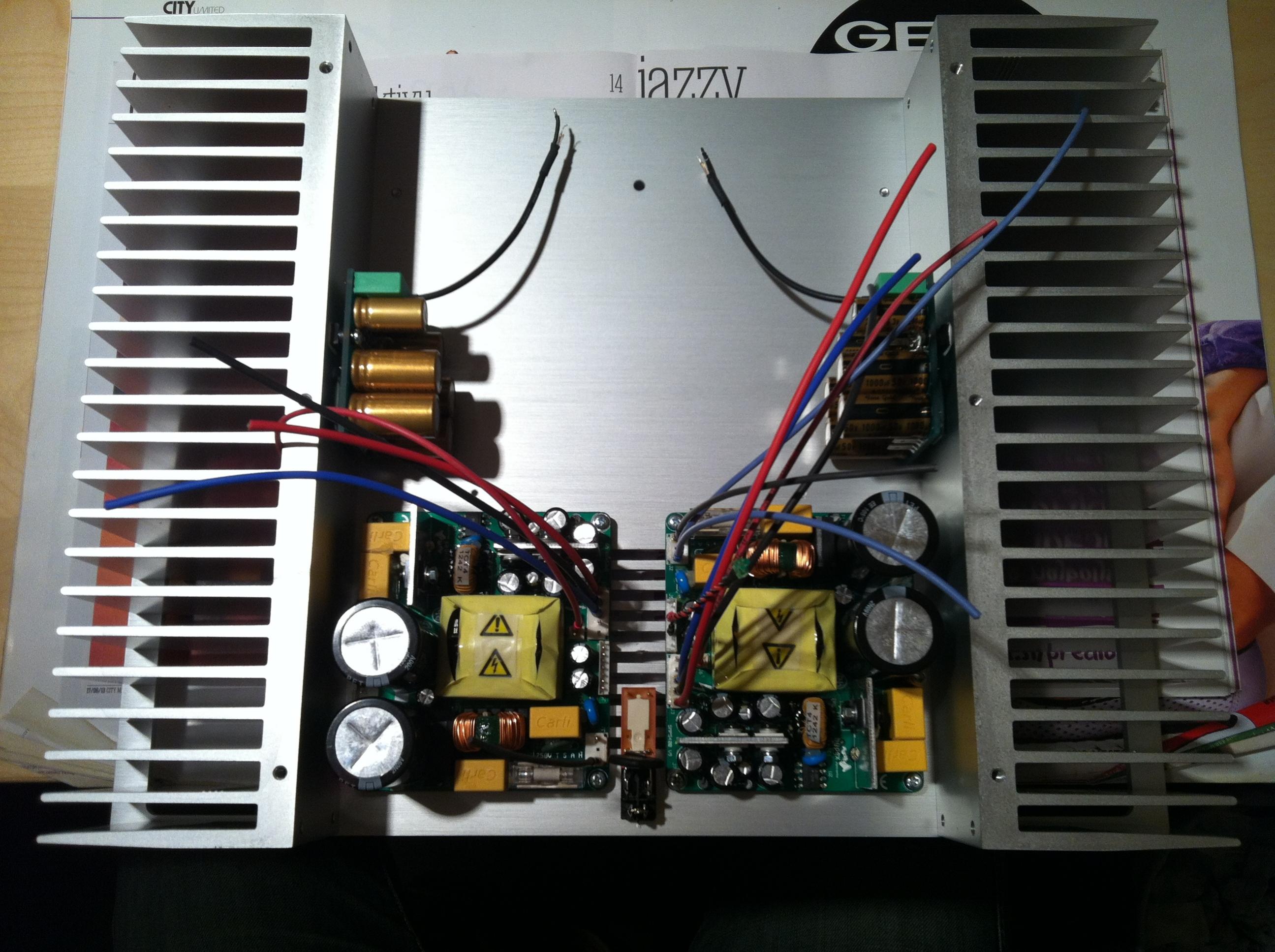

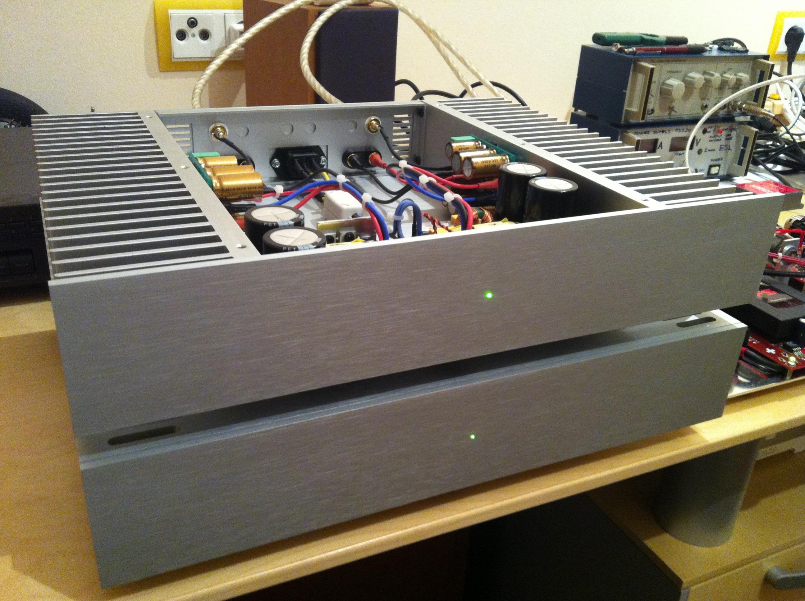

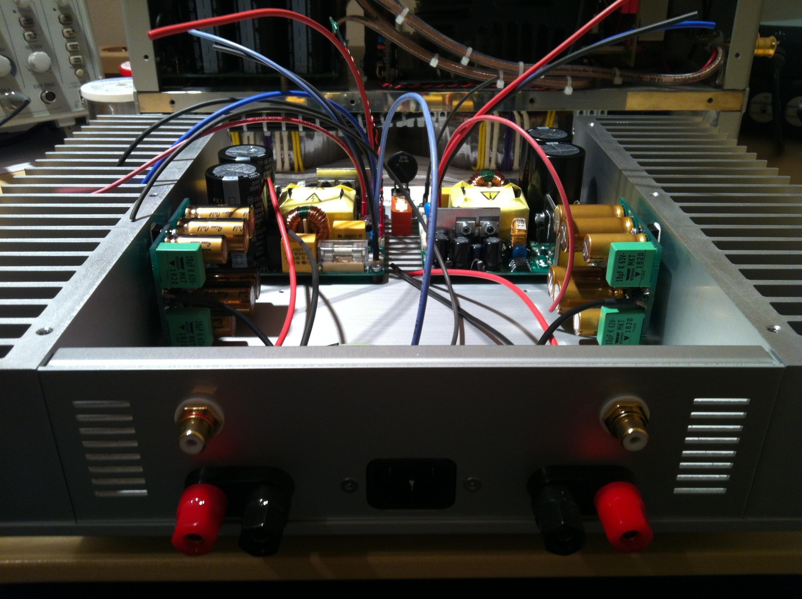

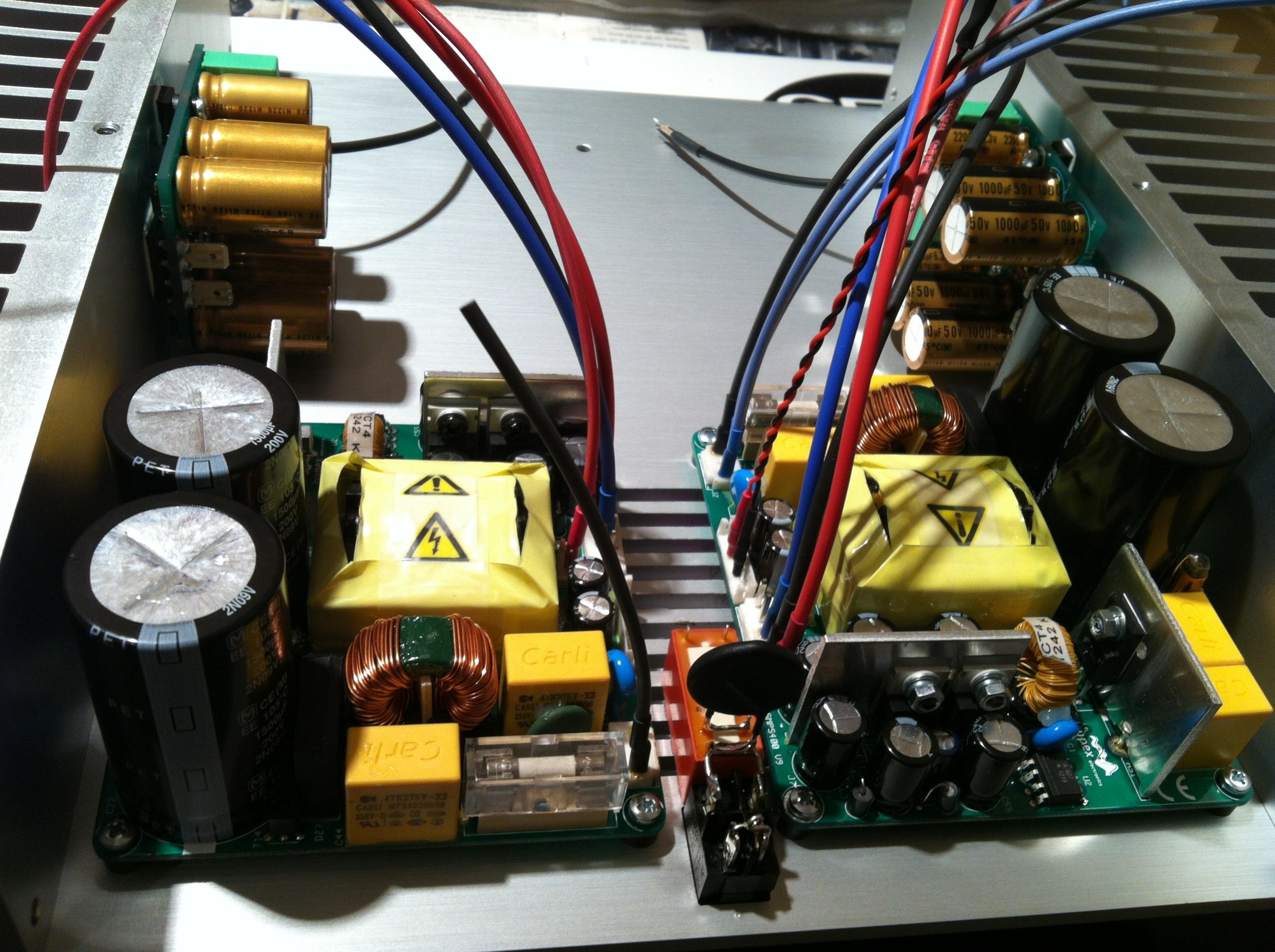

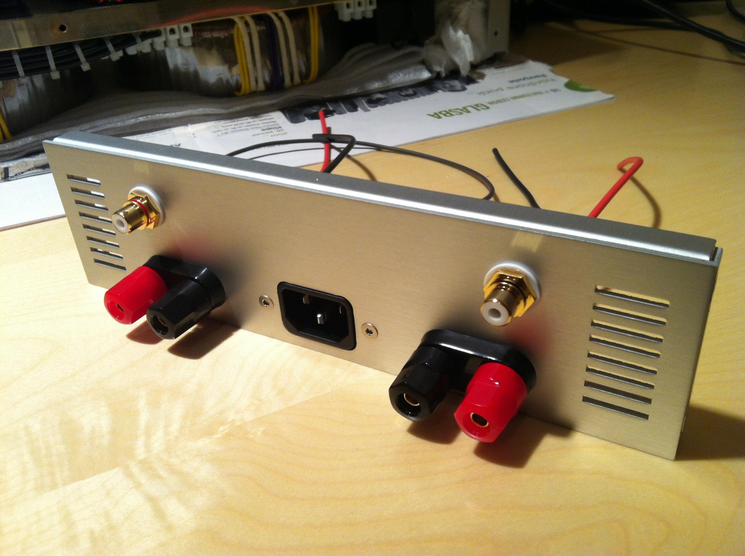

Since we are in vendors forum I'll go full blast on VSSA marketing and therefore promote new Alu-chassis made especially for VSSA and SMPS400A180 modules in dual mono configuration. Here are some pictures of a second VSSA amplifier assembled, from now on with official commercial name Lakner Oné The most transparent amplifier 😀
Few more pics clearly shows how to assemble all pieces together into final product. This one was ordered by local Hi-Fi shop, after heard VSSA demo version they simply cannot forget the VSSA sound signature, which is none. Let me just say that they housed some Clase, Cambridge, Naim and NAD amplification.
