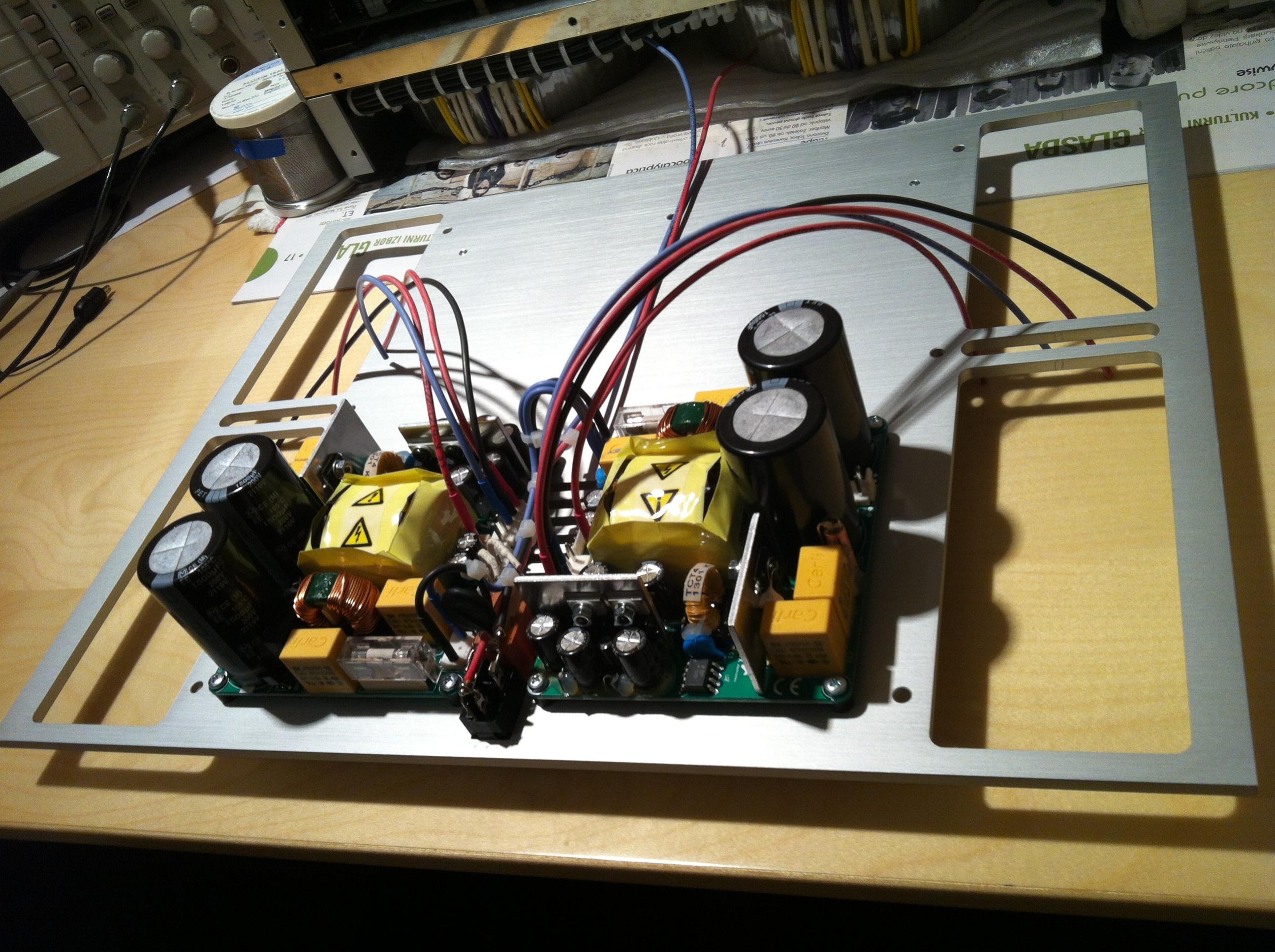

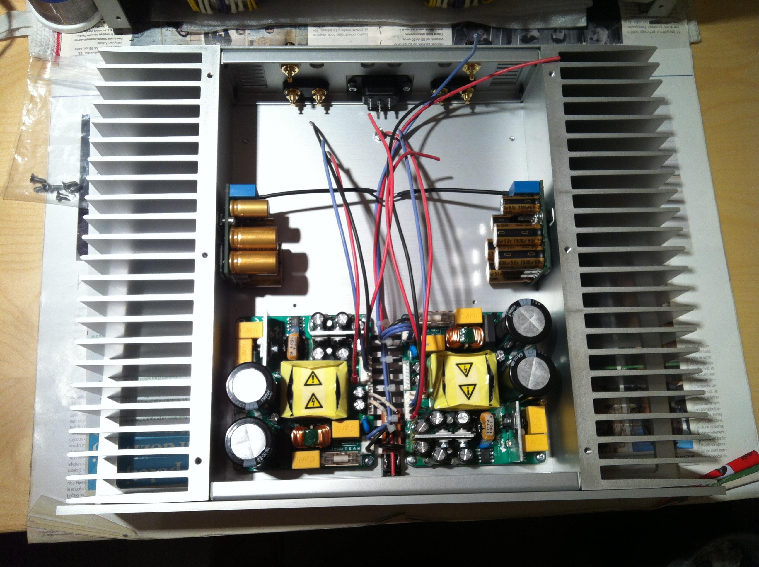

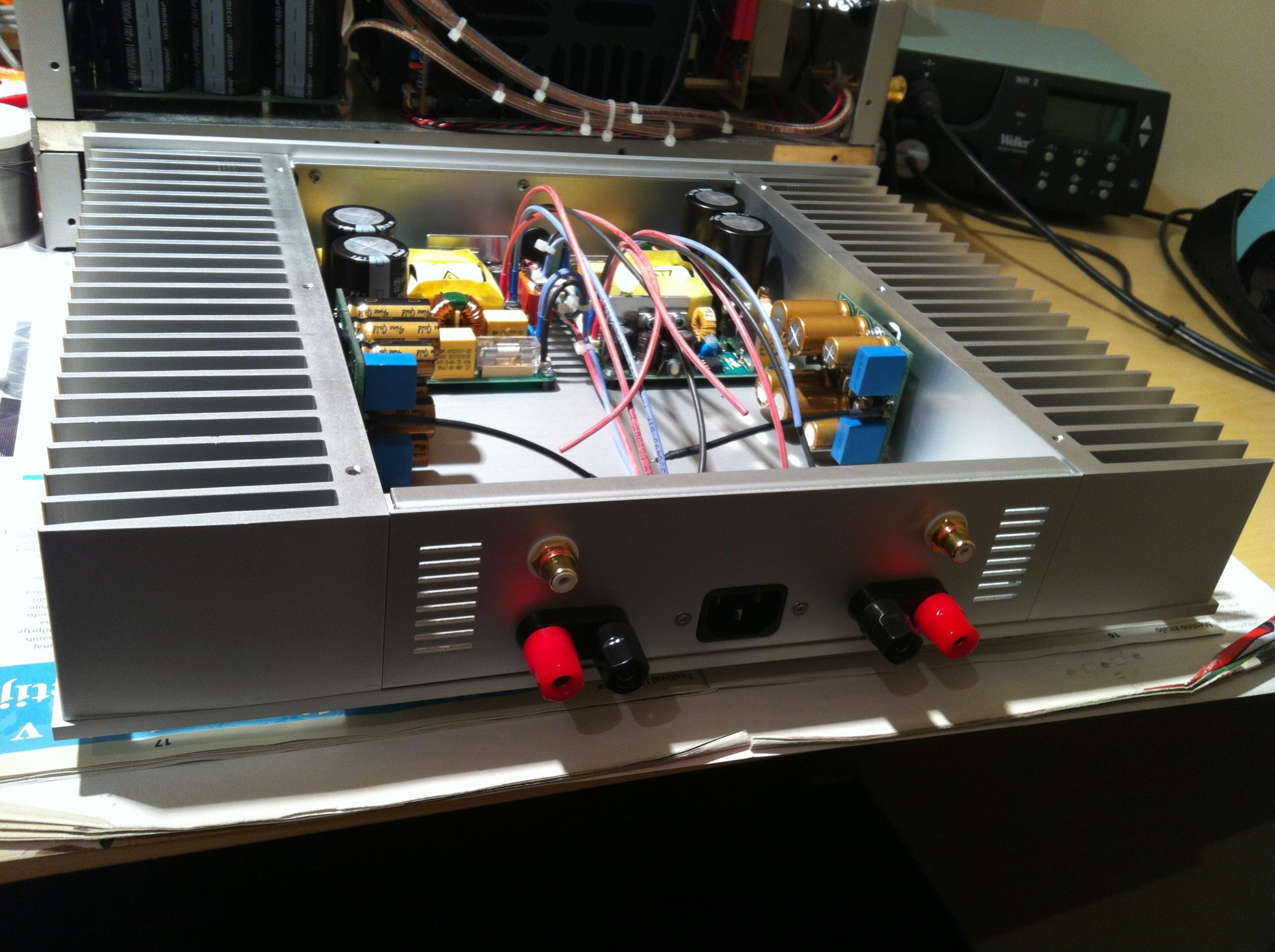

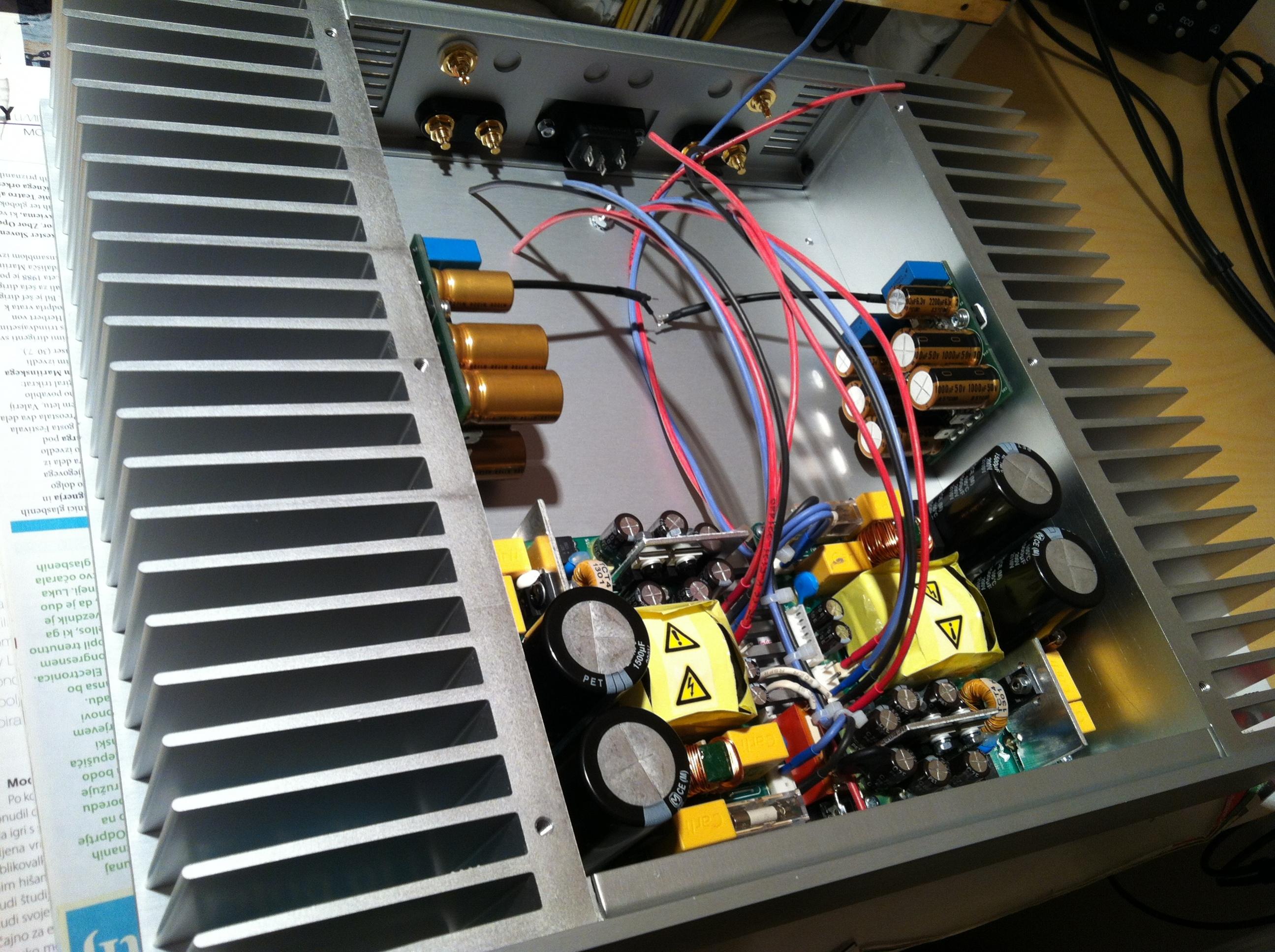

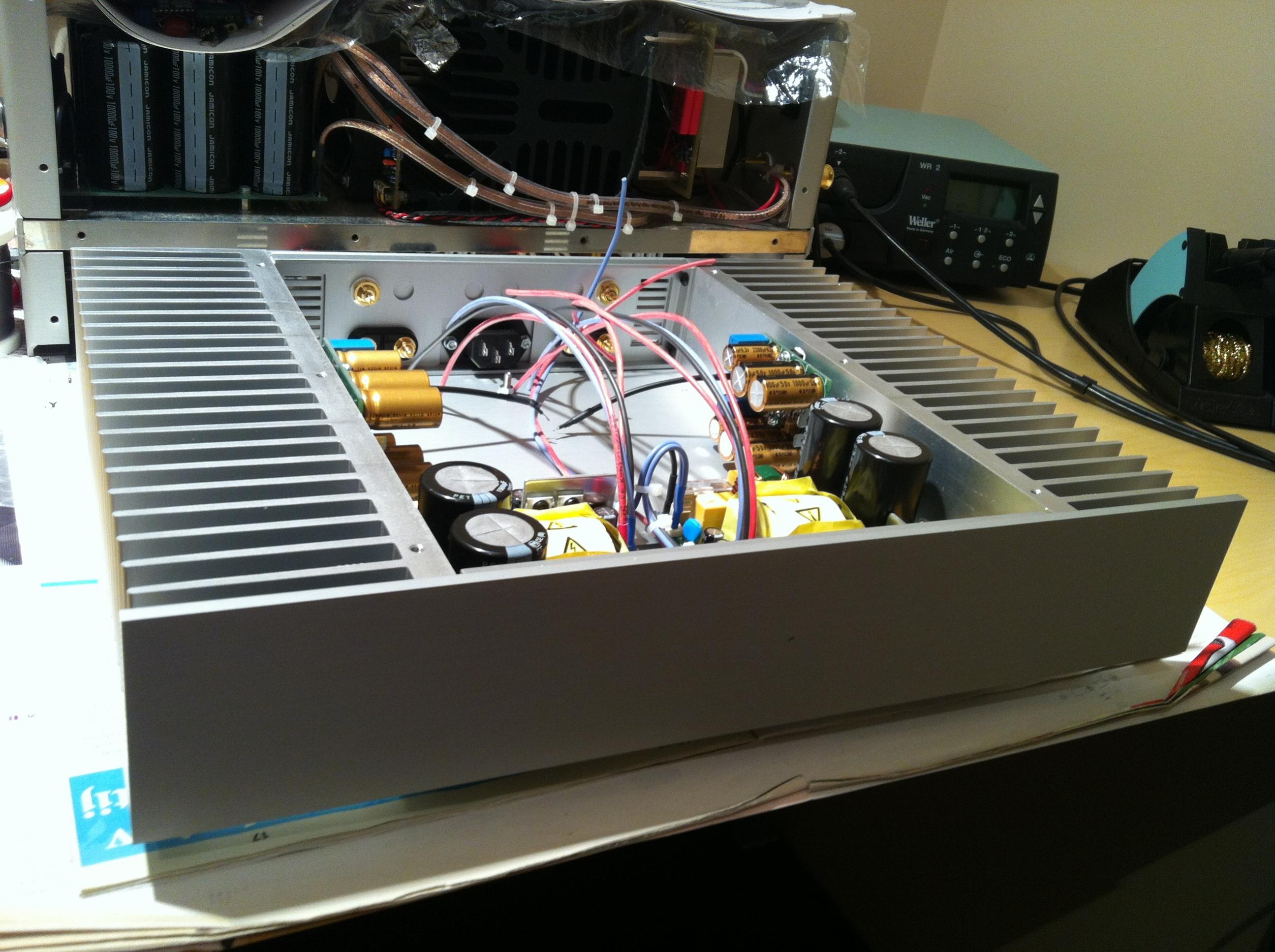

Few pics of a new VSSA case, dual mono design with SMPS400A180 naturally. 🙂
