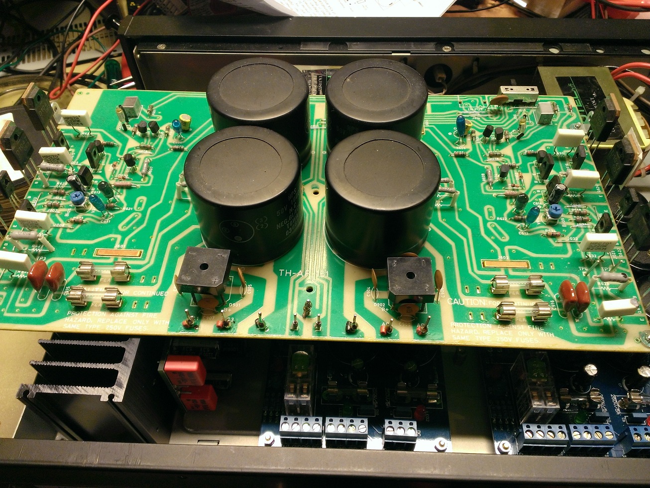

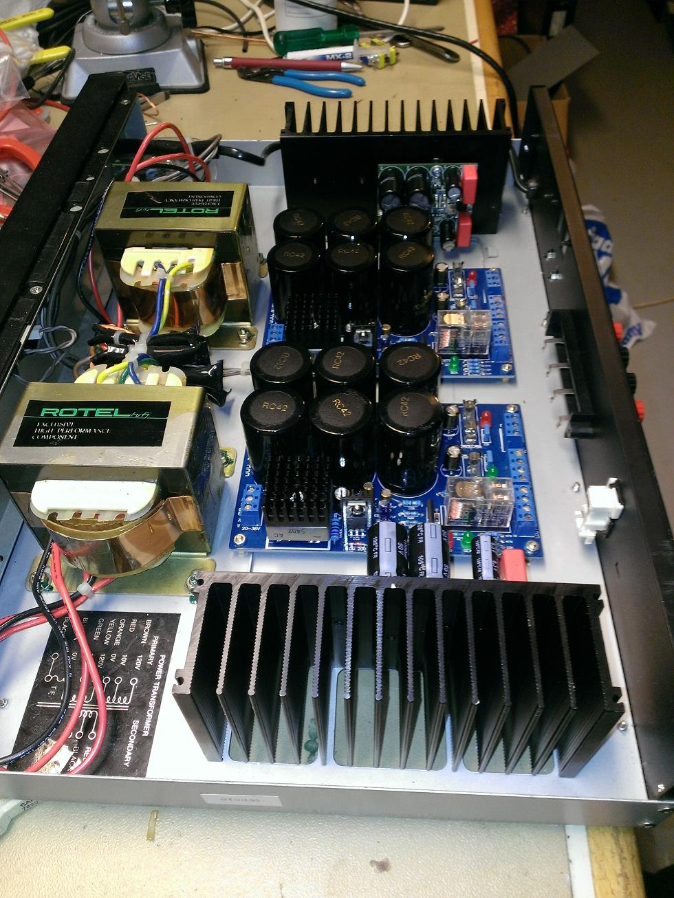

Actually, this Rotel chassi is from 1 of 2 Rotel RB-850 that I and my father bought brand new in the eighties. Number 2 of 2 is original and will stay that way.

Just dismantled for VSSA use. The original PCB is intact, fully functional and will be saved.

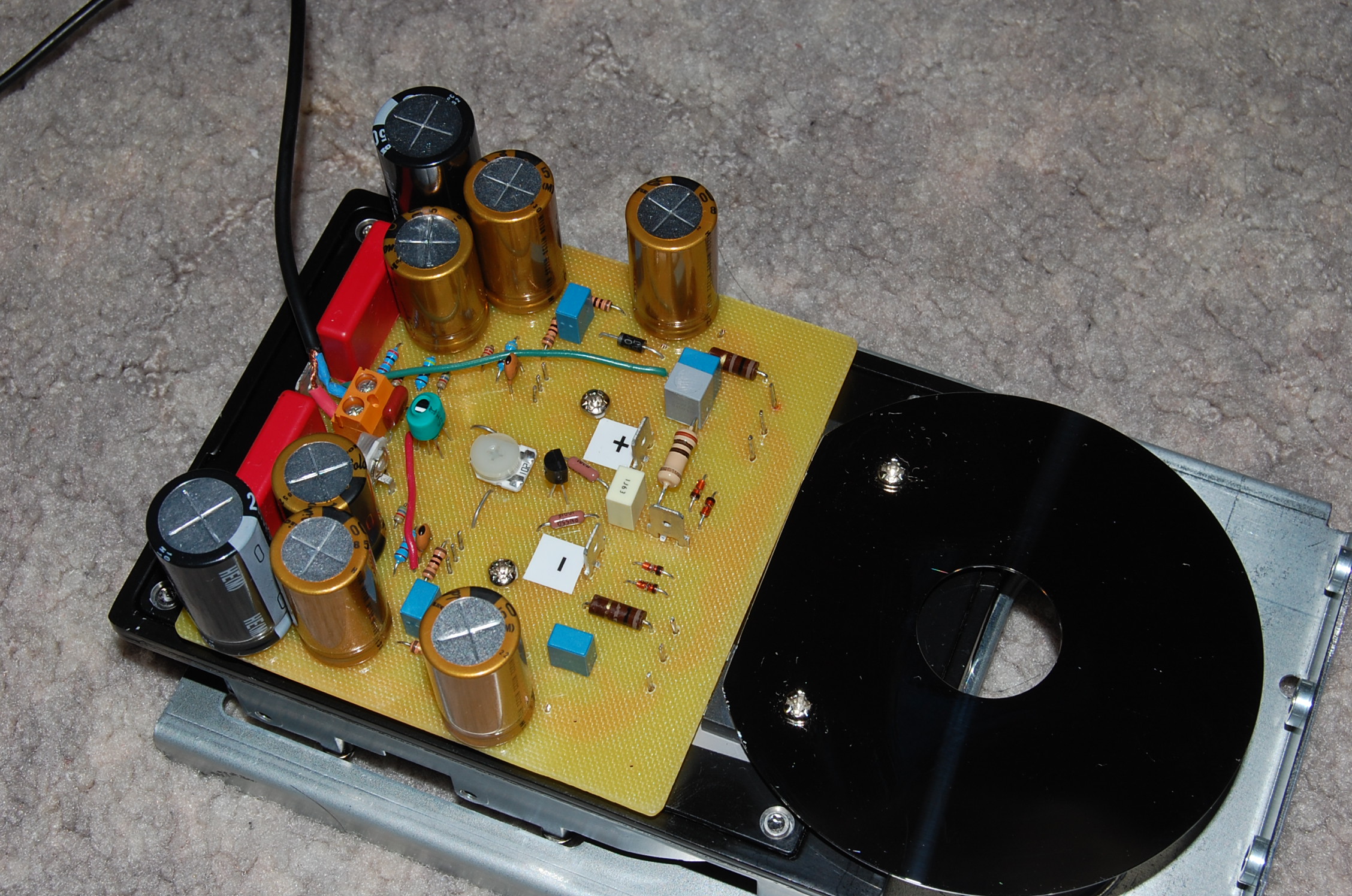

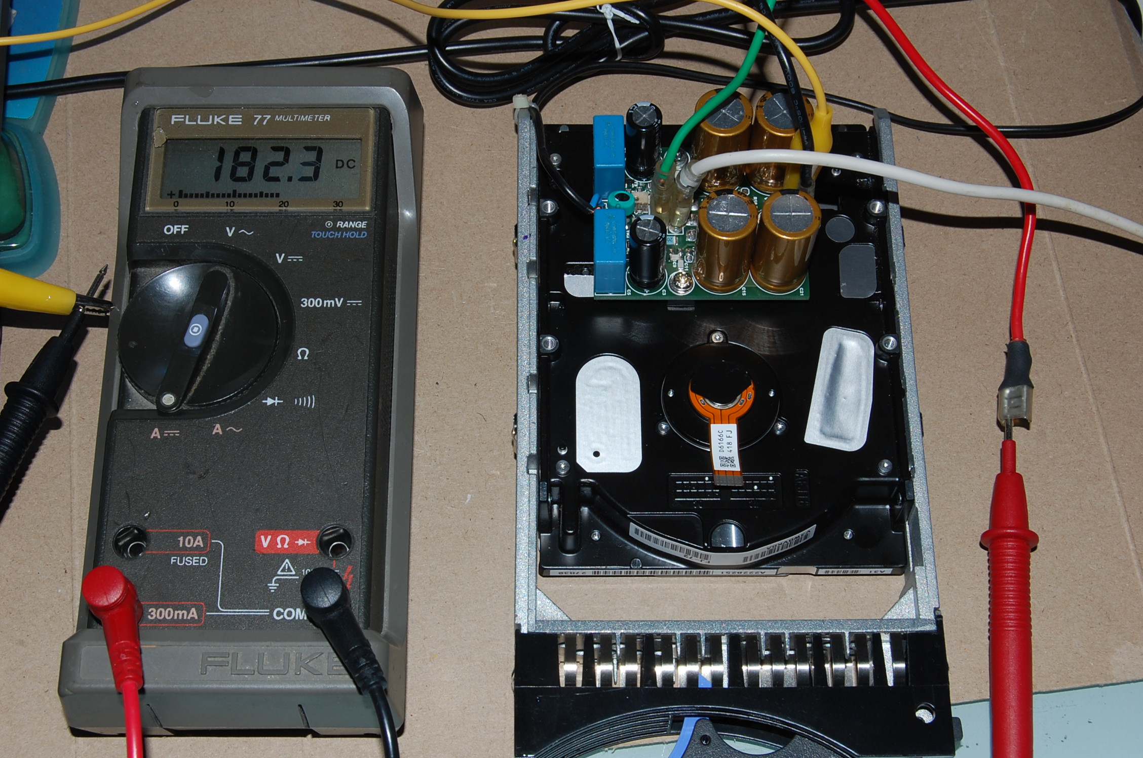

Last night I assembled one channel of VSSA and I mounted onto a temporary heatsink (an old hard disk). I set the +ve supply current to 182mA and the heatsink is quite warm at 53C.
I listen to this channel for the whole day, and what can I say - this is the best amplifier that I have listened in my home. I always like the sound signature of Mosfet amplifier and I found that they sound sweet & musical. I have DIY a few MOSFET amplifiers and my old favourite WAS the Sigma from Dr. Bora.
I even make my own version of VSSA v1.4 using thru-hole components & Renesas 2SJ162/K1058 (PCB size = 100 x 90mm).
LC version is just better than all of them - absolute clarity in mid-range & treble plus controlled bass. The PCB is very compact & it can be fitted anywhere and LC has not wasted one mm space on this layout. Many thanks to LC who brings us this little beauty.

Congratulate sng001, you're the first GB member turning "on" the VSSA amp and make it sing the music.
What speakers will be connected to? Did you have some troubles calibrating the VSSA according to instructions? Was it a quick procedure? VAS bias current and DC offset OK? Why not Nichicon FG for feedback too?

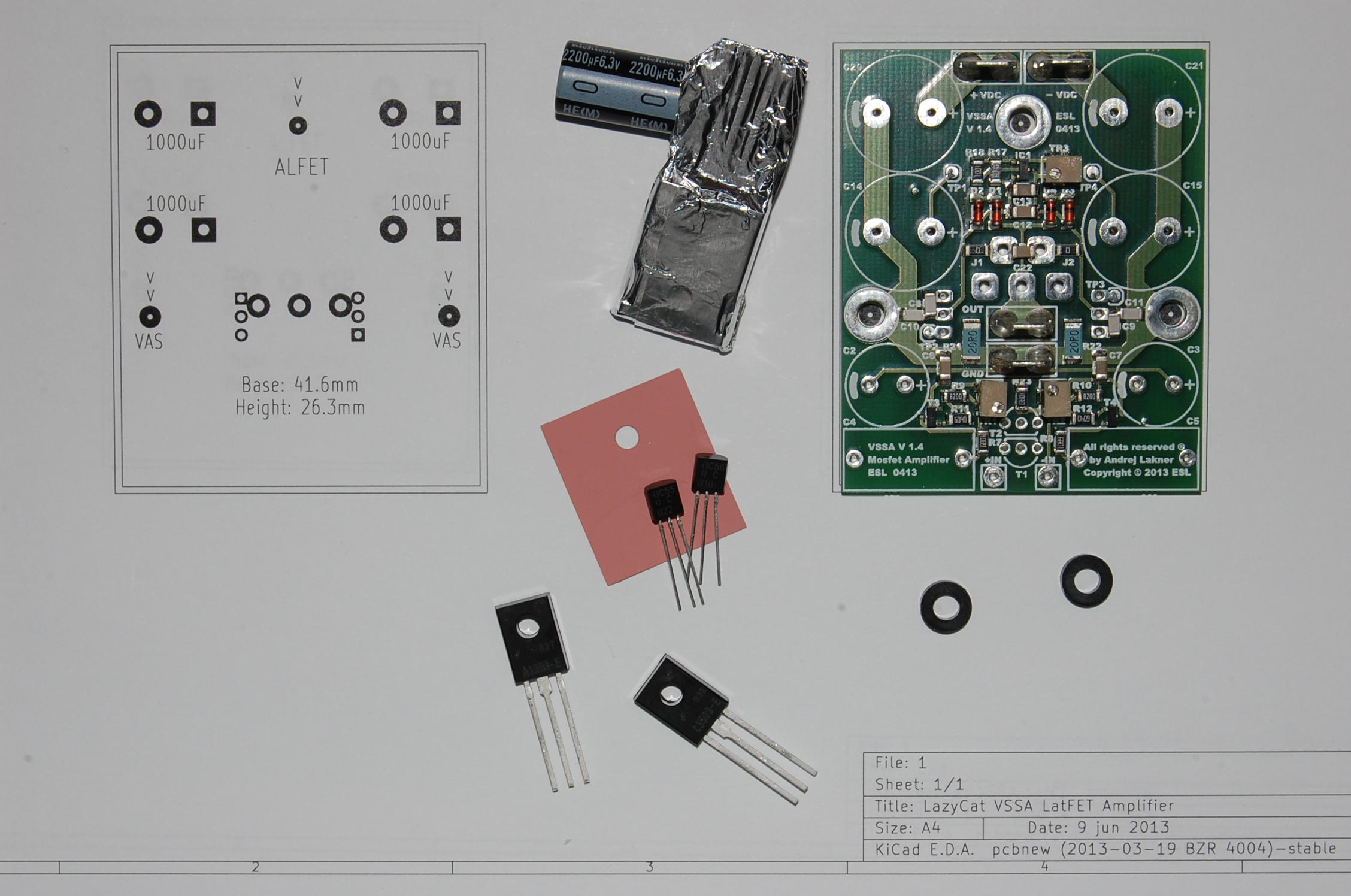

Now how will you solder ALF-s if all ELCO-s are in place already? I think in assembly instructions transistors preceed capacitors. 🙄
Otherwise nice built.
