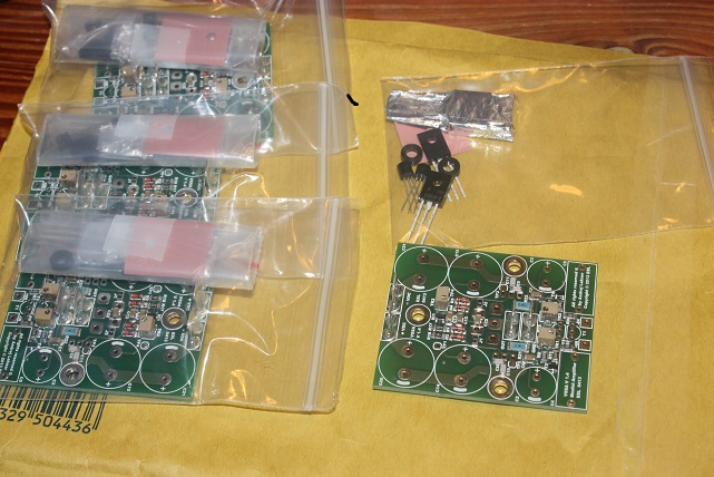

I got the package few days back, can't be more happy than holding the PCBs in my hand. I see you have foil wrapped the ALF FET, how to handle this before soldering it on the board? Should I use grounding wrist strap to avoid ESD damage? or not needed.
With the quality of the assembly, I wish I choose to get the remaining semiconductors soldered by you/your team. My soldering skills are no where near 🙁

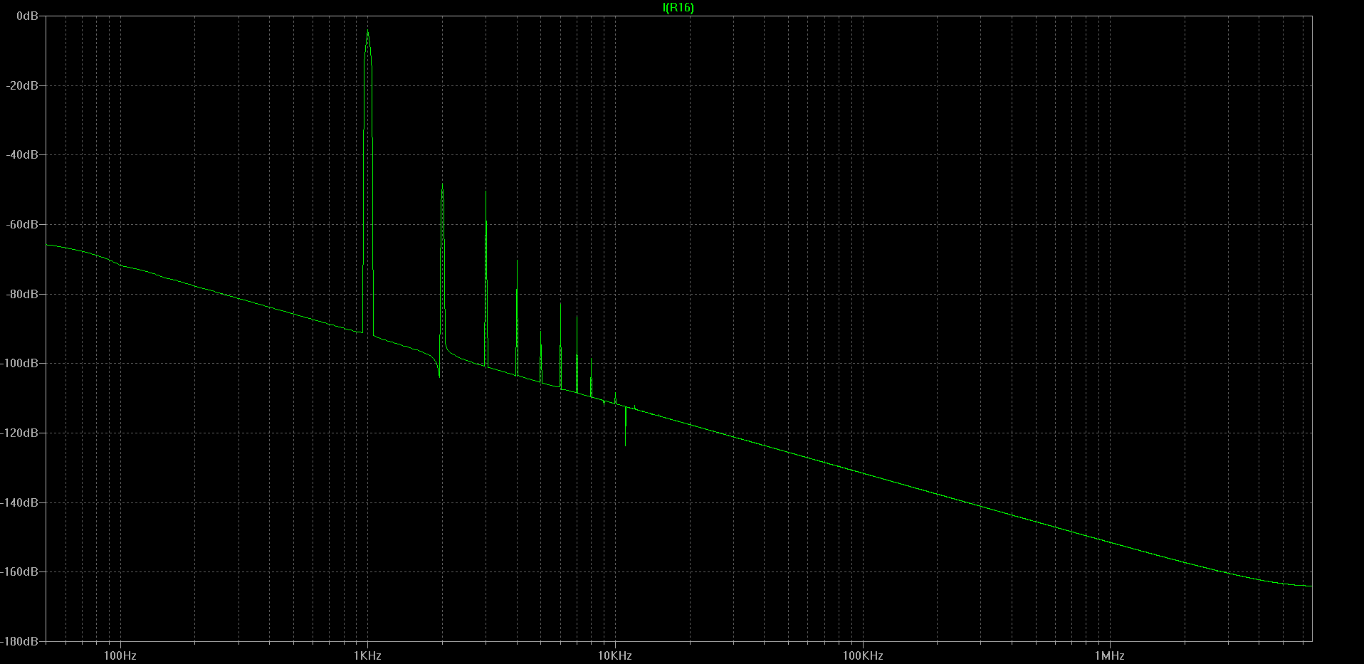

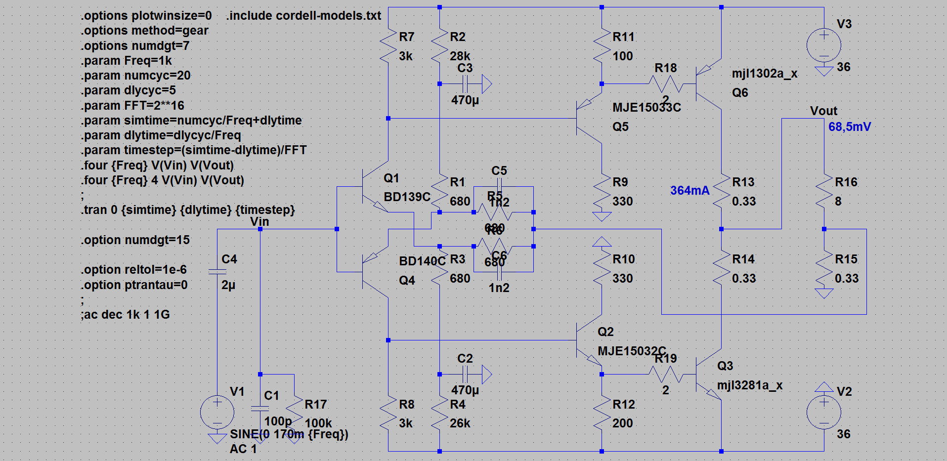

very early Ge cfb V to I VSSA: http://www.diyaudio.com/forums/atta...7549d1350806656-pavel-macuras-cfp-amp-cfp.png 😉
Looks like there is no way for controlling the output stage bias or does it run on the verge of being off ! The feedback is different too. It senses the output load current and not voltage. So you might get more of a current source than a voltage source. But then this might be good for the loudspeaker ! The 0.33 ohms seems to be in the wrong place. Doesn't seem to do much good there.
The inductor would open circuit the output stage for NFB. Is that a good thing ?
Maybe this stage wasn't actually tested as shown?
to be honest I have no idea

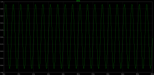

maybe not but this circuit is not so stupid, V to I amp with cfb should sound nice even with with thd levels. the simulation showed good behavior in class A with 1A idle.
here @365mA, still "has a potential":
Yes it's always interesting to try out new circuits . Here I worry about how the output stage bias will be set up and stabilised . Might turn out to be a good sounding amp. If the inductor causes problems at HF one could try a resistor in parallel to avoid a complete open ckt at HF ( RF?).

Recieved mine today.
Looking at VSSA photographs in this thread I forgot how big they really are🙂
Received my package. Not opened yet since I'm at work but I'll have some fun tonight!
Thanks for everything LC!!!
