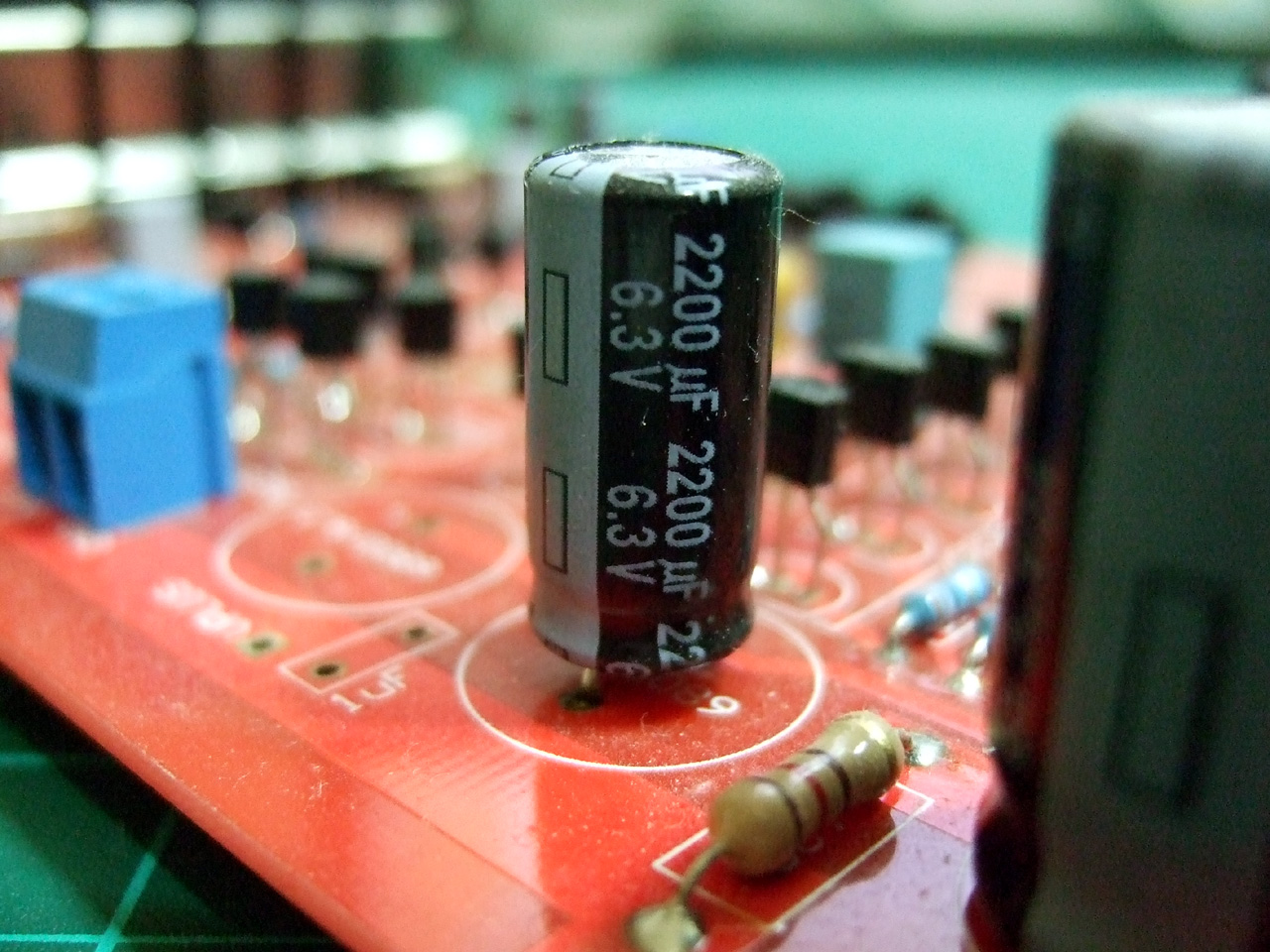

I mainly use Panasonic FR nowadays. They have the same low ESR then FM but have double the life span. They are very affordable and i can get them from Reichelt in a day.
I used FR in my poor-man's through-hole version of VSSA/PeeCeeBee.

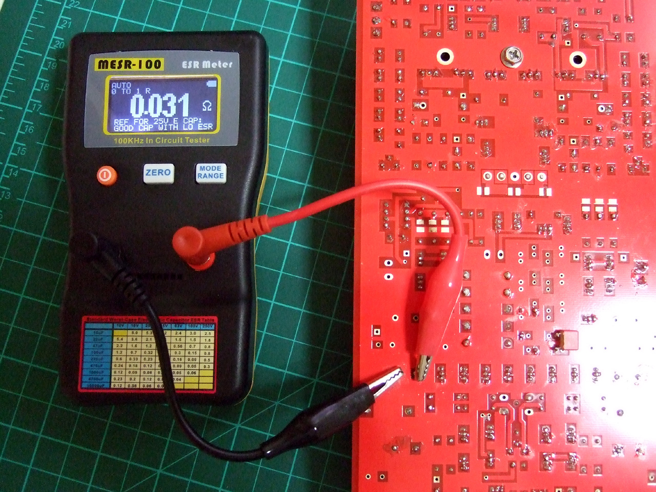

Measuring an FR 2200uF 6.3V for ESR in circuit on Paradise phono gives 0.031 Ohm which is usually 0.01 less for this instrument if measured off circuit to grip the leads better. (Went there if I firmly pressed the crocks down in circuit also, 29C ambient). That one ties with the 0.020R 100kHz 20C for its 20x10mm size can @6.3V in Panasonic's datasheet. Reliable data.

Nice toy, I am jealous! 😀Measuring an FR 2200uF 6.3V for ESR in circuit on Paradise phono gives 0.031 Ohm which is usually 0.01 less for this instrument if measured off circuit to grip the leads better. (Went there if I firmly pressed the crocks down in circuit also, 29C ambient). That one ties with the 0.020R 100kHz 20C for its 20x10mm size can @6.3V in Panasonic's datasheet. Reliable data.
If you haven't got an LCR don't spend on a separate ESR meter, get a good LCR that includes the function, also DF & Q. Best handheld is IET DE-5000.
Salas! I have seen a few "different" MESR-100. I think yours is the latest one. I saw one of this meter open and I saw TWO ELECTROLYTIC caps inside. I am not sure if your is the same, but if it is...I would measure them to make sure those electrolytic caps are still good. imagine an E.S.R meter with bad caps! That MESR-100 E.S.R meter looks way better build than those "ATLAS" plastic toys meters.

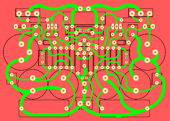

Capacitor dimensions for VSSA PCB:
- 10 uF/63 V, MKT, Vishay-Roederstein, 2 pcs
Lead Spacing: 15 mm
External Depth: 8.5 mm
External Height: 17.5 mm
External Width: 18 mm
Regards Lazy Cat![]()

Well I have been watching closely - this is a fantastic result (amplifier design and pcb layout) LC. You kept it simple in layout and in physical form. I know you promised that you'd do this but it isn't easy and it turned out very well indeed.
I think this has turned out to be the 'F5' of the SS forum (meant as a compliment).
The LatFET is so well suited to this topology because of the ease of thermal compensation and ease of drive. The two-in-one package for the FETs was really the icing on the cake.
