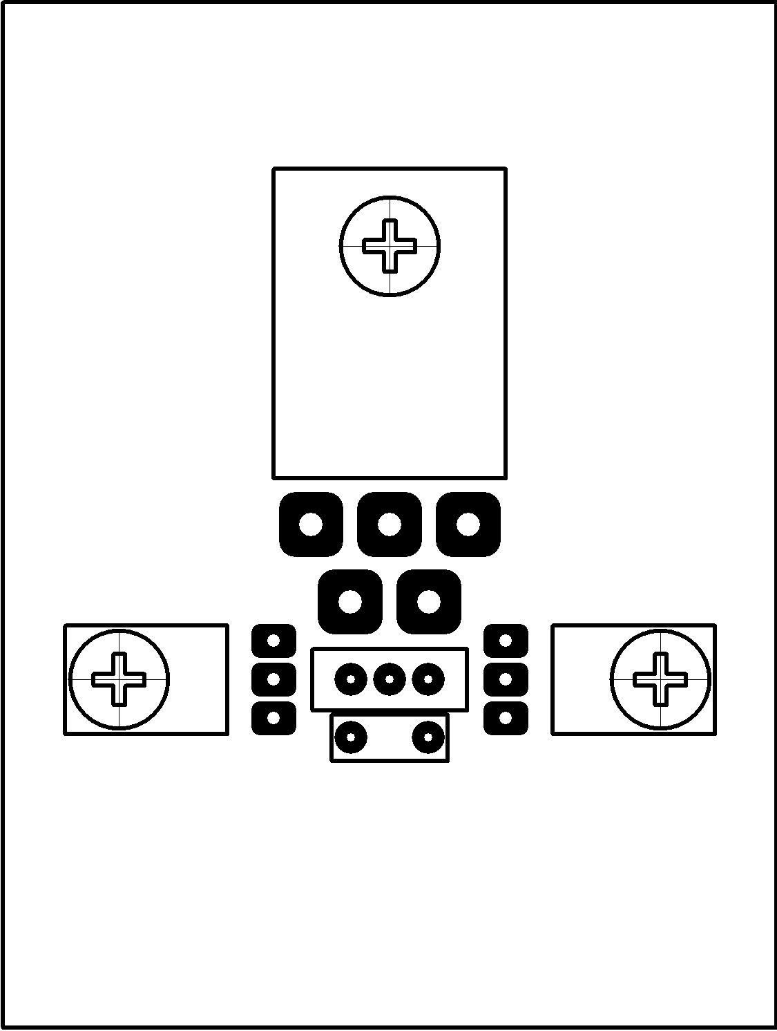

Look Marc here's VSSA PCB preliminary. All three transistors to main heatsink, TO-126 will have 2 mm ceramic insulators, so very little capacitance to main heatsink (GND) and still enough heat dissipation. PCB fixed with these three screws only, each 2,2 mF/40V replaced with two 1mF/50V, etc. So you can get an idea ... 😎

Rhaaa lovely....will play with that if allow.

cool looking little amp
maybe time to go build that active speaker 🙄
Yes, VSSA PCB will be perfectly suitable for that purpose, just wait a little. 😉

ALF08NP16V5 board try : 75x66mm
