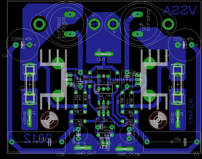

I almost forgot to thank you lineup for this experiment. So even half the VSSA is working good, that means the whole VSSA is good to go guys hehe.Here is HALF the VSSA. It is almost like FETZILLA.
Half the VSSA works well, too.
A little bit more THD(0.007% at 1 Watt), but it behaves well even at higher power output.
TO-3 mosfets are so tempting to have them in one of the amps, could it be VSSA? Let's see ... well done Marc.![]()

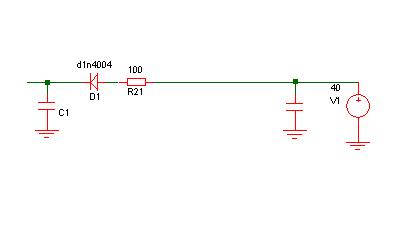

Hello
Bigun of course I'll do!
I like these design.
I would advise a small mode which could influence the sound in a positive way.
I did tested with several circuit with or with out and always improved the sound greatly
I would separate the front using a resister and a diode, of course in that case it would be good to ad a pair capacitor to after the diode (front)
I did tested these at my Dalington, Naim clone, and NCC200 clone- always brought a huge sound improvement.
Just a small advise but it would be worth to test it out!😉

Which I remember to have first seen on Hafler DH-200 by EB which I am sure someone has seen somewhere before and so on and so forth.
Thank you.Well for those folks who like to simulate here's my contribution so far to the Lazy Cat VSSA, a file to play with.... 😀
HelloWhich I remember to have first seen on Hafler DH-200 by EB which I am sure someone has seen somewhere before and so on and so forth.
It is very popular because it improve the sound, works.
I wrote I just tested😉 in a few circuit (made A-B test with and with out) and improve the sound greatly..
It would be worth to give a try here to..
Greetings Gabor
I know, poor man's drive stages rail isolation, sounds good indeed. I just hinted on electronics ideas recycling history.

Me too, very much. As I was informed you presented this topology to the world, so I would like to express my great admiration to your work and would like to share it further among DIY-ers because it deserves it. Hopefully more and more people will taste this simple amp topology and realize how good it can sound.
My purpose by this thread was to encircle all three types of current feedbacks:
- SSA has DC coupled current feedback, input current injected to the middle of feedback resistor divider where AC is present, constant current source is preferred choice to inject input bias current to achieve correct input-feedback subtraction. Because of thermally dependent Vbe of input pair, SSA topology is the most dependent to thermal drift, great care has to be put to make it stable but as a credit you get flat frequency response from DC
- TSSA has AC coupled current feedback, input current injected to the middle of feedback resistor divider where AC is present, constant current source is preferred choice to inject input bias current to achieve correct input-feedback subtraction. It is an order of magnitude less dependent to thermal drift because feedback ground resistor doesn't conduct DC current, no need for extra thermal stabilization of the input pair
- VSSA has AC coupled current feedback, input current injected to the junction of feedback ground resistor and capacitor where AC is not present, only resistor is sufficient to inject input bias current to achieve correct input-feedback subtraction. Also as with TSSA, no need for extra thermal stabilization of the input pair
Regarding stability and simplicity VSSA is a clear winner, but going more complex by using CCS in input stage, all three converge to very similar results. Most complex of them all, involving all the features, is forthcoming CSA, which is on the test bench at the moment.
