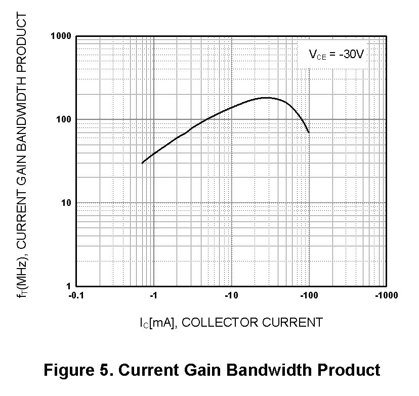

LC, how about VAS cascode or VAS beta enhance? I have no time right now to try, but I found 20mA VAS using BD trainies is better in treble (subjectively).
Higher current makes it have higher current gain bandwidth product. 😉
Why don't you try both, beta enhancer plus tracking cascode.

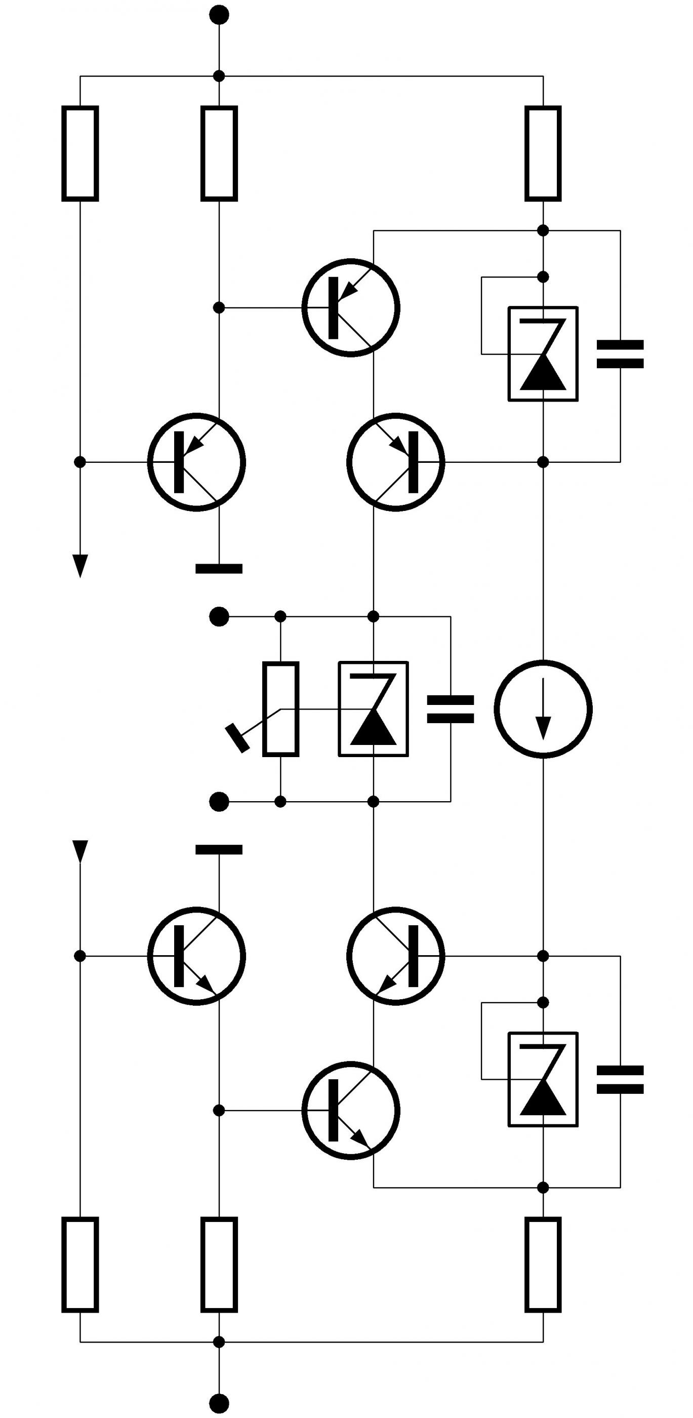

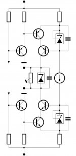

More spy info see picture from "First One" prestage. If it's SMD-film, SMD-ceramic or changed since don't now (Link: http://www.diyaudio.com/forums/solid-state/239708-vssa-50-a-5.html#post3598917).
..........(one for the money, two for the show).

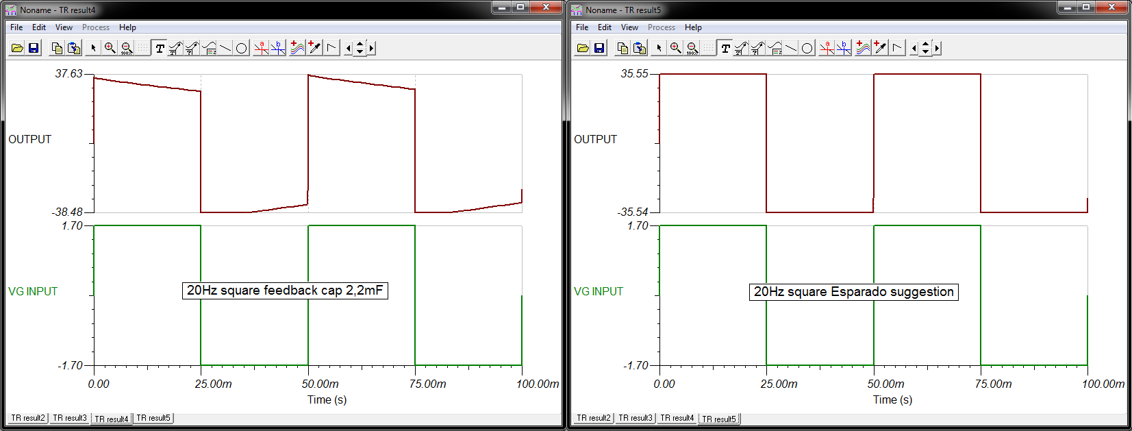

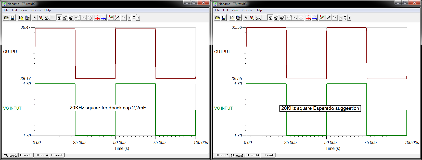

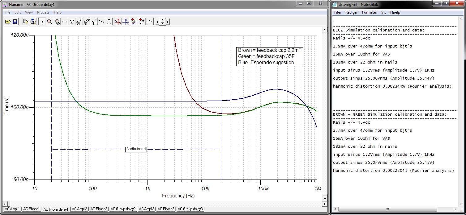

Played with simulation of GB circuit (copyrighted so please don't ask schematic other than Andrej). Implemented Esperado schematic from post #2629 the best my hobbist skills allow, remember it's simulation only. The audio band group delay gets perfect linear when zoomed into nano seconds. Christope i am in doubt about truth for 20Hz square, could result be right ?..........three to get ready, now go, cat, go. 😀
