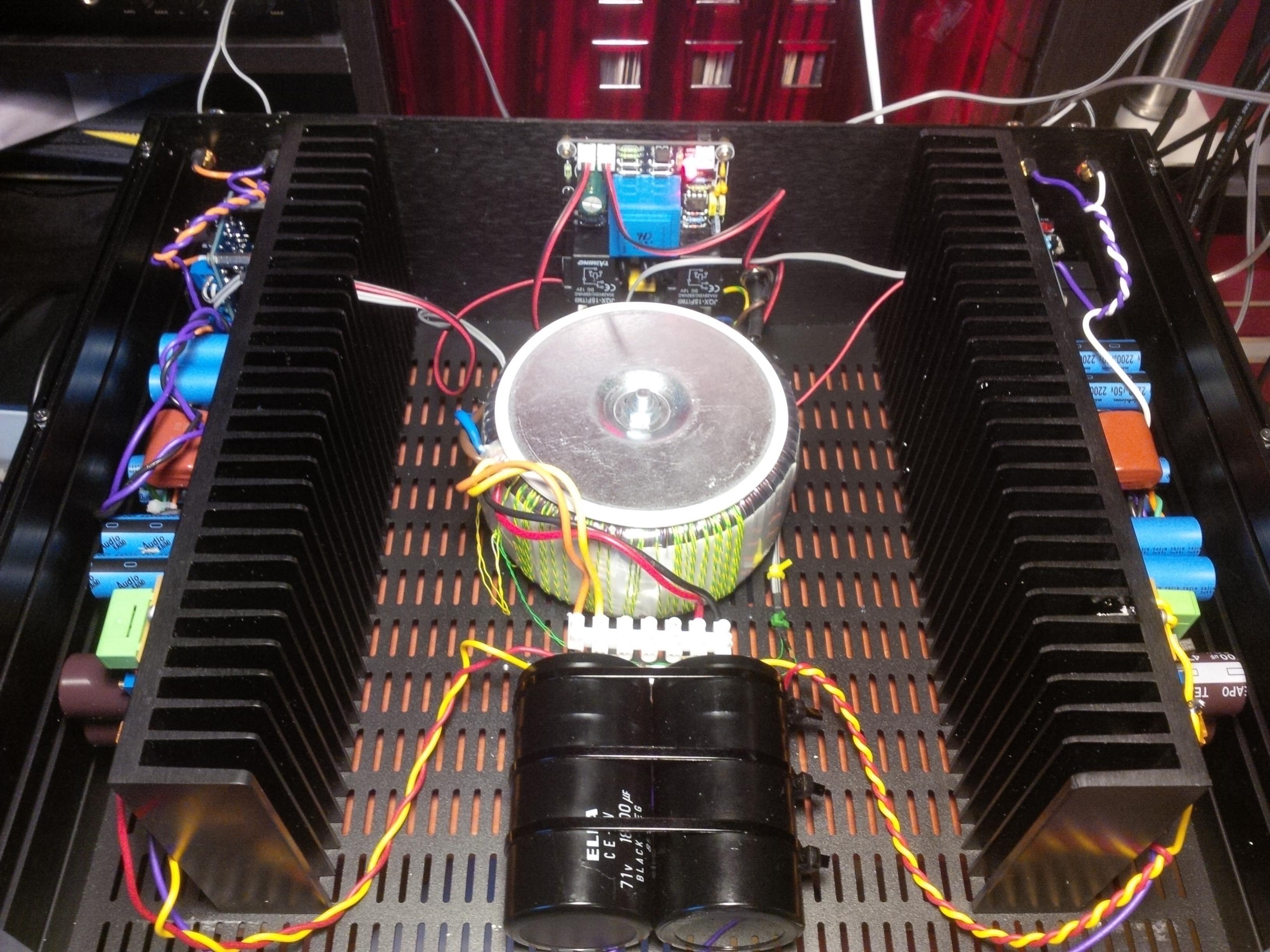

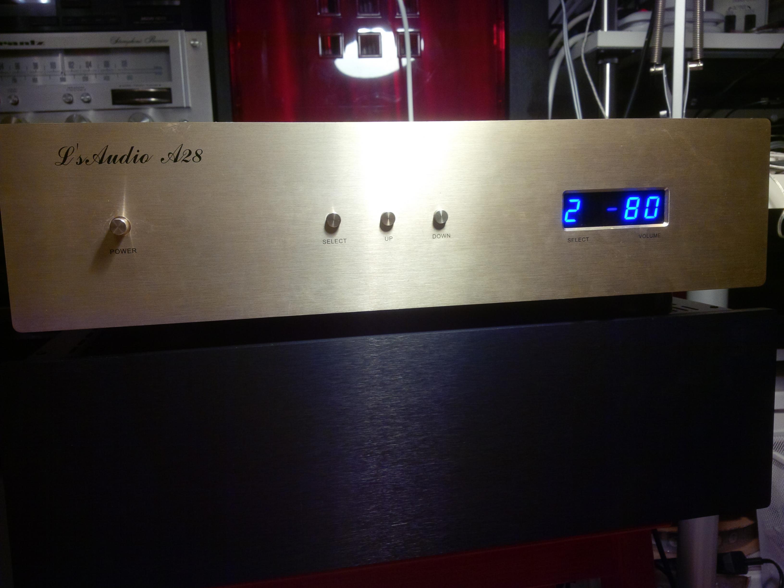

XVSSA playing

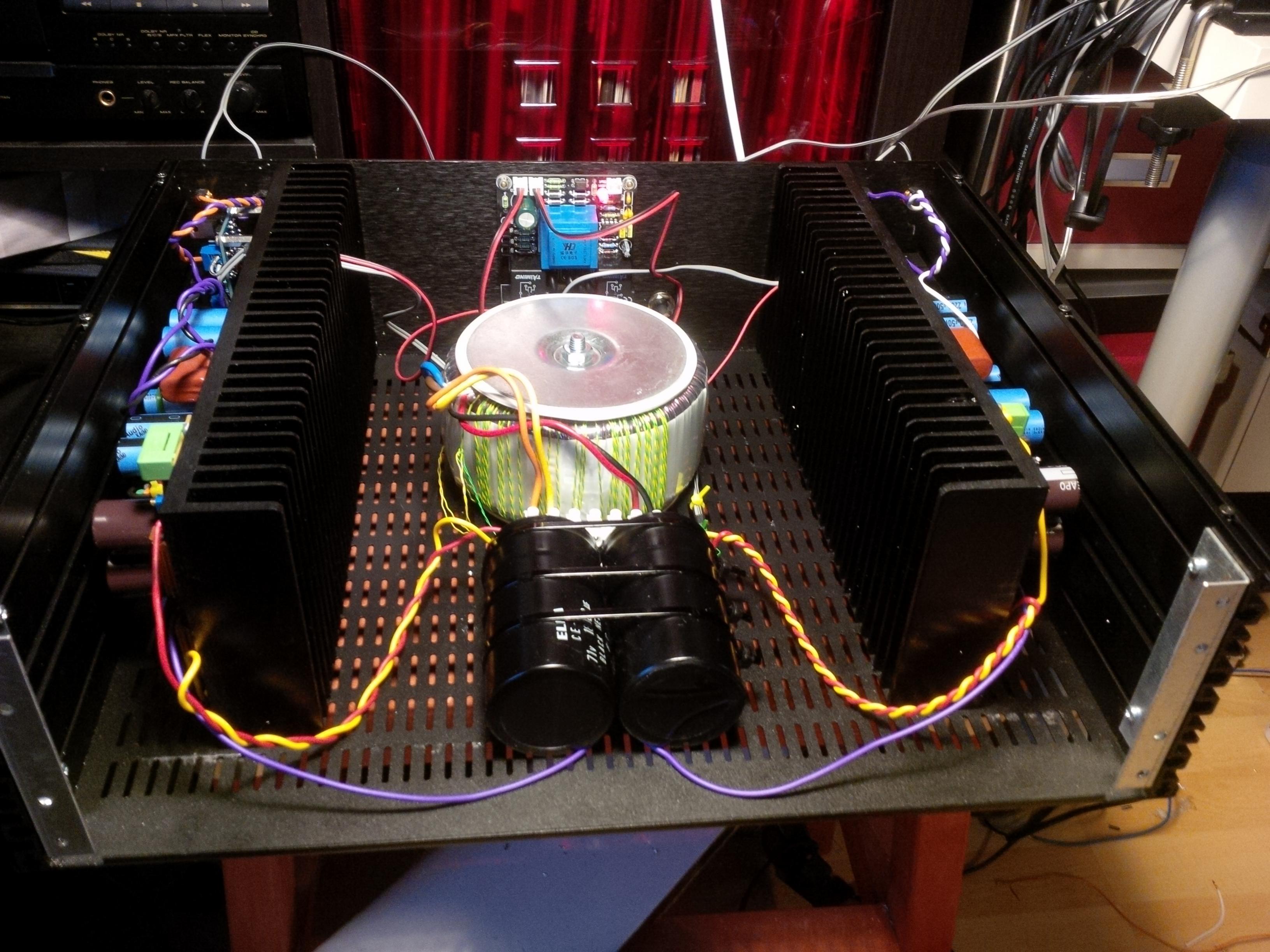

XVSSA plays wonderful in 2 balanced channels being fed by JC80. Dead silent, much less sensitive to how the GND is configured, a very classy piece of art. Details are exceptionally well revealed, even some unknown to me until now. And one channel is quite fresh, only 1 day since powered on. Additionally, the auditioning tests are made using only digital sources (CD and ODAC fed from PC) and quite mediocre Denon loudspeakers I am using usually for tests.
The heatsinks are just a bit warm when touched by the hand, even after playing some loud notes. Power supply is as I've said, one bridge - one 18,000uF ELNA capacitor and one 50Vac winding for each channel. Works like a charm 🙂
Sadly, I have to stop it to just arrange the wiring inside and close the case. And of course, I need to make some measurements, but I should finish the SE-XLR converters first. Will do and report later.
Can't wait to do the test with the final setup as well (Bose901 at the end and Paradise phono at the beginning) , but for now I will calm down and finalize the setup and lab tests. Believe me please, that is the most difficult part, much worse than wanting to smoke a cigarette in a 8 hours flight! 😀
Cheers and BIG THANKS LC!!!

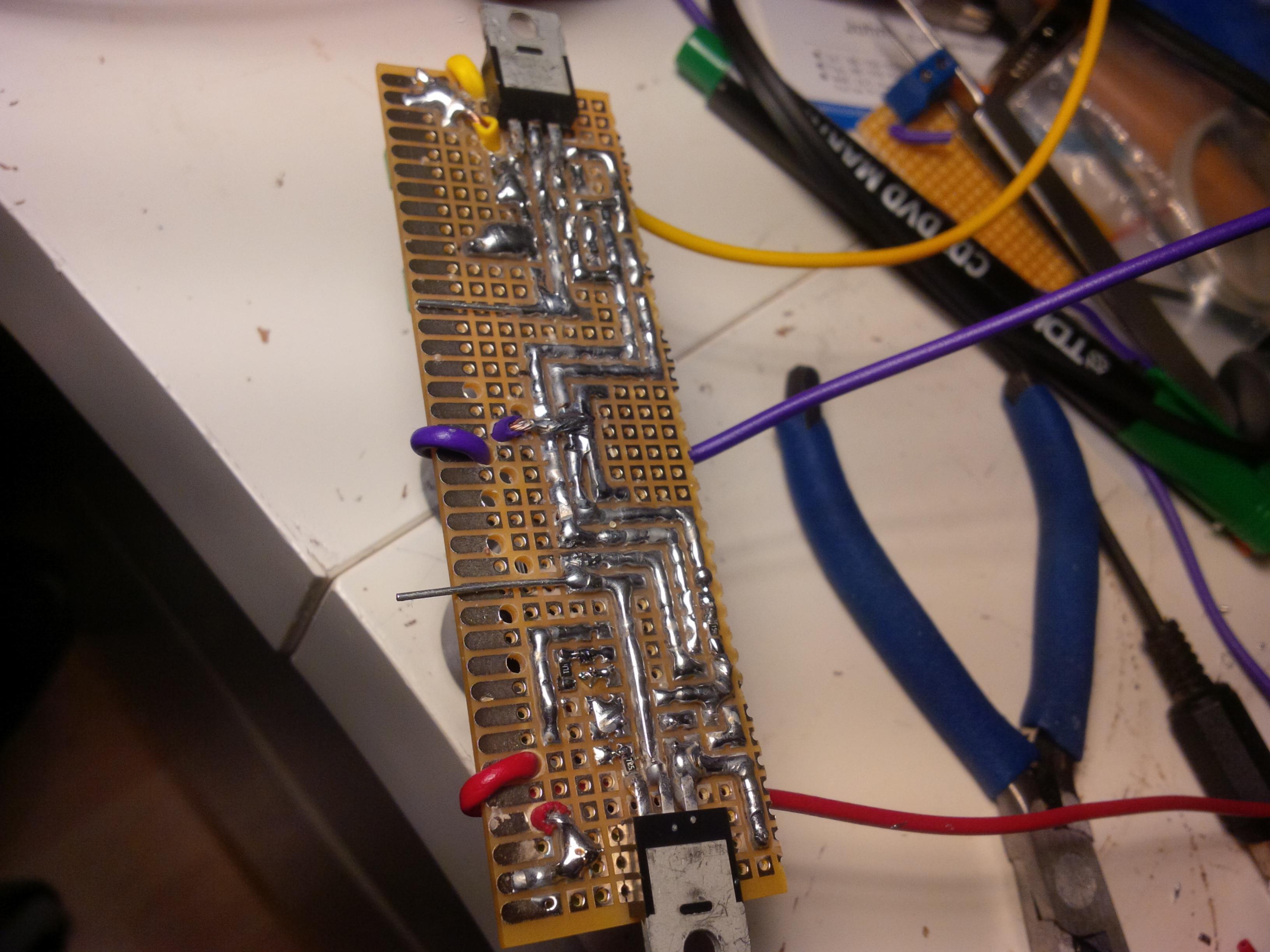

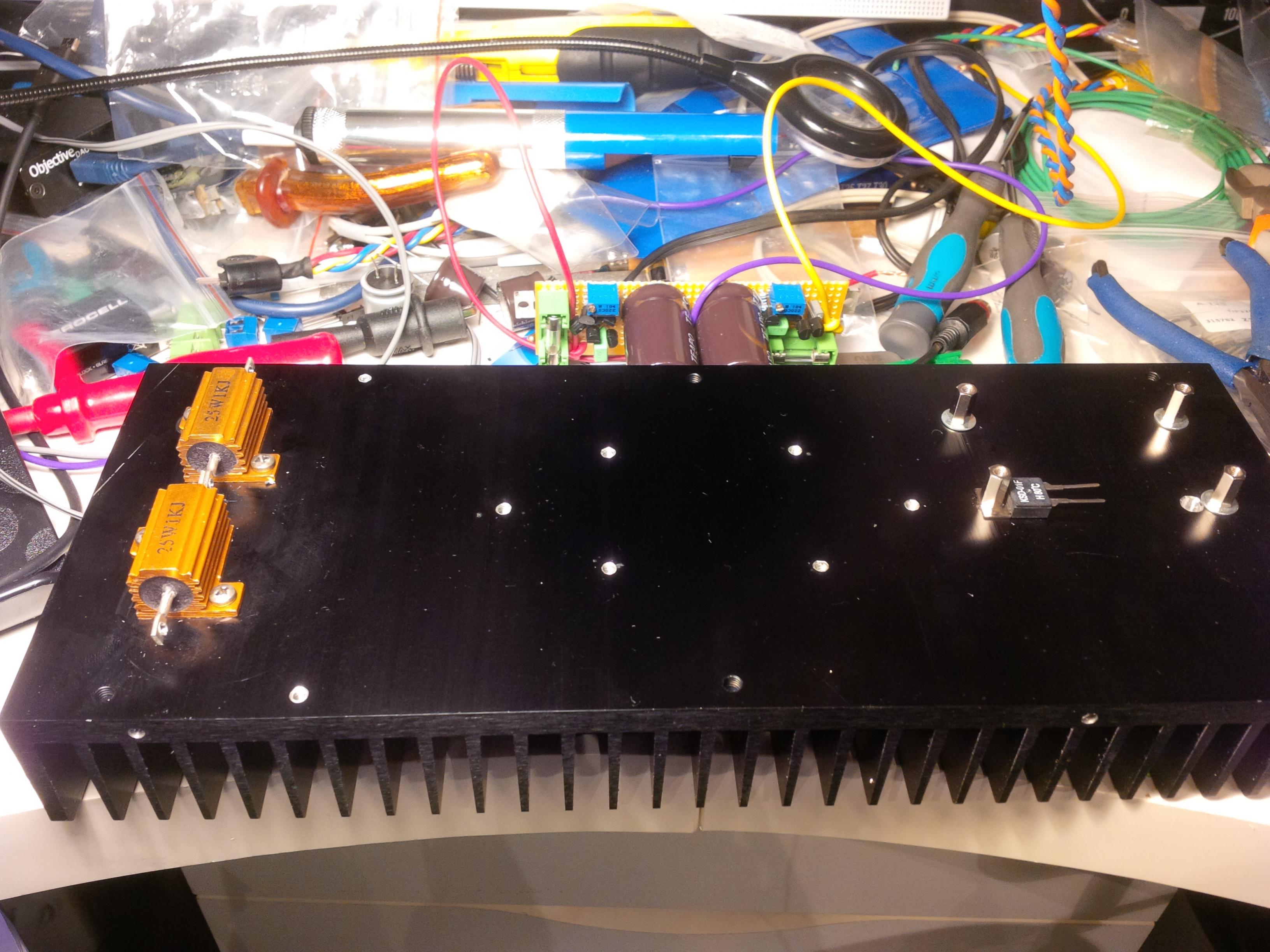

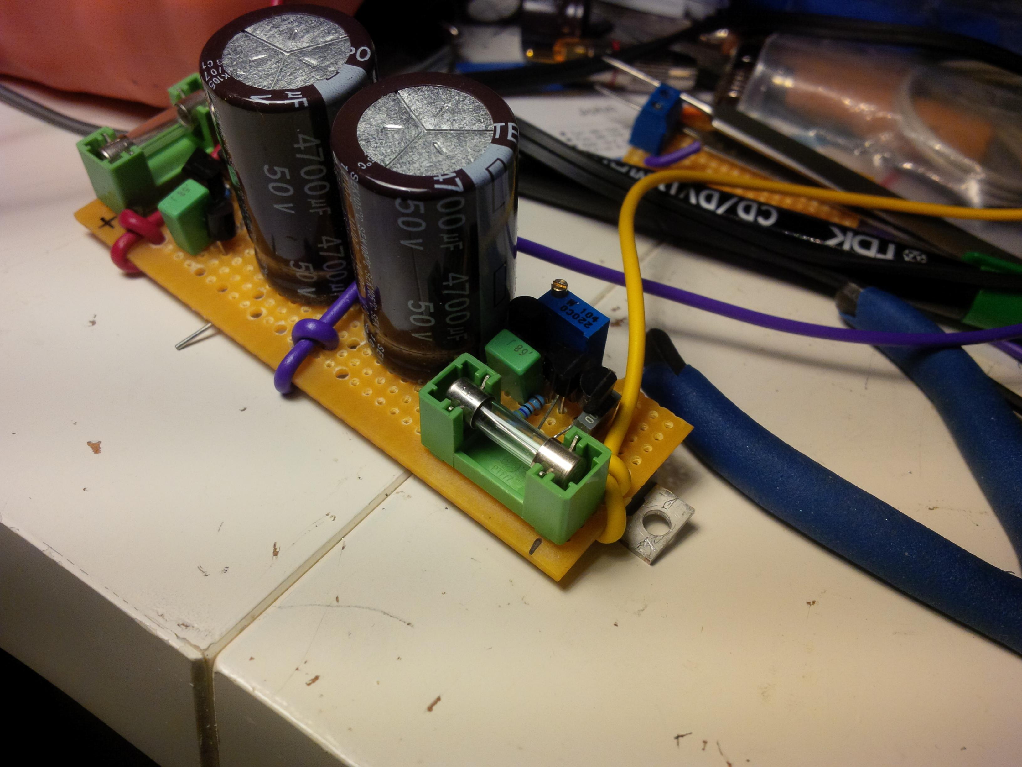

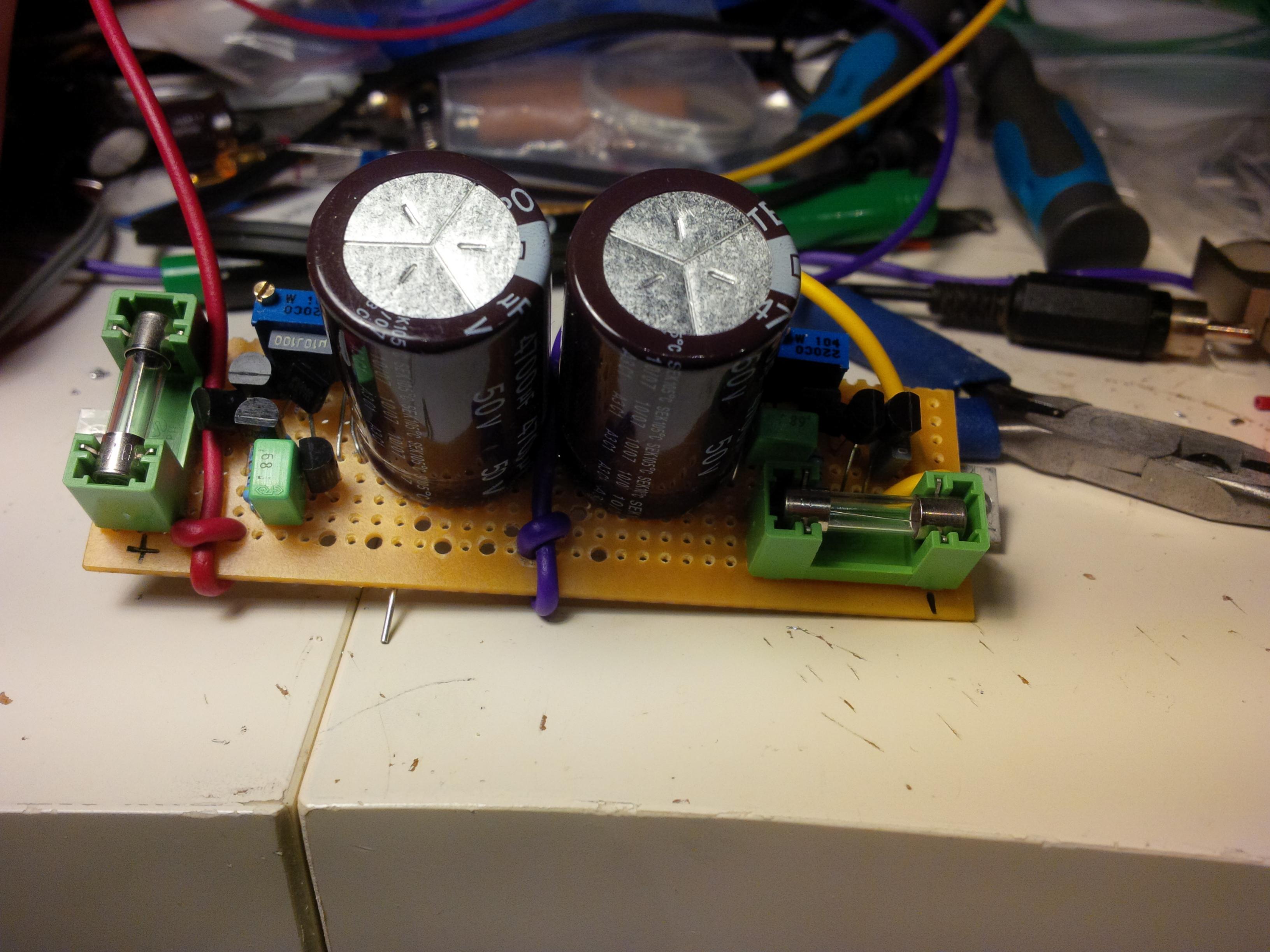

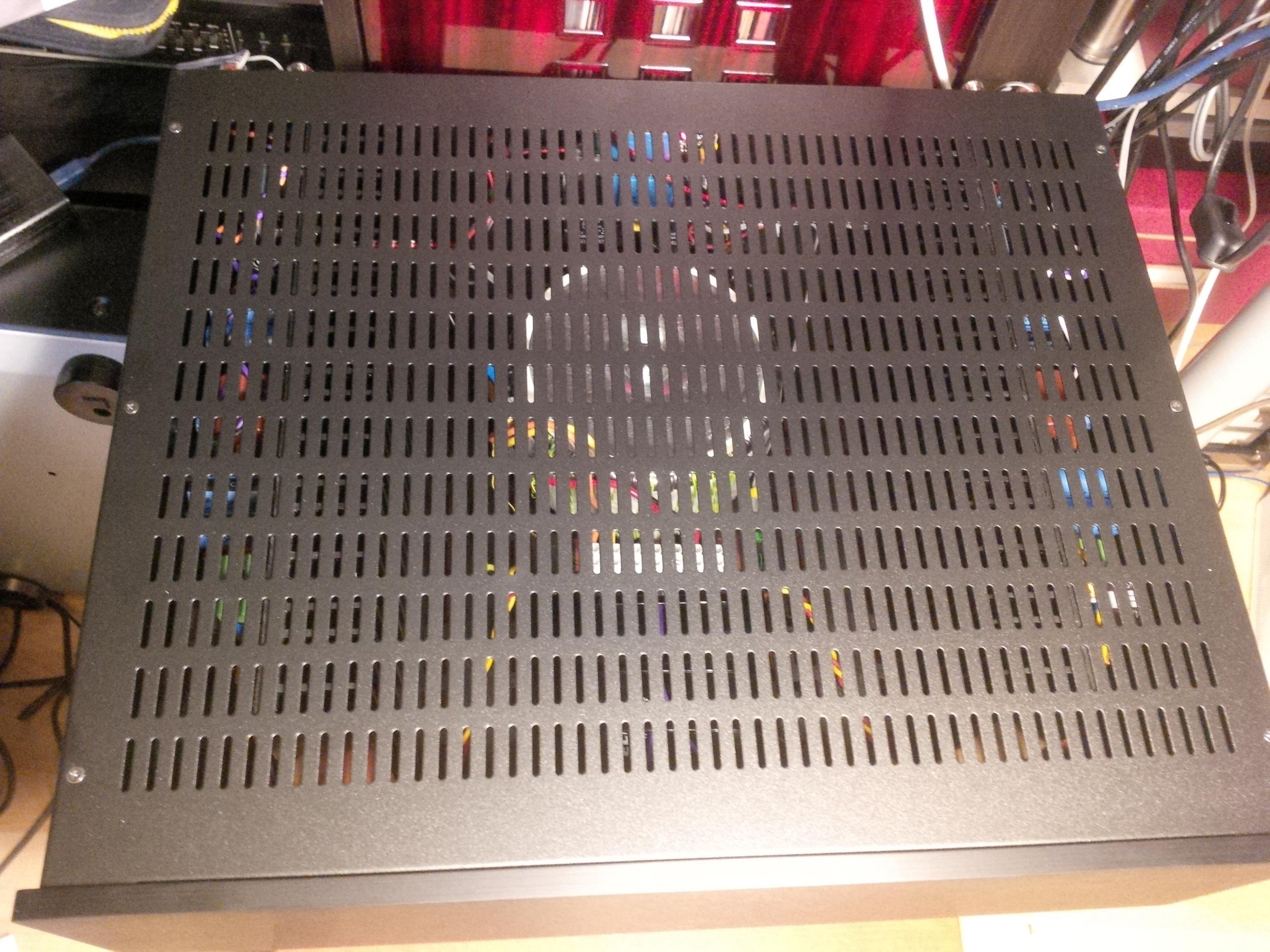

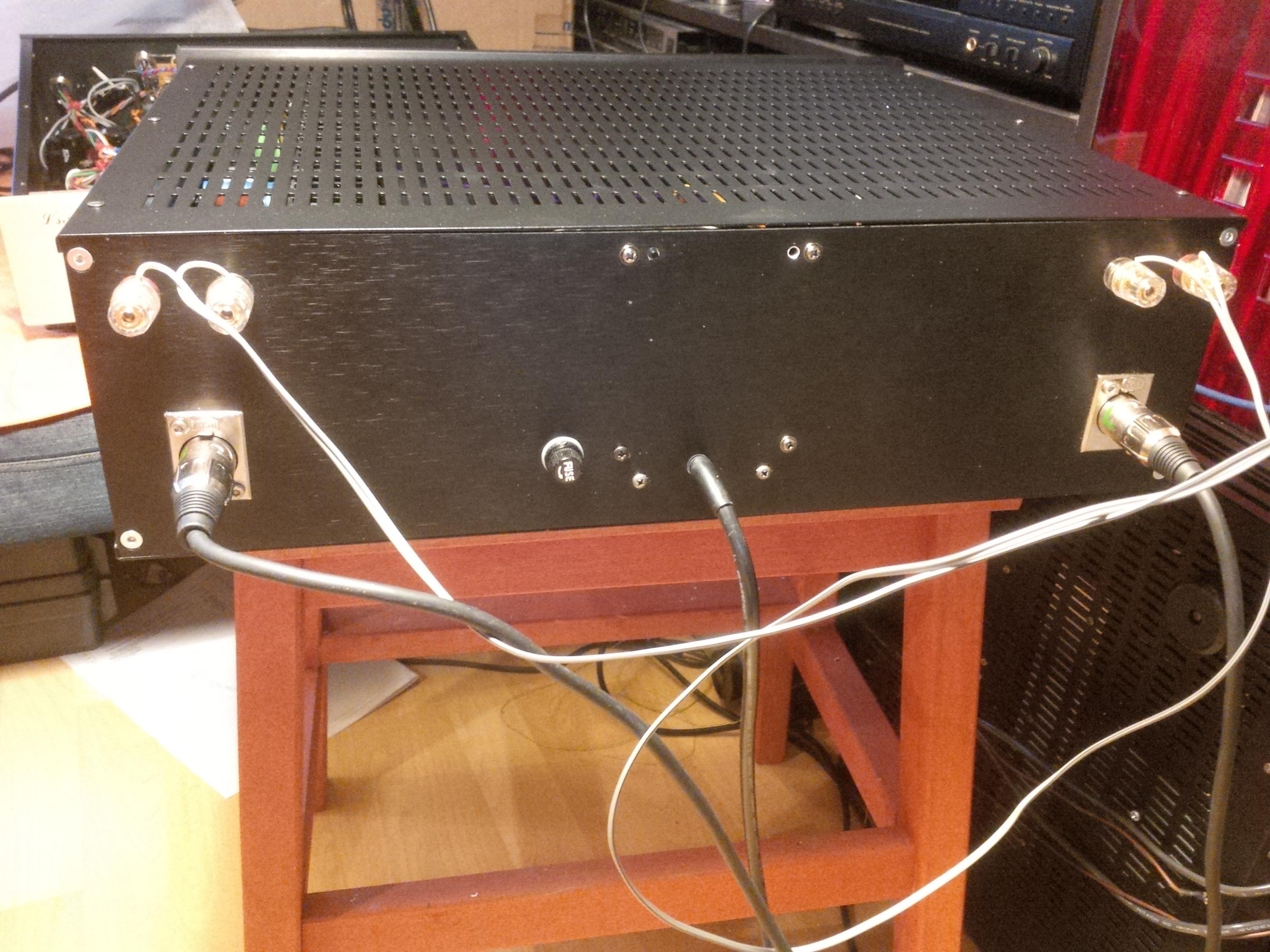

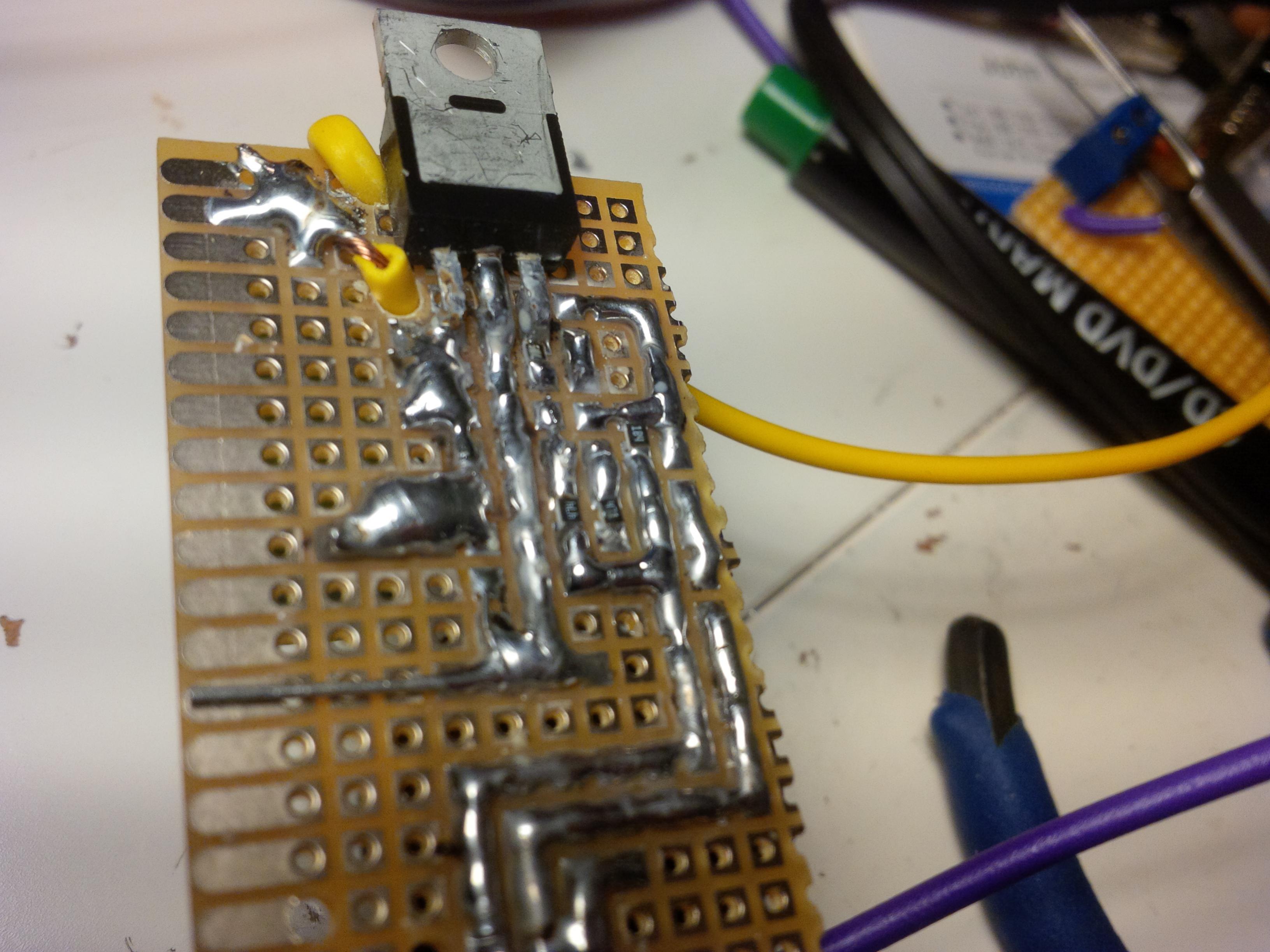

XVSSA details
After finishing the mounting, I add here some pictures with details, to spare a lot more words.
The SMD-Through hole mixed P2P Cap multiplier, heatsink preparation details, the inside of the box and the outside after closing it.
And of course the tandem JC80-XVSSA in the testing room.
Still busy with the RCA-XLR adapter to start some independent tests of XVSSA.
Just a bit until serious music tests 😀
