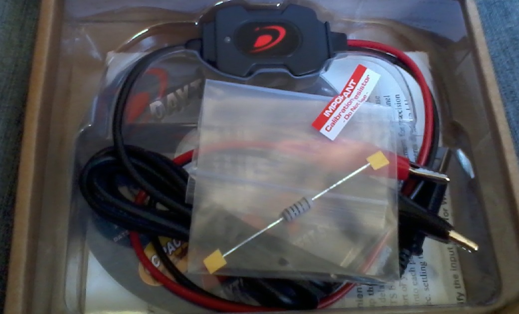

Hi ivanlukic very much thanks for tips.
I guess i also can check/measure reallife result with the DATS unit from Dayton Audio, i bought this device in januar from Intertechnik.de for other purposes with goal for bringing my speaker projekt SQ higher (See Picture for DATS device).
If this unit can inspire others for having big small helper in speaker solution see Dayton Audio website (think the unit is born by John Murphy at TrueAudio and eaylier branded WT3, but now with new software and more purposes, eg making ThieleSmall data on unknown unit).
BR Ricky

I prefer the solutions where diy-er does not need expensive lab instruments and complicated measurements, simple working solutions that satisfy diy-ers needs.
Solutions that do not require complex multi element circuits. Zobel inductance compensation (RC) is such circuit. This is because I do not have lab, scope, etc. I believe that many diy-ers do not have lab, so it's pointless to suggest complicated solutions that are possible to only very small number of diy-ers. I am glad that some forum members have good labs and are willing to share some of their experiences and results, but most forum members do not have lab. Most of us are amateurs without lab.
Hi i am too and don't have a scope at present, but thought that for exampel the 120€ for the DATS measure helper is ok and needed, if i want to make source SQ out in room one day, because commercial way seems to not make better SQ at certain expence, just different SQ.Most of us are amateurs without lab.
BR Ricky
