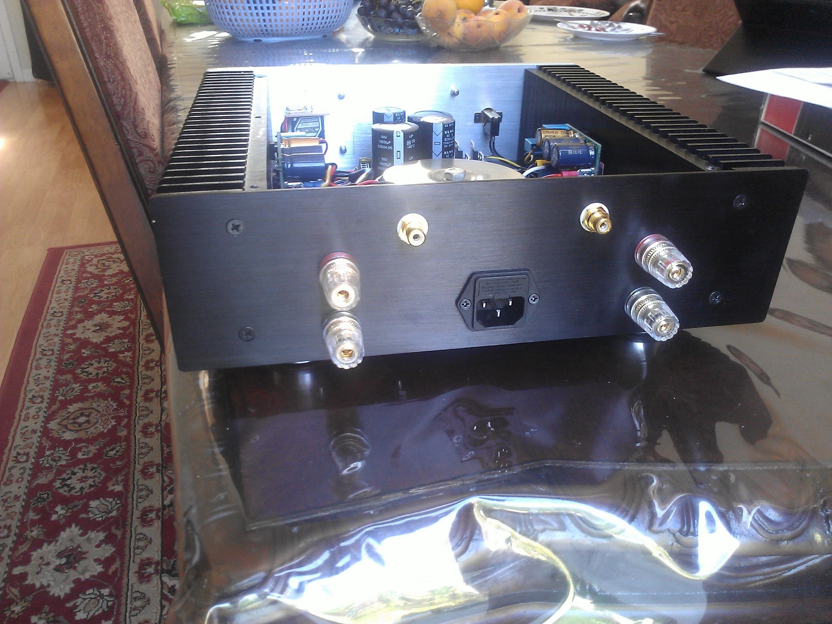

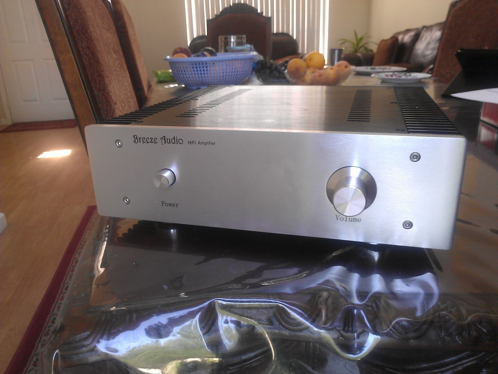

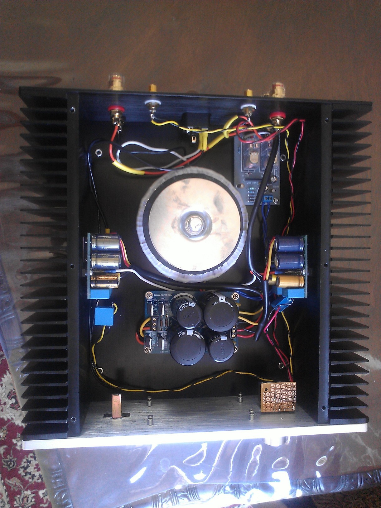

Hello Folks,
Here are the pictures of my completed VSSA. I went little bit cheap. Amplifier enclosure is from Ebay, as well as the power supply PCB. No preamplifier but a simple 10uf to avoid DC coupling.
It sounds great and living up to the promises made by its creator. Transparent amp ever with solid bass. Even my wife gave the compliments - your amp is awesome. She listens to it most of the day almost every day.
Thanks,
Routhun

Hi Routhun
I like your VSSA amp implementation very very much. It is done very professionally, clear by design and mechanically perfect. Very glad that you like it, it will bring music in a most listenable involving sonic presentation with a lots of details. Thanks for presentation and together with your lady wife have a lot of joy by VSSA.
I was not worried about any lack of friendship from such a gentleman like you...no worries at all.![]()
But the killing ability of the one who design such beautiful 'killing' amps 😉!
Better to concentrate myself on reading comments of builders about the sound of your young but educated baby, to try to understand the reasons leading to similar so good comments (Current feedback operation+ Simplicity ? Quality of active devices, better thermal coupling of power devices due to one case build for the pair ?).
It is obvious you had achieved a real masterpiece and, now, i am curious to understand some of their keys.
Influence of various power supplies (i would love a comparison between your SMPS and a regulated one), if a single SMPS can enhance, as i expect, the stereo image, and if bridged mode can bring quality enhancements in the same time than power increase etc...
I had learned so much, looking at your schematics, and reading at your comments and various tries results. More than during the last two decades.

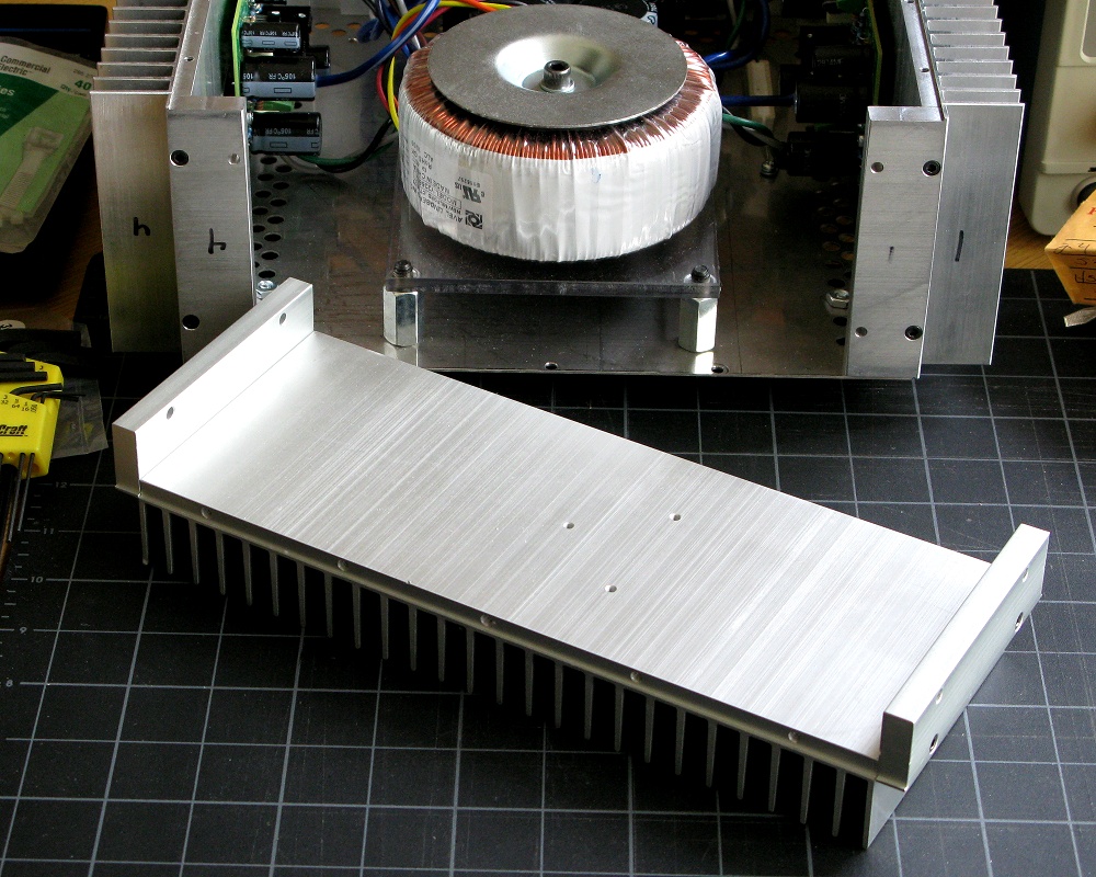

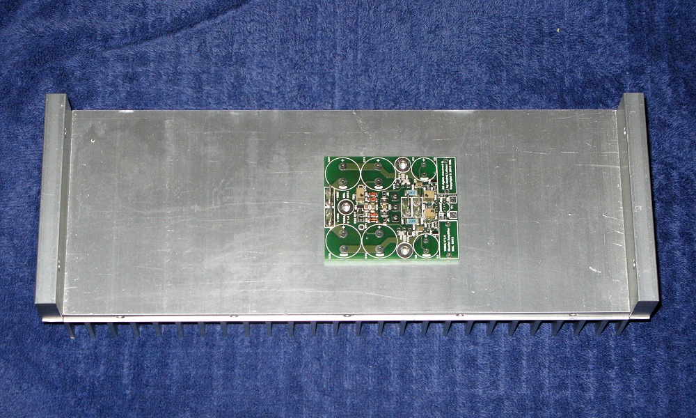

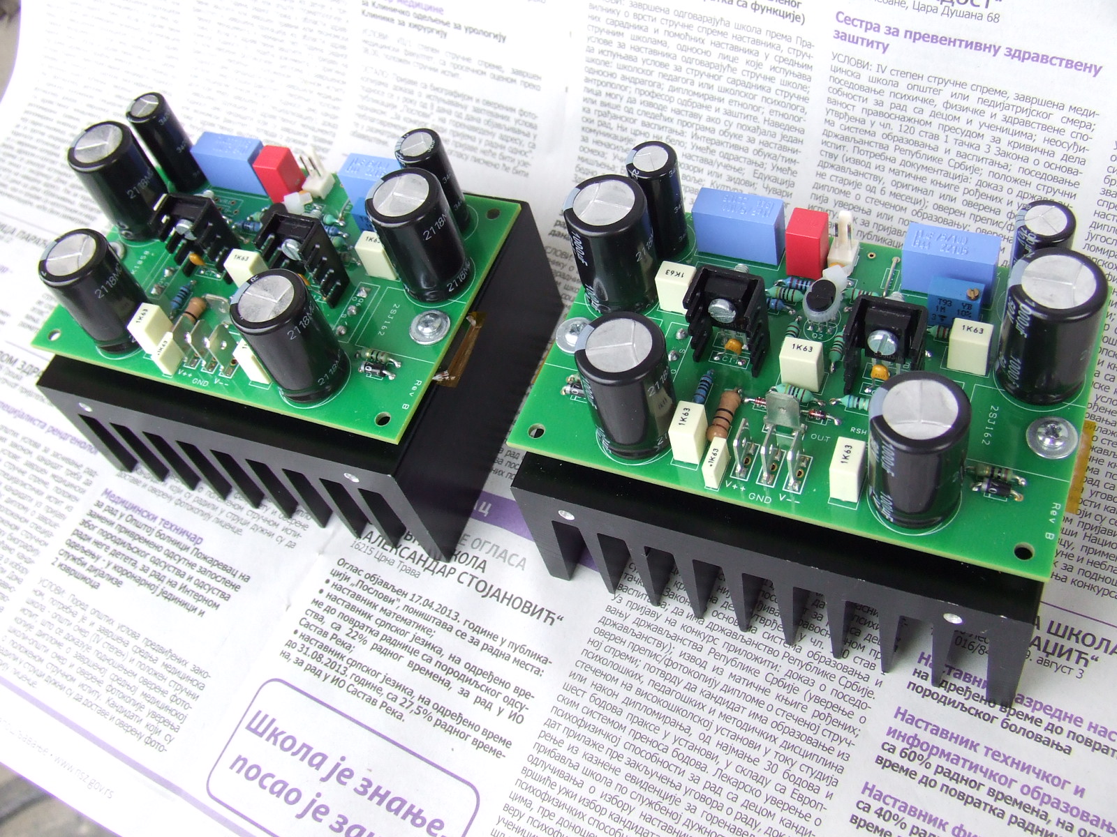

Terry,
Forum member PMI (great guy!) commented that there is a company in US selling big heatsinks for low prices. It seems that the company is sponsoring this forum, and the name is, if I am not wrong, Heatsink USA. I wish I could buy big heatsink for that low price, so at least for you people living in US, it should not be problem to buy big heatsink. But I guess that smaller heatsink will do for low level listening. This is what I used for through hole version of VSSA amp.
@Terry: I am using the same heatsinks for the modules I have received from LC and for the through-hole version of VSSA. If you buy them as a bare extrusion, they are only about $12.50 each.
At idle, they are barely warm to the touch, about 10-13C rise above ambient, with total current at idle adjusted to about 150mA per channel.
There are several pics in the PeeCeeBee thread, including at the bottom of this post:
http://www.diyaudio.com/forums/solid-state/231662-peeceebee-96.html#post3573462
Here is another pic, after machining and w. clear anodize:

Mmm, with smaller PCB I think PMI's heatsinks will look BIG, I think LC's are smaller with longer fins
Terry,
The heatsink I am using is actually very close to the one LC recommends, 0.5C/Watt, in thermal capacity. About 0.65C/Watt, convection in free air. It is thermally coupled, which actually makes the capacity around 0.45-0.48C/watt (tested).
The heatsink LC is showing pictures of has longer fins (so looks bigger), and not as tall, I believe. It is calculated for pretty much worst case conditions.
So, if you know that you have a heatsink that works for you with a similar class A-B amp, with about the same idle current and supply voltage, it will be good enough.
Pete
Pete
You are correct. I did not design the through-hole boards for small size 😉Mmm, with smaller PCB I think PMI's heatsinks will look BIG, I think LC's are smaller with longer fins
I found another pic for better scale:
edit:
@Terry: Not including the corner brackets, it is 4 x 10 inches, with a 0.3" thick base, and 1" long fins 0.4 inches between fins (if memory serves). I will look it up exactly when I get back home.
