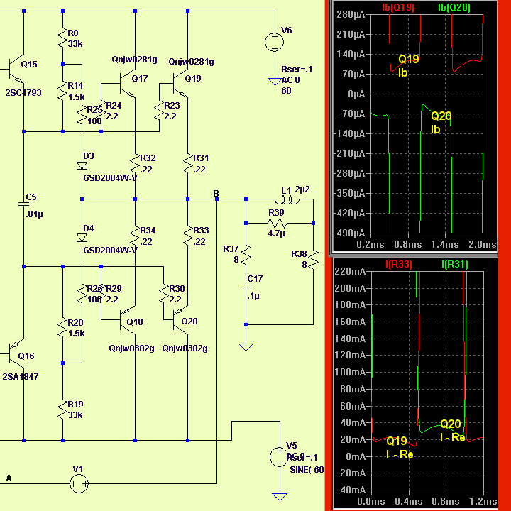

How does U6 (SPDT) work?
That's an overheating emergency shutdown. The relay is NC and when it's energized (by a protection logic that senses overheating) it opens and shuts down the whole amp. It acts like the overcurrent protection, but it is non-latching. The hysteresis (to avoid relay "chatting") is provided by the thermal sensor circuitry. It can also be used for other emergency shutdown conditions (low speed) by OR-ing the sensors outputs.

http://synaesthesia.ca/Prot-Sch.html in the upper left corner, MAX6665ASA55. Also controls a fan, see the Maxim datasheet.
If you don't want the overheating protection, just replace the relay with a wire :D

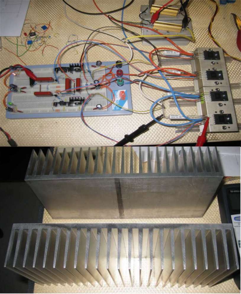

Waiting in the PCB queue. I decided for the bipolar version (4 pairs NJL per channel), it is my first adventure there in the last years.
The OPS posted above measures (with only two pairs on the breadboard, fan cooled) 0.08% THD20 open loop @ 80Vpp into 4 ohm, that is about 200W, not bad at all. Compared to the original Bob Cordell's version, there's a slight change in the thermal compensation (another diode in the loop, the original was undercompensated) and in the driver bias, I'll be back with the full schematics.
Monster heatsinks from ro-theta are already in, see the picture.
I think I'll get addicted to bipolars :)

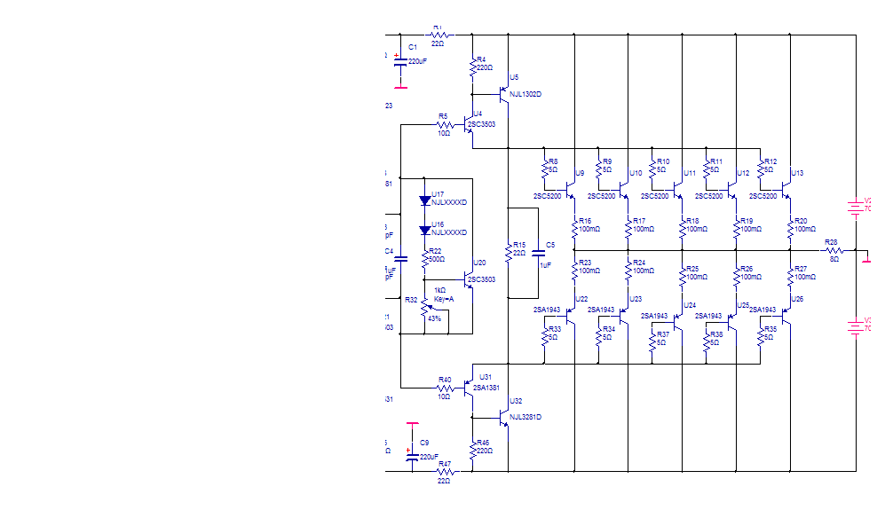

Done guys, this is the VSOP 1.1.3 release.
The board level schematic is attached. Don't be scared by the apparent complexity; in fact, the signal path is ridiculously simple.
A triple EF bipolar output stage, with four pairs of Thermaltrak devices. Thermal compensation is based on a Bob Cordell idea, modified/optimized for pretty much zero coefficient. After several hours of 400W into 4 ohm, the bias was down 5mA from the original 4 x 120mA. For clarity, I'll also post below a schematic of the output stage only.
A folded cascode VAS, running at 5mA, TPC compensated for a unity gain frequency of about 4MHz and a phase marging of 75 degrees.
A current feedback input stage in non-inverting configuration, with local feedback for a gain of 11.
An opamp input stage providing the rest of the gain to 28dB, set by a global feedback loop. The overall unity gain frequency is about 3.5MHz and the phase marging is about 85 degrees.
The rest (60%) are "frills", though required for such a high power construction. Current protection around my "audio thyristor" (Q15/Q16) as in the YAP amp, an active clamp (Q11/Q19) as I showed previously in this thread (with an additional diode to increase the margin, as Glen suggested), and emergency shut down (the relay) activated by the power sequencing, thermal protection and other critical condition sensors (TBD, on a separate board, using the same kind of "analog computer logic" as in the PGP amp), a servo for almost zero output offset (although using a low offset opamp makes this really a "frill").
Quick measurements shows 15-20ppm THD20 at 400W into 4 ohm. At 100W into 8 ohm, distortions are close to the 1ppm barrier (haven't had yet the time to get a reliable number).
120V/uS slew rate, stable in any load I was able to simulate (including a 2uF with 1 ohm in series). BTW, anybody ever seen a 2.2uF film cap exploding? It's nowhere less spectacular (and dangerous) then a large electrolytic reverse biased :(
The input cap defines the closed loop bandwidth and smooths any overshoots in the transient response (inherent in TPC) to a RC low pass response.
Here's the output stage schematic, shown only for to illustrate the thermal compensation. Note the extra diodes (compared to Bob's original design) and the R270/R271 resistors used to trim the thermal coefficient to almost zero. Reason for all these is that Bob's original design turned out to have a slight positive temperature coefficient, enough though to make the whole OPS thermally unstable at high power.
Here's the full amp board level schematic:

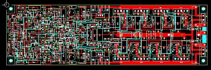

The PCB layout picture is attached. The board is 10" x 3" double sided and screws directly on a R-theta heatsink I have posted the picture above.
I'll be back with pictures of the construction and more measurements. Gerber downloads etc... will be available soon on my web site.
Have mercy, this is my first fully bipolar high power amp :) How does it sound? Don't know for sure yet, but certainly not worse than the PGP and YAP. It is though different.
