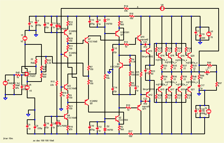

Ok I understand many of you guys don't really like opamps 🙂 If you are happy with a little more performance hit, here's an even further simplified bipolar version of the VSOP amp.
Take this as a proof of concept. Althought it's zumming on my bench right now, I have not fully characterized this and I do not have plans to build it as a final construction (case, etc...). It also needs a few extra additions, not figured in the attached schematic, see below.
There are a few important changes. First, this is a full current feedback implementation. Note the ultra simplified frequency compensation (L6, R253), works like a charm with an ULG of about 3MHz and a phase margin of about 70 degrees.
Also note of of Bob Cordell's versions of bias spreader. Works good from a DC perspective, bias is solid, however I find little advantage to the simpler NJL series diode string and current feedback driver, as in my previous post. In fact, from an AC perspective, it's a little worse (less phase margin and a little more distortions).
Distortions are around 0.009% at 20KHz, 400W output into 4ohm.
To have a fully working amp, this proof of concept needs a) an unity gain buffer at the input. As it is, the input impedance is 1Kohm, to small for practical purposes and b) a servo; as any current feedback construction, the offset is pretty large. None of this should be a problem for an experimented constructor...

I was about to give up on the BJT version (oscillation city) ,but
did not. your mosfet version sims very well.(first shot).
For my BJT version I "borrowed" some of roender's folded
techniques.
http://www.diyaudio.com/forums/attachment.php?s=&postid=1349109&stamp=1194852081
What I came up with is STABILITY
Thanks for inspiration.. I did add some current sources
to the diamond (psrr) and still have 100mv offset, but
on the plus side 50+db OLG and 1mhz UG. This sucker
is fast.. I retained at least 70+ v/us SW. Your advice to
trim offset and compensate input with a unity gain op-amp
seems to be the best way.
OS

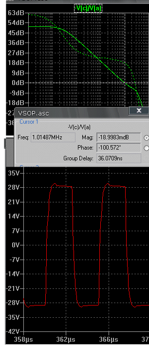

Very good work , syn... I did not mean to mess with your circuit too much but I don't have as much to work with (my KSA's /NJL's
and LT4).
I did get the 110v /uS slew (with roenders crude compensation)
at 22p (same as in your 2-pole). Only 1mhz (exactly) UG
and 53db OLG. (attached)
I feel bad using the crude compensation but like the current sources.
This is SO much better than a blameless as far as speed.
THD was a problem but I reduced that to .006% by "tinkering".

Increasing slew rate in a folded cascode is a simple matter of increasing the cascode current. High slew rate makes for some impressive oscilloscope pictures, but it doesn't really do much for the sound though.ostripper said:... I did get the 110v /uS slew (with roenders crude compensation)
at 22p (same as in your 2-pole)...
It is all a tradeoff , even with this amp. I will only get 70v/uS
with 27p Cdom's but no ringing and overshoot.
With the current sources I was able to use mpsa's ,ksa's ,
2sc's .. any device for input stage with VERY good stability.
Stability is more important than speed to me , so when I see
a design that can do BOTH , I'm impressed.
At the 110v slew , I saw that I also had a 70 degree phase margin which confirms the designers readings. I prefer 80+..
OS

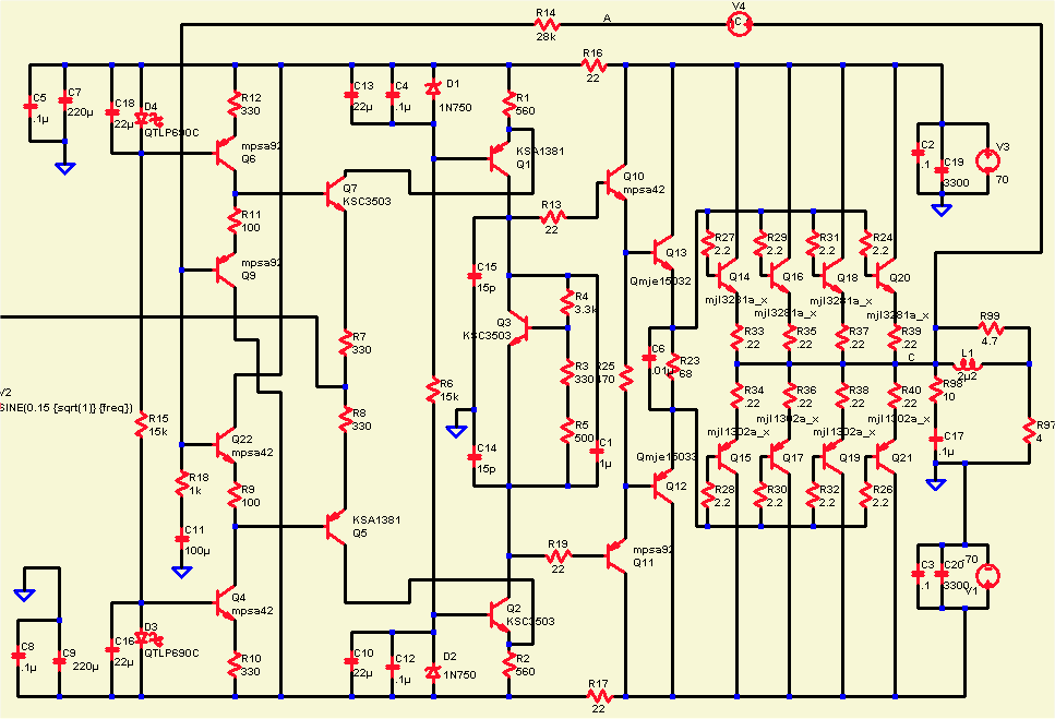

Unless there's anything outstanding, this one goes to the PCB manufacturing ASAP. Speak now, or forever hold your peace 🙂
Changes:
- No more dual pole compensation, look at the 22uH inductive compensation 🙂
- Added active clamps, no more sticking, overload recovery is clean as a baby. Worth two extra transistors and a few diodes (200V breakdown required!).
- LME49710 single opamp, this is the best cost/performance device and it comes in DIP8. Still no servo required, offset is under 5mV.
The experimental model shows THD20 under 10ppm (around 5ppm, actually) @360W into 4ohm, 120V/us slew rate, rise time defined by the input RF filter.
Still not decided about the bipolar version... Will decide after finishing the MOSFET boards. I really want to build a bipolar version with thermaltraks, but I can't decide for the best configuration. Unfortunately, simulations are pretty much useless here 🙁

By syn08 -I really want to build a bipolar version with thermaltraks, but I can't decide for the best configuration. Unfortunately, simulations are pretty much useless here
Do you mean Bjt simulations in general or just with the t-trak's ?

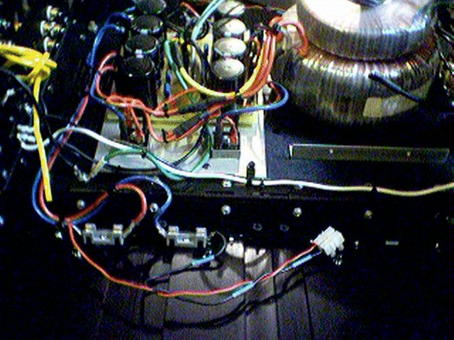

I am serious about building a VSOP, I even finished a nice
PS for some form of it (attached). +- 77v @ 30A's is too much
for what I have now.
Would I be in error to power the op-amp separately (2'nd
trafo w/ regulated +- 15v supply.
I really want to just have the VSOP on it's own board with
the IC's separate. Do you see any big issues with what
I previously posted ? I thought you abandoned this thread
so I just went solo with the bjt version. The refinement
I've done since the last post is to "split" the gain between
the IC and the VSOP. I am not looking for 10 PPM , just
stability and simplicity (I'm happy with 50ppm).
Unlike others, I am truely interested in this topology but
only have 20 NJW's (0281/0302) to do the OPS with.
OS
