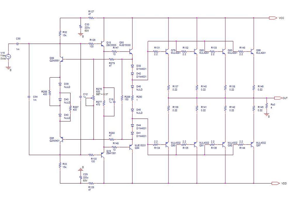

As a side note, I have tested the output stage in isolation (and optimized the bias). The open loop distortions of the output stage at 4ohm, 100W output and 20KHz is 0.05%. Don't you love matched power bipolars? I don't think it's possible to get such numbers using MOSFETs in the output stage. But about other bipolars pros and cons, later...

A couple of questions; What did you consider the output stage in isolation? Depending on where you break it out the source impedance of the stimulus matters more or less.
First Watt THD 🙂 ?

See attached. Source impedance is (in my measurements) always 50ohm. Optimal bias was of course around 26mV over the emitter resistors (about 110mA)
Don't have a clue about the First Watt THD 🙂

Now you have drawn it in isolation, I notice that it's the same type of Vbe multiplier that I first saw on Shinichi Kamijo's site (the one labelled "14").syn08 said:
