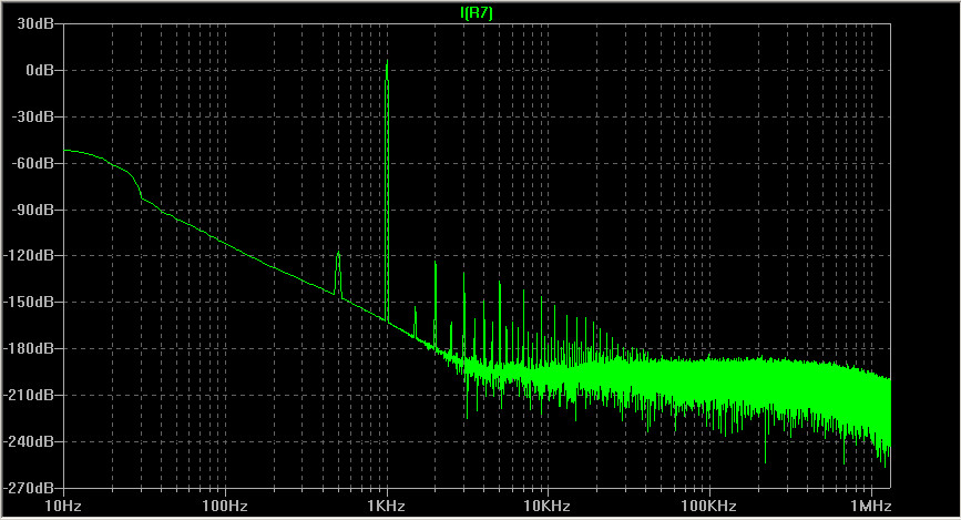

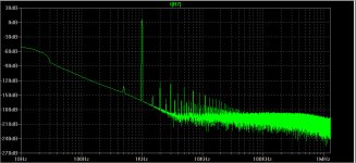

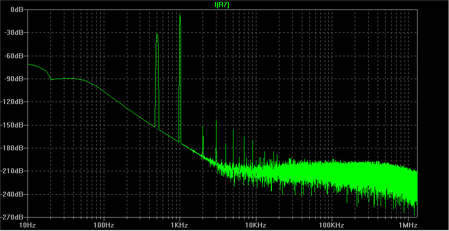

I had success, the amp is working stable now. 🙂
So I did several tests. An amp is loaded with a voltage source. The voltage source has a resistance of 10 ohms, a frequency of 500 Hz and an amplitude of 0.5V (resonance of a speaker at 500Hz).
Once the amp is driving as pure CFB(1),
as VFB(2)
and finally my idea, CFB-sensor(3)
As presenting the results is not worth a build. 😛
as VFB(2)
