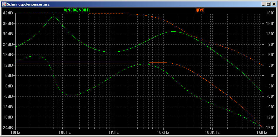

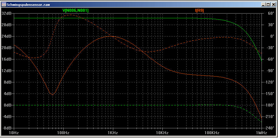

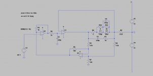

This simple circuit allows for control of the speaker cone. The power amplifier operates as a current amplifier. Without regulation caused the current amp a strong peak in the resonant frequency of the chassis. To avoid this, the voltage is measured at the voice coil and is compared with the input voltage. An opamp before the current amp corrects the frequency response. This applies not only to the resonant frequency but also for the whole band. As simple as it works you can't control the mid neither never mind the treble with an other technology.
The simulation works well so far.

Any difference is merely because one or other method is a poorer approximation to a true voltage drive. You can check this by inserting an impedance in series with a voltage source.
Basically, all your circuit does is remove the local feedback inherent in most output stages and entirely replace it with global feedback. Most people would regard this as a backward step, and strive to do the opposite.
True current drive is only possible with a loudspeaker which has been specially designed for this. That means heavy mechanical damping of the bass resonance, and either a full-range unit or series-connected crossover instead of the usual parallel-fed crossover.
All other attempts at current drive will either result in a huge bass resonance and very lumpy frequency response, or (like yours) are not really current drive at all but just disguised voltage drive.
I can't see what local Feedback do you mean 😕

Most amplifier (and opamp) output stages are some version of an emitter follower circuit. This has inherently high local negative feedback and so low output impedance. It approximates a voltage source. A much better approximation is obtained by adding global negative feedback too.

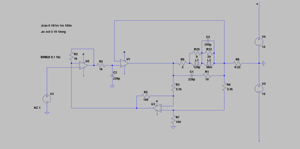

Thank you for your detailed execution. There are some points I have also read in the book 'current-driving of loudspeakers'. That will not mean, that I have understood all of it. But it was an interesting starting point for own thoughts.
How the hell your system will recognize which of the above mentioned voltages in the coil are the desired and undesired ones?
My consideration was to feedback the voltage over the voice coil with U3 to U1. U1 compares the two signals and corrected them.
