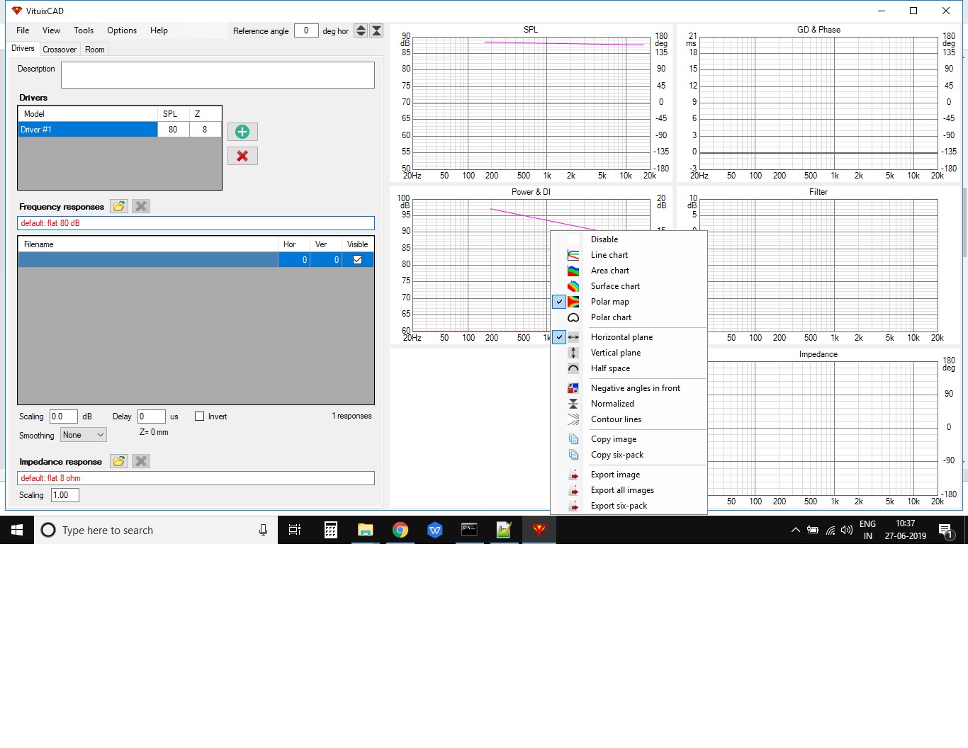

Can VirtuixCAD show directivity without driver measurements? Means just by simulation.
Diffraction tool is able to simulate ideal flat circular and rectangular radiators in closed or open baffle. Responses can be exported in horizontal and vertical planes. Long bevels are not supported.
Calculator tool is able to calculate off-axis response of ideal flat circular or rectangular radiator to single direction in horizontal or vertical plane.
If I open a new project and try to see the directivity, nothing happens, pls see attachment.
I am able to see directivity in the sample project Epe-3W_demo and I noticed several files in Epe-3W_demo\Far directory, are these files generated by tool (simulated VituixCAD output ) or should the user supply them by some other means (not simulated, VituixCAD input )?
If you just want to play around as a simulation without measurement files then you will at least need a frequency response of the driver from a datasheet.
Use the SPL Trace functionality from the tools menu create a frequency response file by capturing an image from the driver datasheet.
To obtain the directivity response use the Diffraction feature from the tools menu, create a box of your design along with the speaker driver diameter, open the half space response (your SPL trace), tick the Full Space option then feed the output to your selected driver.
Fully simulated responses can be generated with Enclosure and Diffraction tools. See this video: Creating off-axis responses with VituixCAD Diffraction tool

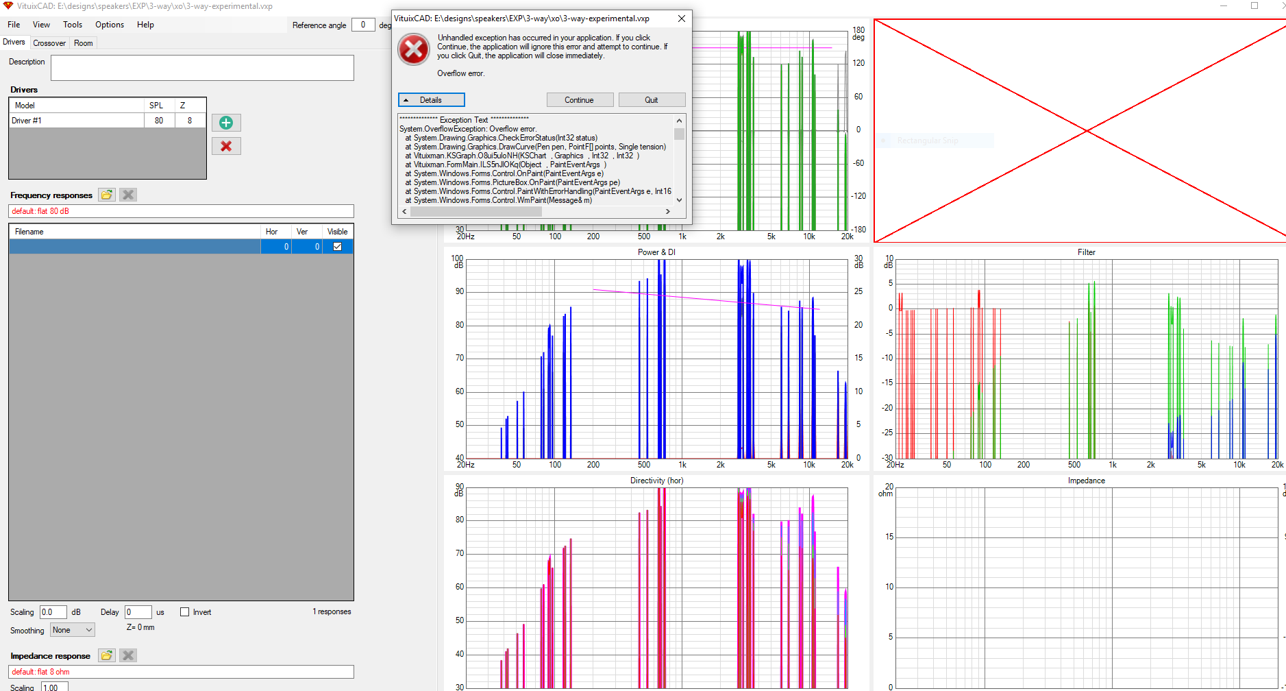

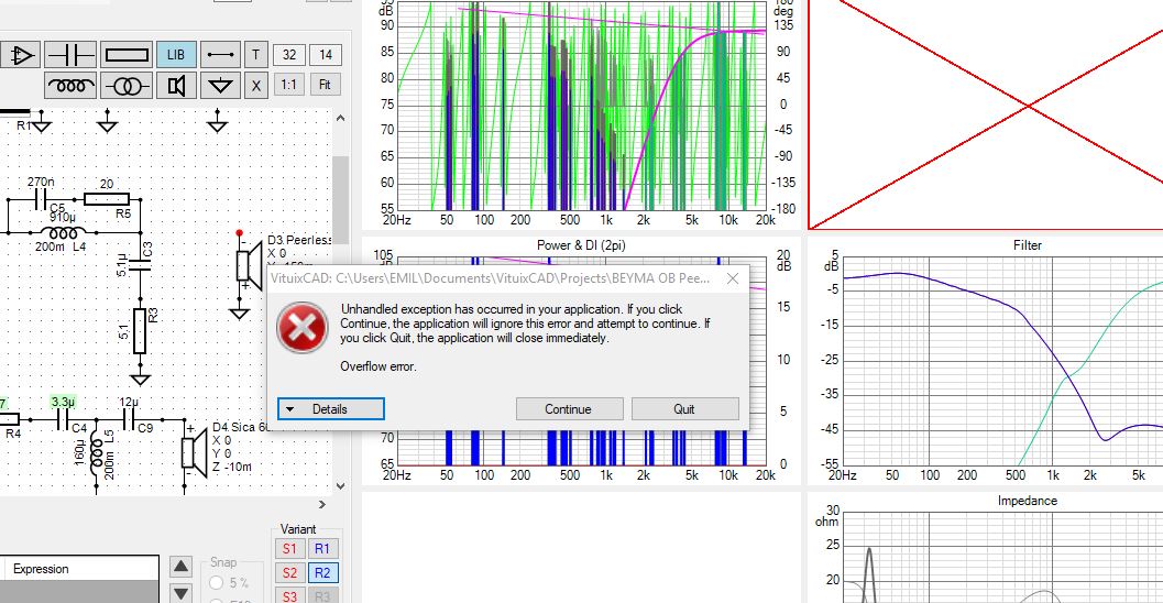

Got this exception just now. Am attaching a screenshot. There does not seem to be any way to enlarge the window to get a fuller set of lines, or is there any way to save these messages, so this is the best I could do.
I clicked "Continue" after this, so the application continued working. I saved the file and exited. Then I re-started the application and re-loaded the file, and I immediately got the same exception again. It probably means that the exception is being re-triggered by the data in the file.
I had loaded FRD and ZMA data of 3 drivers and defined a crossover, and was tweaking the crossover when this happened. To be precise, I was trying to add a parallel notch block to the crossover when this exception happened. At the same instant, all the graphs got messed up too, and the Y axis scales of all the graphs changed to infinitesimal values, like -150dB and so on.
I'm running the latest version of VituixCAD, because it keeps auto-updating itself. I'm running on Win10 with 8GB RAM, and as Kimmosto probably knows, I'm a happy user and have completed a few projects with it.
Should I just start all over again, add the same drivers and crossover and resume? Is there anything else I may do to help?

This is too close a correlation to be accidental, isn't it? Maybe Kimmosto can look at parallel notch entries in the library.Yes, this happened here also when adding a parallel notch from the library.
Rev. 2.0.18.9 (2019-07-06)
* Ignored overflow error if chart is drawn without valid data.
