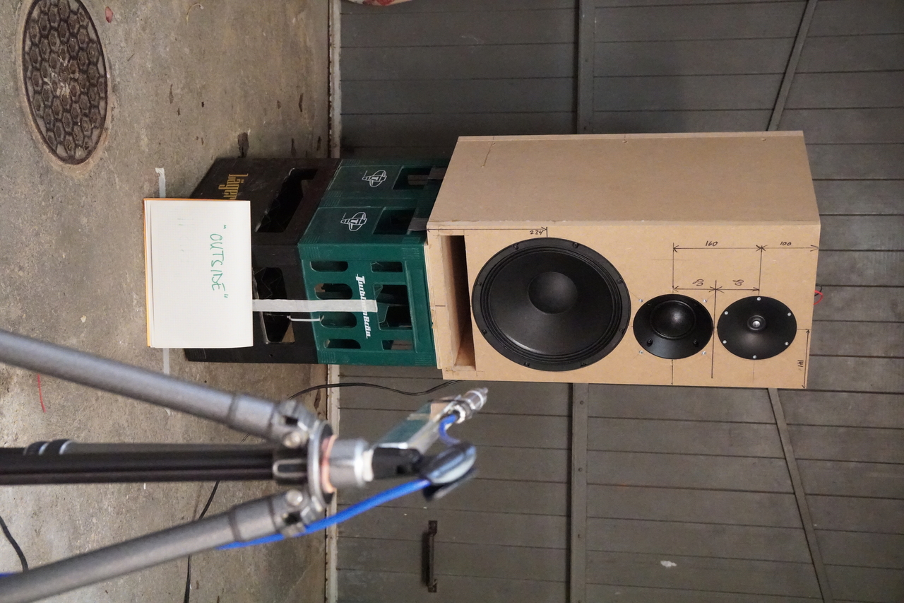

I am slowly getting into Vituix. Something I couldn't figure out until now is the direction (sign) of the horizontal (and vertical) angles. Please take a look at the attached photos ("inside" and "outside"). Which one would correspond to a positive horizontal angle in Vituix?
I need to get this right because the mid+tweeter are not centered on the baffle, and I'd like to use baffle diffraction calculator in Vituix to take a look at the asymmetric dispersion.
Left side is the minus side and accordance to your outside so right side is the plus side and accordance to your inside.
Below kimmosto link is a good read.
...Something about measurements is explained in Measurement preparation document only...
Outside.jpg has negative measurement/mic angle, and inside.jpg has positive.
From listener's view:
- mic/ear move right => more positive horizontal angle
- mic/ear move up => more positive vertical angle.
In other words, measurement angle changes towards more positive values when turntable is rotated clockwise (from top view) while mic position is constant.
I will add few images to measurement preparation document because short description in user manual for driver rotation does not explain this.
