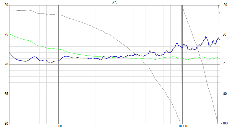

I particularly like the real time update of the frequency response while the cursors in the impulse response are being adjusted. This is great for seeing the effect of reflections in the impulse response and avoiding them.
I did have a strange issue where choosing FFT length 4096 or 8192 was causing a large shift in the signal level in the FR window relative to other FFT length choices, but after opening a few different files I'm not able to reproduce it again.
I did have a strange issue where choosing FFT length 4096 or 8192...
Most probable reason is that 4096 and 8192 were shorter than total length of time window. Manual adjustment of FFT length is possible after window adjustments are done but shortening of automatic selection has some risks.
Automatic selection is possible to lock, but that would prevent user to increase accuracy/resolution at low frequencies. Limiting of shortest possible FFT length would be more sophisticated and user friendly.
This is done to the latest build a minute ago.

Another thing I stumbled upon: I was looking for a quick and easy way to linearise my frequency response, so I loaded it into the calculator tool, mirrored it and then loaded the result as active filter via the transfer function file block. I expected to see a straight line as result, but got this:
Admittedly, this is quite a bit more linear than my initial response, yet not what I expected. Anything else (besides the obvious, manually setting filters) I can do to, well, basically normalize my responses?
first of all, big thanks to Kimmo for creating this nice piece of software! I like the ease of use and the visualization capabilities very much!
However, I have a few problems. Not sure if its my fault or if there are actual bugs in the software... I am only making active crossovers and corrections, and I measure using REW (again, ease of use). However, if I design filter settings in REW to linearise a driver and then recreate the same filters in VituixCAD I get quite different results (and yes, I already looked into the "Active PEQ response as analog RCL" setting). If I implement said filters generated in REW in my DSP-setup using EqualizerAPO, the response predicted by REW is practically spot on. I know that there are different approaches to implement PEQs etc. and that there is no standard. I'd greatly appreciate if there was a way to get VituixCAD to handle these things like REW/EqAPO does. I think there are quite a few people out there using these two tools.
Additionally, it would be really nice if VituixCAD could learn to read and edit the text exported filter settings of REW, which also work as config files for EqAPO. However, only makes sense if VituixCAD gets the same transfer function as REW/EqAPO from these settings.
I studied and tested EqualizerAPO a bit. It is able import frequency response of filter to graphic equalizer with variable band option. No problem to export driver's response from VituixCAD and import to EquAPO, though response file has close to 600 frequency points. Exact match is available if needed.
EqualizerAPO has common filter types with VituixCAD but those are not necessarily default/initial values. In addition, parameters of typical/standard shelving filters might be difficult to find because EquAPO has adjustable slope. HP/LP filters are single biquads (as in Hypex), which makes crossover design quite difficult and slow. Sample rate of dsp engine depends on settings of sound card which makes difficult to clone parameters back to VituixCAD.
I don't fully understand role of VituixCAD in this chain. If REW and EquAPO are good match, why to mix tools and transfer data back and forth. VituixCAD is for speaker design and those two look (just) room EQ applications.

I looked a bit further into the matter. Thanks for reminding me of proper methodology, should have got that one on my own. At 1kHz the PEQs of VituixCAD and REW/EqAPO behave quite precisely alike. The differences begin to show at higher frequencies, as REW models PEQs in a way, that gain at Nyquist frequency is always 0 dB, resulting in asymmetric bell shapes for higher frequencies. Now that I know I can live with this.
I never looked into that feature, thanks for the hint!I studied and tested EqualizerAPO a bit. It is able import frequency response of filter to graphic equalizer with variable band option. No problem to export driver's response from VituixCAD and import to EquAPO, though response file has close to 600 frequency points. Exact match is available if needed.
