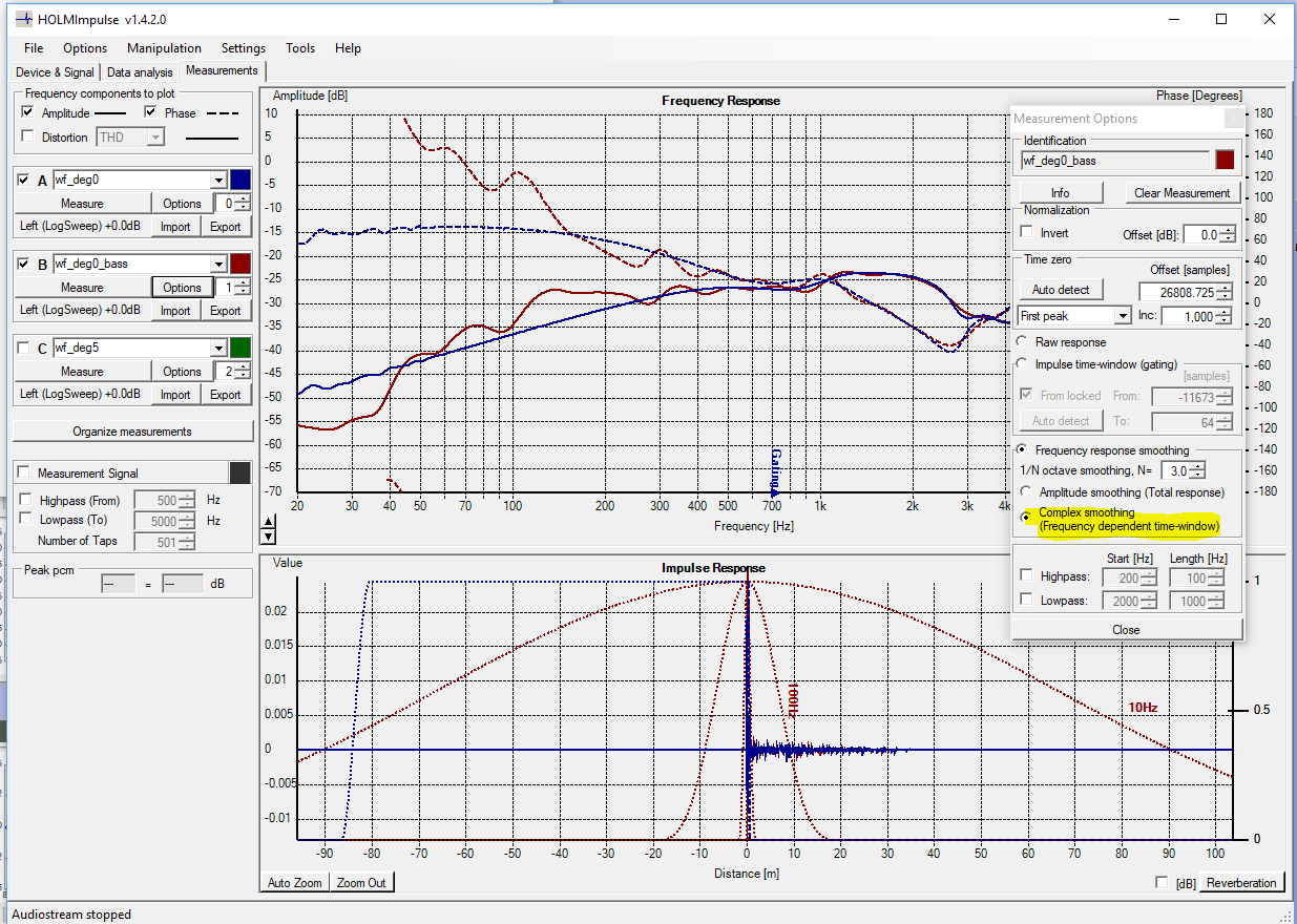

Remembered one more idea - Holm Impulse has this "Frequency dependent time window". I've found that quite useful sometimes, but Holm is not being maintained anymore and has some issues on Win10... So perhaps if you like the idea then that could make it to the feature list also 😉

ARTA also has a frequency dependent time window mode and while the perceptual basis behind it is sound I haven’t found it useful in practice.
This type of variable windowing is designed to try to emulate our perception of tonal balance in a reflective environment such as a living room in other words a room measurement taken at a normal far away listening position.
However we don’t use room measurements which include reflections when importing measurement data into a speaker sim - we are simulating only the speakers own reflection free response.
For this reason I don’t think this feature is useful or meaningful in the context of using the exported FRD’s in a Vituxicad project.

This could be useful in some cases. World is not black and white and sometimes stretching of time window to include some reflections is possible with the help large pillows or other damping material or with very directive radiators. This could also be one method to capture directivity information to lower freq than with constant window which could be helpful when measurement data is processed with multiple tools.
Variable length window or some IR low-pass before FFT are also in REW and LspLAB. Both have some side effects or implementation is not yet complete. For example minimum length limiter is needed to use this feature continuously.
Anyway, this feature will not be in rev 2.0.5. Maybe one day when I know how to do it...
