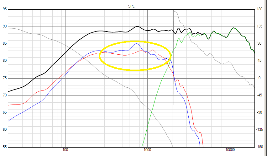

Small request (well maybe not). Would it be possible to mark two drivers as being a pair so that you could toggle between showing their individual or summed responses on the response graph? I find it a bit disconcerting when working on my MTM not being able to see the combined M's crossover response (which is what I'm used to as I've always measured them playing together modeled with a single driver, however now that I' doing the off axis as well, I really need to model both).
This is not so important because you can reduce level of driver's target curve by 6 dB (compared to total axial SPL), and use optimizer to design initial response shape for woofers. Then you finalize total axial and power responses which are using sum of woofers. Phase responses of individual woofers equals to sum response already.
Grouping of two woofers as a pair is possible but it should be measured from longer distance, and also in vertical plane for power response and DI simulation.

Hmmm maybe I didn't articulate very well 🙂 This was only for the on axis response display that I was thinking it would be helpful. mainly so you can see the slope of the woofers compared to the slope of the tweeter, as well as the overall summed response of both.
In the attached, I've put an oval around the two woofer curves, being able to toggle on and off so that shows as either two separate curves as it does now, or one combined curve was what I was thinking. It's just an aid in seeing how symetrical the rollof of the woofers are compared to the tweeter.

^Your articulation was perfect, but my explanation why I'd like to skip the mod was too indirect I guess 🙂 Version 1.1 has this feature because it has "ways". I'm quite certain that we are able to manage driver pairs and bigger groups without custom sum curves. Few reasons:
a) We can increase level by 6 dB temporarily in Drivers tab to check crossover frequency and shape compared to adjacent single drivers. That takes few seconds.
b) We should or at least could design shape of the slopes with the Optimizer. Target curve of single driver (of pair) is at -6 dB compared to sum -> no problem to evaluate simulated slope by comparing to ideal/text book response.
c) Total axial SPL and power response are tuned manually or automatically. Shape of individual slope will and should change if that produces better total result. Response of single driver or pair is not master with highest priority.
For example one of my latest designs; dipole with two 15" woofers. Somehow I did not miss sum response of woofers though I cannot say exactly what is lower crossover frequency without scaling temporarily by +6 dB.
Ah OK I understand now, just scale one or both of the drivers +6db and ignore the summed response to check the slopes 🙂
Tony.
Tony.
Yes. Not so easy and fast as sum response, but works. I know that sum is useful and automatic grouping is possible by driver ID (=row number in Drivers grid), but SPL graph is already quite mess if project includes e.g. 20 drivers. One solution would be selection: show sum of drivers or show individual drivers. That is "high end" what does not pay back.
