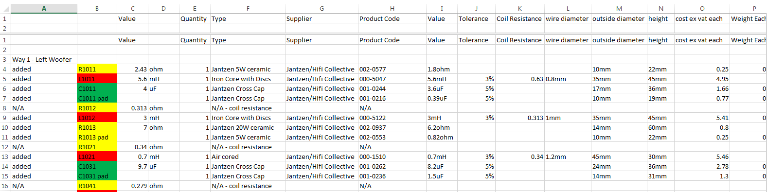

As another example of why part numbers are useful is I used the internally generated part numbers (from V1) to reference parts so that I could create a spreadsheet of the precise parts I was going to order, including additional information like manufacturer name and part number, resistor wattage, series resistance of coils, physical dimensions of coils, weight of coils/capacitors, cost etc. See screenshot for a small snippet of that spreadsheet.
The part numbers give me an unambiguous reference between the schematic and my spreadsheet entries. Without part numbers on the schematic I would have just printed it out and written them on by hand anyway.
It seems silly to still have a parts list function that lists part number against component value, but not also be able to print or display a schematic with part numbers to go along with the list, especially when V1 could do it.

Thanks! Have you checked Parts list view of version 2. Few columns more and you have complete shopping list with part numbers 😉
