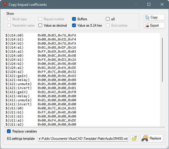

Filter parameters are transferred from VituixCAD to almost every DSP app/gear manually. Raw coefficient export->import to for example miniDSP is not the best option for normal filter stages because you cannot tune parameters anymore in miniDSP. Raw coefficients a0...b2 are impossible to understand and control by human being so everything should be done primarily with parameters such as f, Q and A.
This is not good news for sure but usually there is no other way. DSP manufactures seem to think that speakers are designed by loading on-axis responses to their own filter design program and then adding filter blocks until total response is flat. That could work sometimes, but simulator may see some problems and find better compromise especially if directivity is not optimal.
Unfortunately not. Just Hypex or some PhD in digital signal processing can help with that. In addition, I'm not interested to solve this puzzle. Responses of digital filter blocks don't have to be exactly equal to ideal analog equivalent so all mathematical complexity with elimination of frequency warping is just academic nonsense. Most of the manufacturers are fully okay with basic calculation formulas, and it's enough for designer that he knows what response is produced with given parameters. Hypex to inform me/us or otherwise they won't be supported by VituixCAD.Kimmo, would it perhaps be possible to load up a set of test coefficients, measure the resultant reponse, then figure out the applied method from that?
Of course you can try to engourage Hypex to write and publish document how coefficients a0...b2 are calculated from filter parameters. I asked many years ago. Document did not exist so it was not possible to send to me or publish. It did not sound high quality operation, though perfect match with reliability of their products at that time.
Only mechanism (in addition to advanced window in miniDSP apps) allowing at least semi-automatic DSP configuration is 'Replace variables' feature in 'Copy biquad coefficients' window. If DSP programming file is text file containing biquad coefficients, this feature can replace javascript-style variables in template with coefficients values.
This example is for Platin SM450 streaming amp. Separate app is needed to transfer text file to DSP device so this is not just quick and easy loading. 10x faster that manual though.

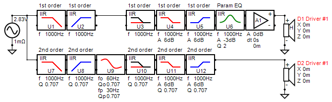

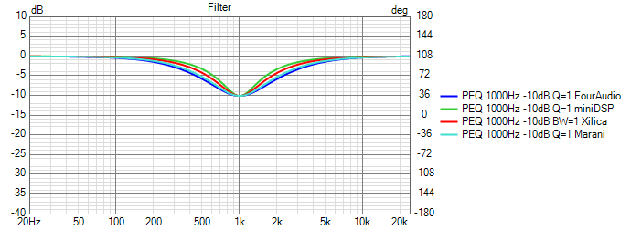

You don't have to ask anything if you can take screenshot from transfer function of each filter type available for manual EQ, with two different Q value and two different gain. For example:Hi @kimmosto,
Linn dsp called Exakt Design and have used the ‘generic’ setting in VCad with ok:ish results but not as precise
1) Parametric EQ 1000 Hz, Q=1.0, A=+10 dB and Q=2.0, A=-5.0 dB.
2) 1st order Shelving low pass 200 Hz, A=+10 dB and A=-5 dB.
3) 2nd order Shelving low pass 200 Hz, A=+10 dB Q=0.71 and A=-5 dB, Q=1.0.
4) Bessel low pass filter, 1000 Hz, 18 dB/oct.
Usually these four are adequate to identify parameter policy/philosophy of the manufacturer and select equivalent brand from DSP system list.
Lake is lost case because they don't respect standard transfer functions i.e. filter responses don't even try to be like produced with linear circuits. Every filter type has some own pervert curve invented in Sweden. That brand will never be emulated/supported by VituixCAD.I also use LabGruppen amps with Lake dsp and have the same questions there.
Simply said: transfer functions and coefficient calculation should be compatible with this spec. to be supported by VituixCAD.
https://www.w3.org/TR/audio-eq-cookbook/
This is basic biquad math supported probably more than 95% of dsp gear/app. manufactures. The others will be thrown from the boat in cold blood.

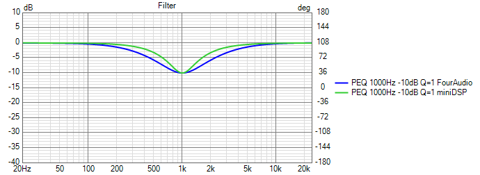

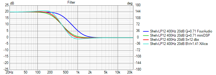

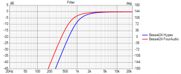

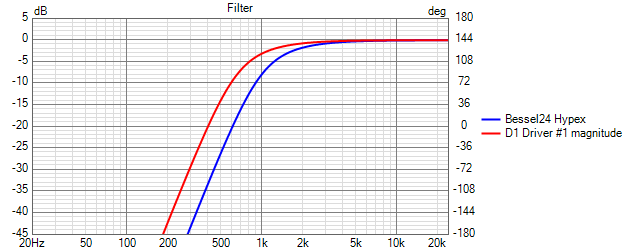

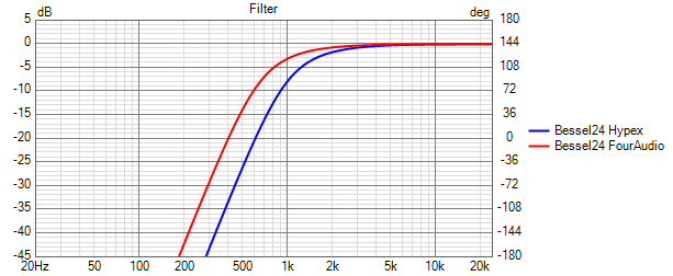

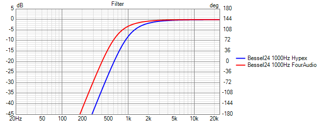

Bessel HP/LP filters have manufacturer-dependent frequency spec. Typically two different.For example, a highpass with a certain Q and Fs is always the same?

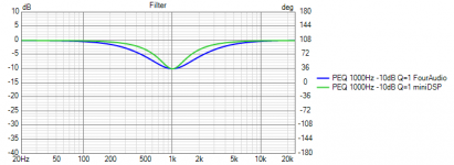

Q or BW of parametric EQ is manufacturer-dependent. At least four different types.The same goes for a parametric Eq.
Frequency and Q or BW or S of Shelving LP/HP are manufacturer-dependent.The only discrepancy some manufacturers do differently are shelving filters.
That absolutely blows my mind!Bessel HP/LP filters have manufacturer-dependent frequency spec. Typically two different.
