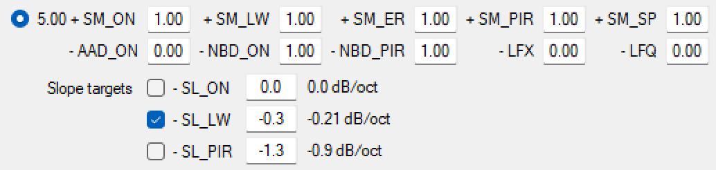

If you don't fully comprehend the settings in Preference Ratings, are you insinuating to just leave it on the default settings (in v 2.0.88.4)?
i.e. don't use equation 9 or 10?
Is there any way (a link?) to learn/understand the Preference Ratings settings?
I understand the meaning of the acronyms, but am totally lost with the significance of each, and how to alter the settings.
As a newbie, would it be best to just leave them on your default settings?
Very difficult to give exact instructions due to wide variety of possible speaker concepts, listening environments and positioning, but here are few simple tips:
1. Do not optimize crossover or anything else in construction with equation 9 and 10. Use custom equation instead.
2. Decent weighting factors to start with:
This is quite universal and flexible for both near field monitors and longer listening distances, but not necessarily the best for all cases.
3. Increase weight of SM_PIR to 2 if typical listening distance is longer than near field.
4. Increase weight of SM_ON to 2 if listening distance is near field only.
5. Do not check SL_ON and weight too much SM_ON and NBD_ON if any of the drivers has bad on-axis response while LW and PIR are possible to get smooth. For example typical coaxial drivers (hifi and PA) have too bad on-axis for any optimizing with it. Keep SL_LW or SL_PIR or both checked, drop SM_ON and NBD_ON to half...zero to optimize smoothness with SM_LW, SM_ER and SM_SP alone. PIR contains LW 22%, ER 44% and SP 44% so you can increase weight of all three by increasing SM_PIR alone for example to 2...3.
6. Some concepts in some environments and with positioning may sound too bright and harsh with flat horizontal on-axis. For example speakers with strong directivity or line arrays at long distance. You can improve sound balance by optimizing LW slope=-0.5...-0.7... or PIR slope -1.5...-1.7...; making sure that on-axis tilts down enough.
7. Keep LFX and LFQ unchecked or set factors to zero or check 'With sub'. LF response cannot be optimized with typical passive XO, and active XO is best to optimize manually. LFX and LFQ and not very smart for optimizing.
After optimizing it's easy to peek PR also with equation 9, and test how result changes when some XO components or parameters are changed. Typically result gets worse right away.
